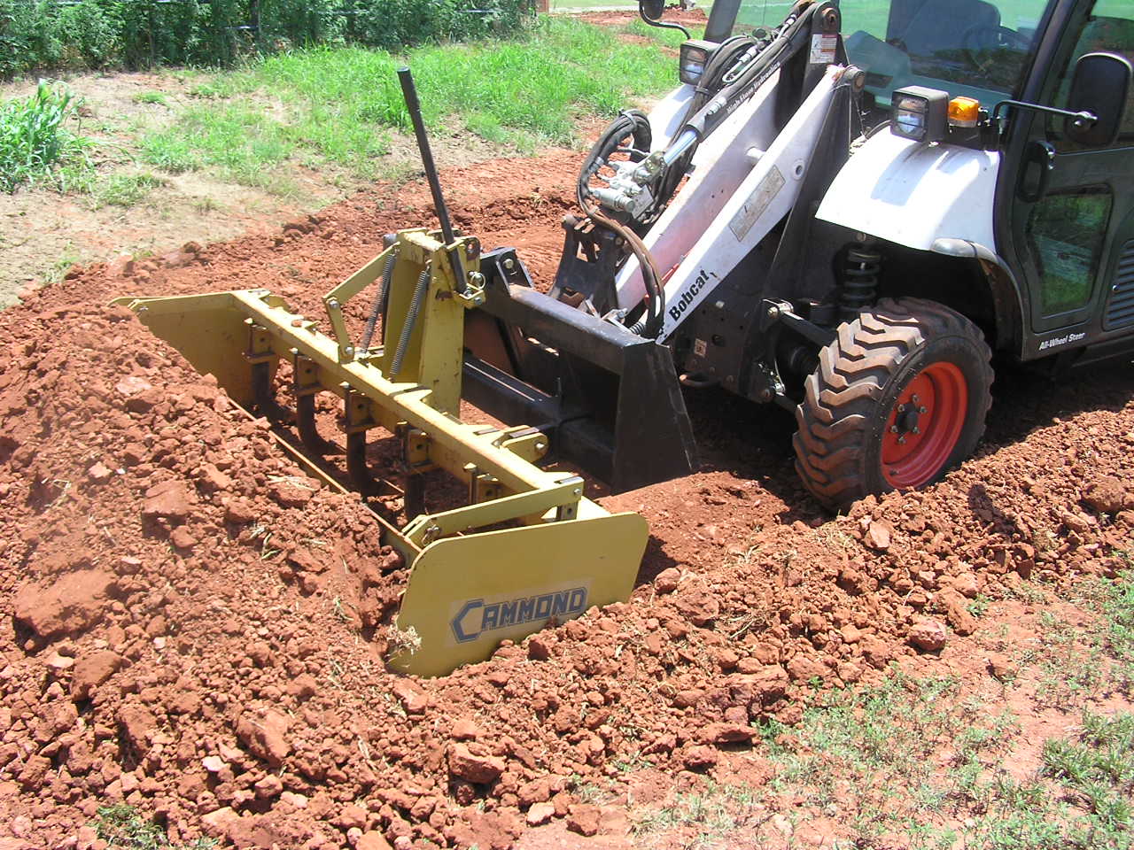

What kind of implement? You say angle it & box blade. You don't angle a box blade but you do a back blade.
I can angle my box blade. :D
It is a 6' on a 5' wide machine.
Pulling straight.
Dozer mode.

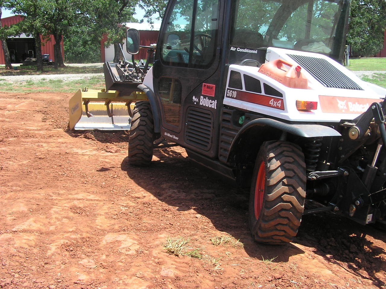

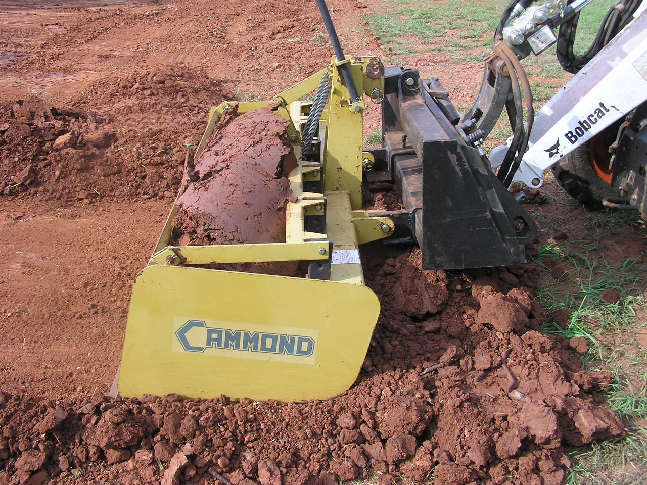

That's tilt, not angle, at least not from what I can see. No different than the top & tilt cylinders you can install on any 3pt.
Braggart... I want one of those mini telehandlers. :p
   / how big of a box blade should I get? #18

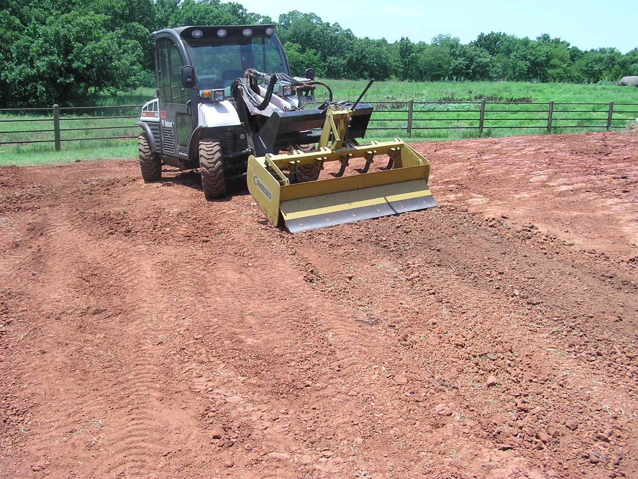

It is also angled, look at the rear axle, the Toolcat is in crab steer, the box blade is at an angle to the direction of travel.
Not to useful, just did it to see what would happen. :laughing:
   / how big of a box blade should I get? #19
Now you're really just showing off! :laughing:
