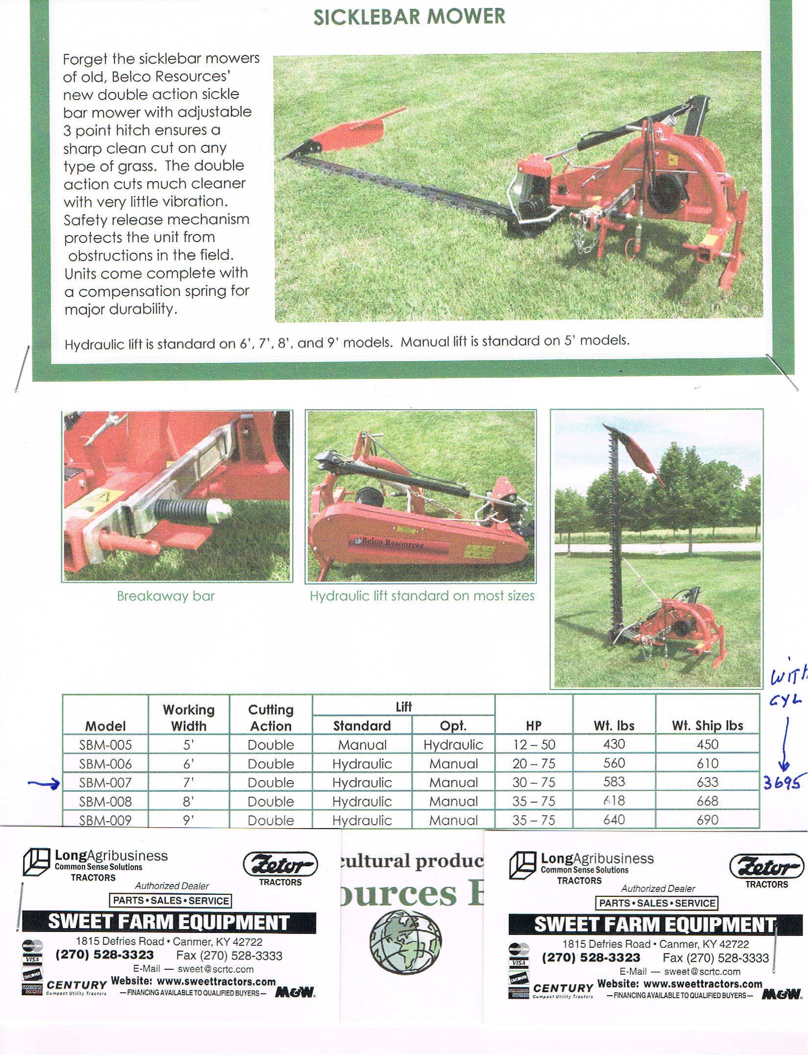

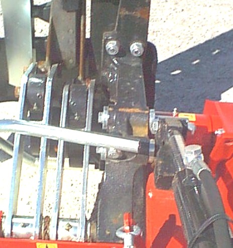

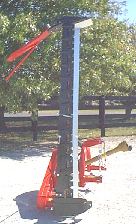

A 45 hp tractor can turn a 9 ft, however, the Mfgr. specs are looking more at the weight and "Stance" of the tractor for safety's sake. We have in stock the new Enorossi 7 ft double action sickle mowers with hydraulic lift kit for $3695. My Shop Foreman has a disc mower and one of these double action mowers and the double action will make a round every time the disc mower does. Damp hay don't matter. Ken Sweet
