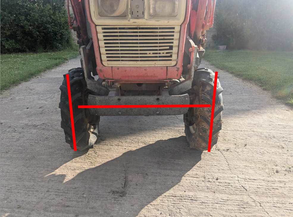

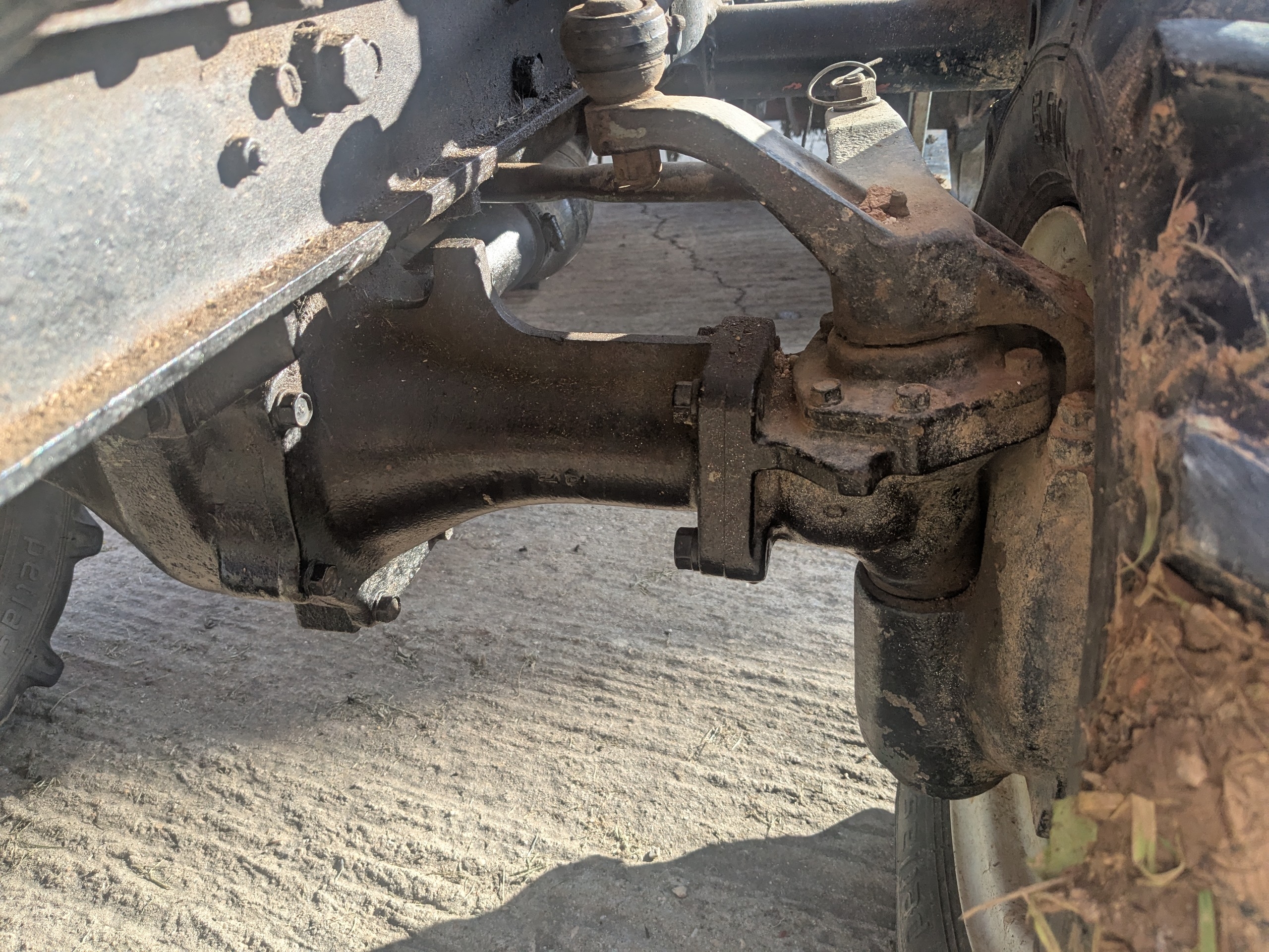

Hello, I'm having this toe-in problem with the front axle wheels of my Yanmar 1610DT.
It's causing the tires to wear incorrectly, as shown in the image.

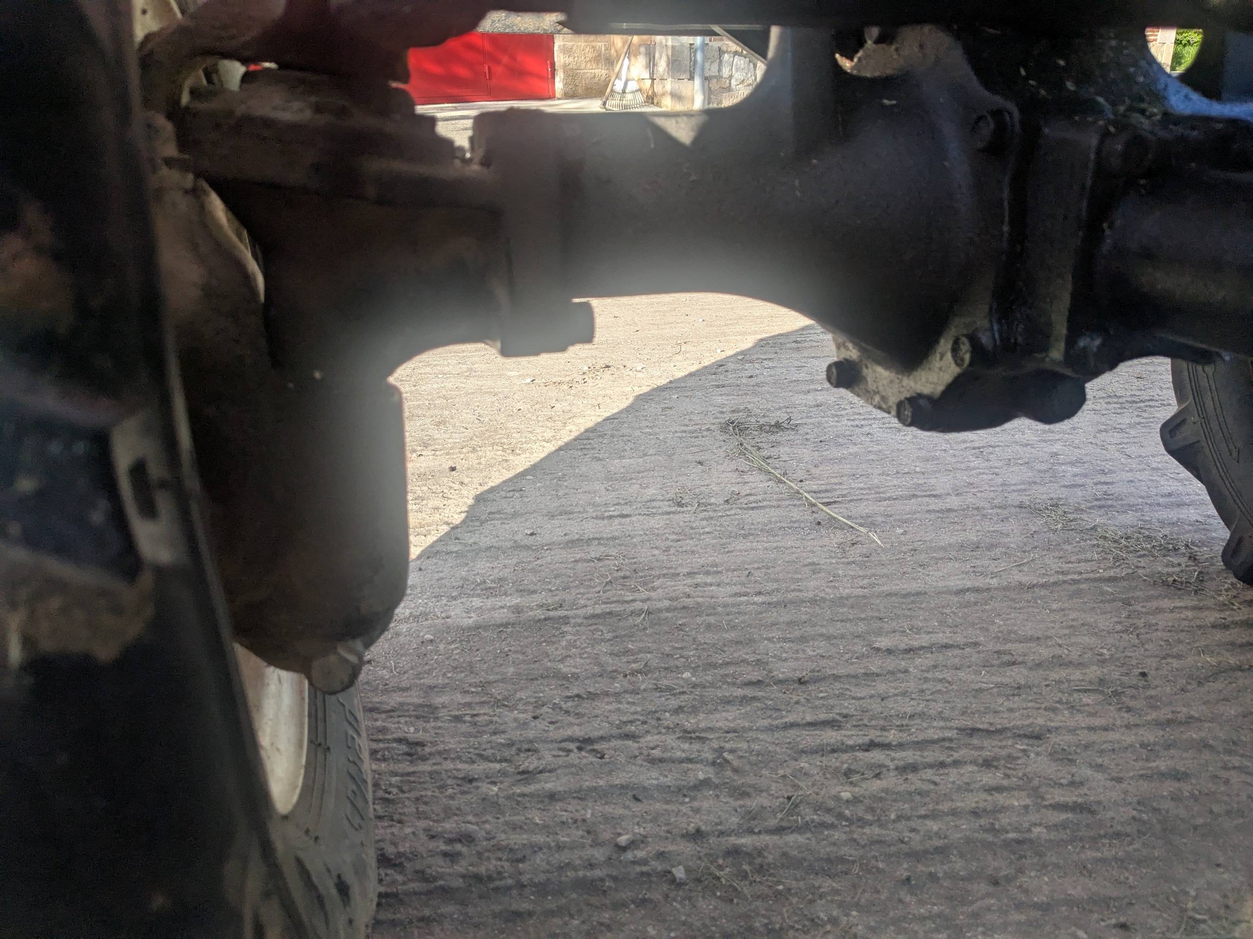

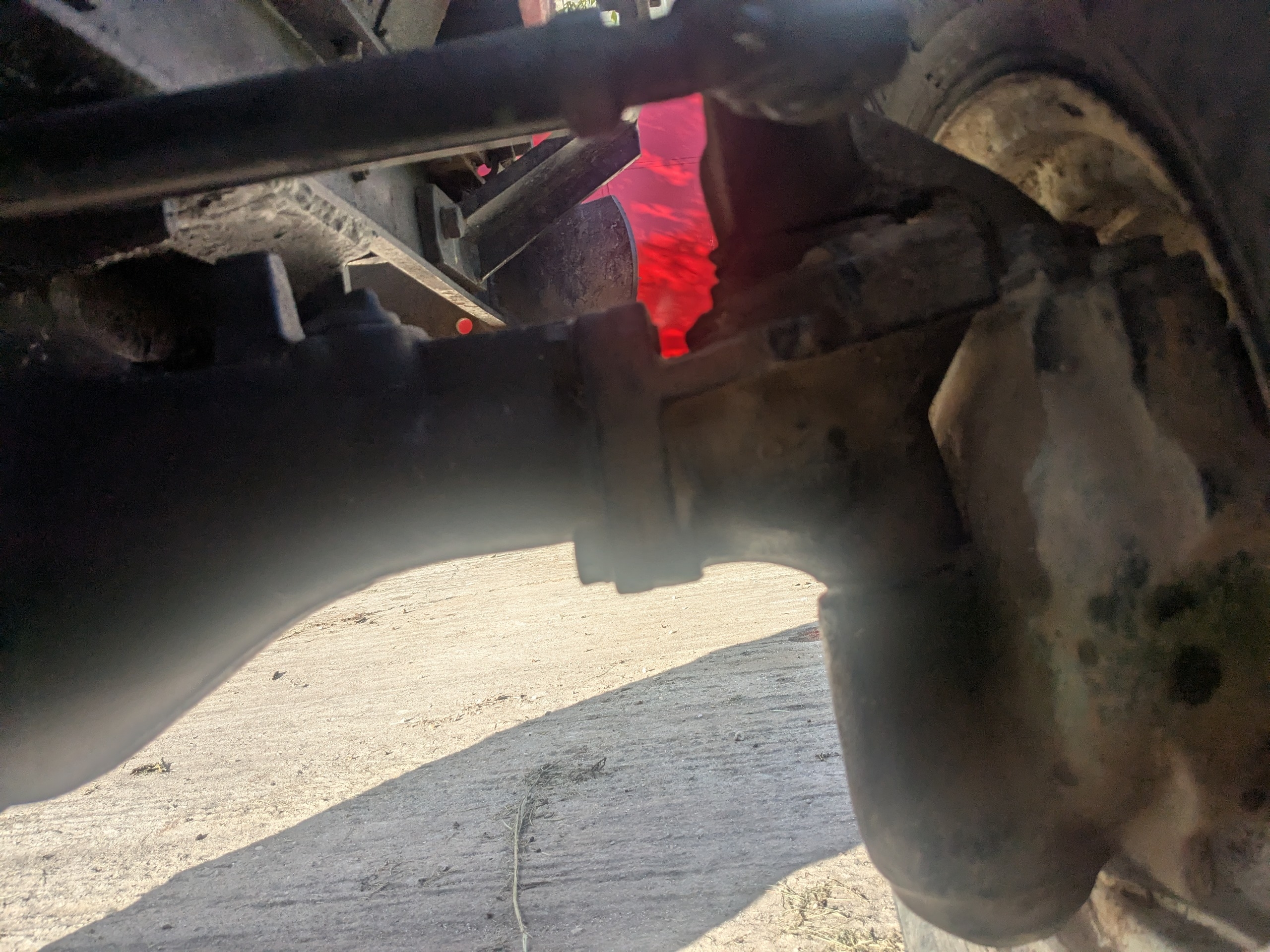

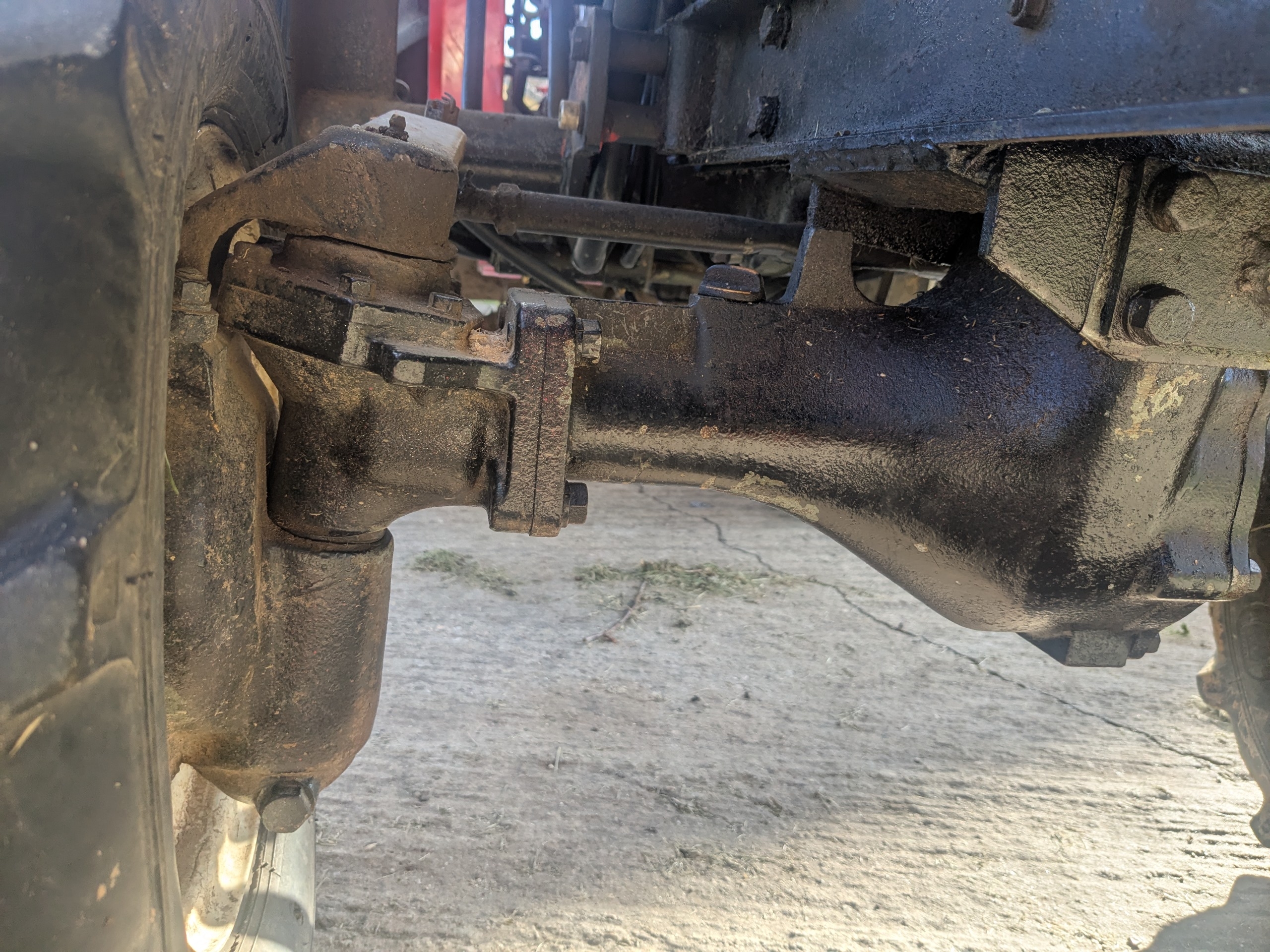

I've also attached photos of the front axle bolts, which I assume may be able to correct this toe-in.
Thanks for the help!

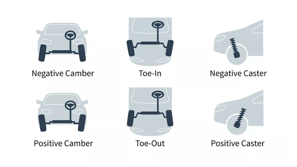

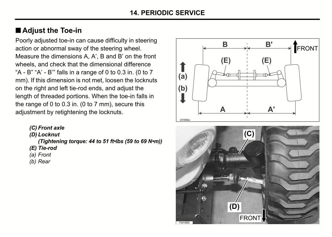

Just for reference:
To correct the toe-in/toe-out, you adjust the tie road which is that round bar connecting one wheel to the other.
If you're referring to camber, which I believe you do giving the angle of the pictures, tractors are built that way and aren't adjustable, so turns better in tight turns and get better turning radius.

Okay, so this camber isn't adjustable in Yanmar 1610DT @ptsg?
My tire wears very unevenly.
   / How can I correct this toe-in of the front axle wheels on my Yanmar 1610DT? #4
Not adjustable on any tractor with a rigid front axle as far as I'm aware.
You may want to check toe in and toe out as that it's what usually wears out tires. Manuals usually call for around 4 to 8 mm of toe in.
