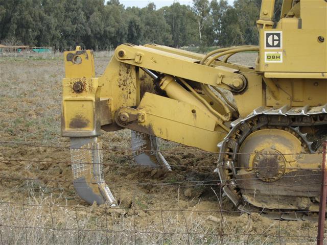

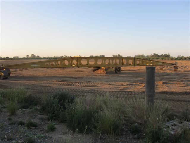

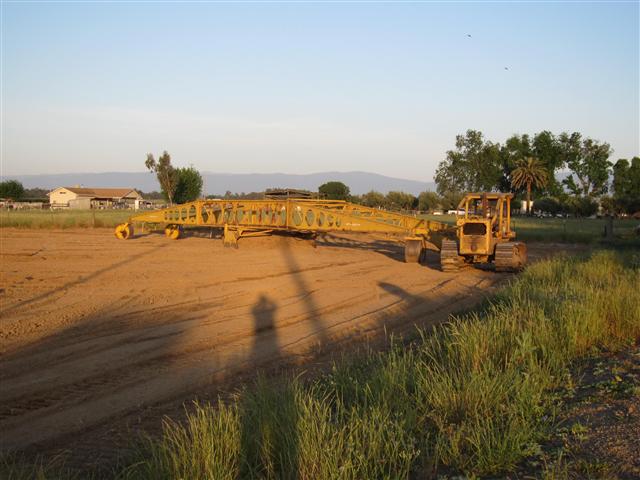

Around here in the North Sacramento Valley we have tens of thousands of acres of orchard (almonds, olives, pistachio, English walnut). Old orchards are continually being taken out by large equipment that pull the trees out of the ground roots and all, leaving big holes to fill in. Generally, field is ripped by D9 Cats
disced and then leveled using large land planes. My neighbor is using this large plane to level one of his 10 acre irrigated alfalfa fields.
Good luck.

Never seen a land plane work. That is one cool piece of equipment. However, hiring a dozer and the land plane as well would make it cost prohibitive. Still trying to figure out how to do it with my own equipment. Put the grandkids on the tractor and get some use out of them (these are 25 year old grandkids). I think I'll try the plow/disc/harrow method, going crosswise first and then up and down, and see how it goes. I have seen the chain link fence drag work, but only for land that needs to be smoothed out, not for filling holes and leveling. Never tried dragging an ibeam, but that has some possibilities as well. Thanks for the pictures.

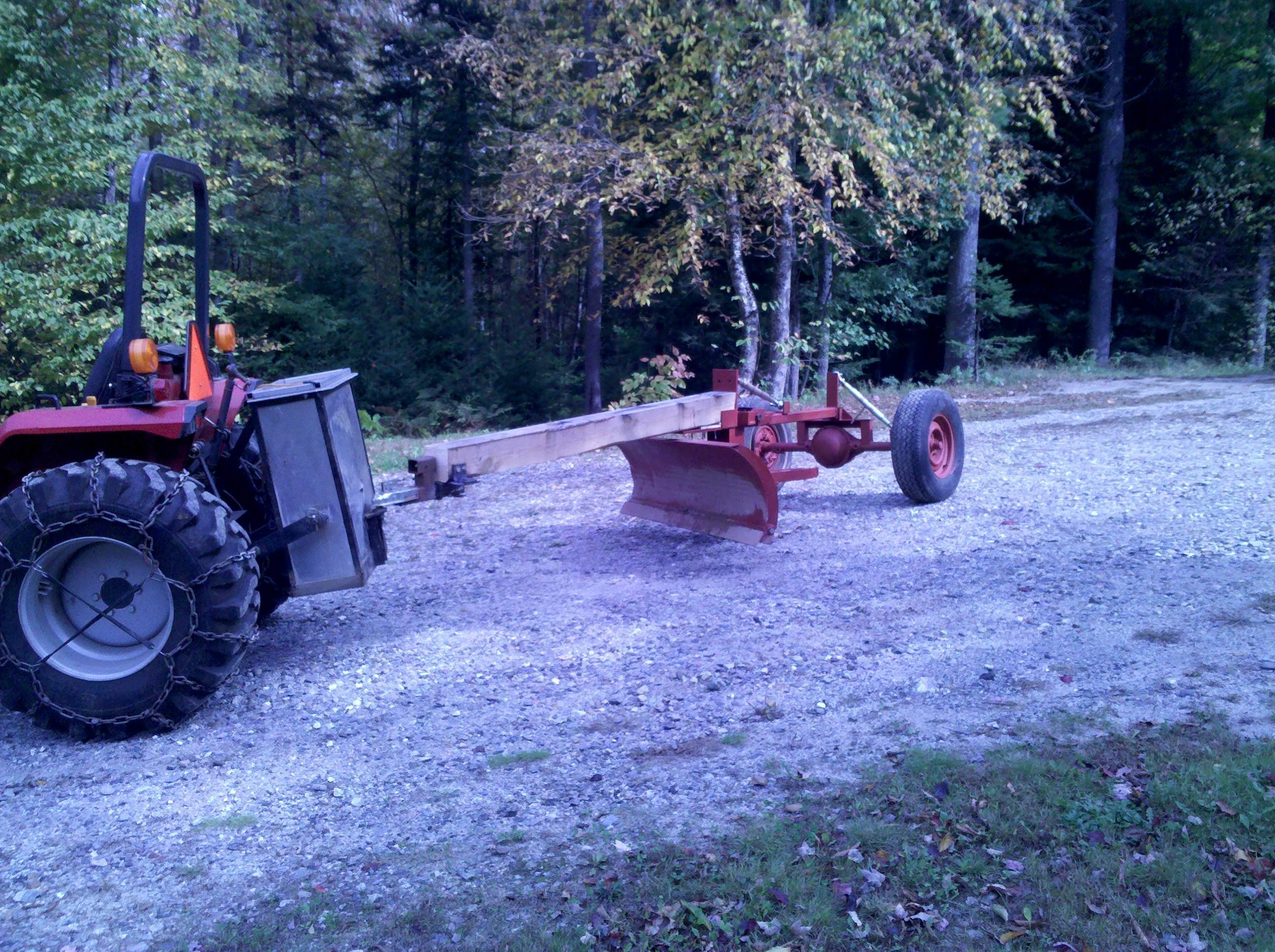

what flusher and bcp are noting in pictures. is much like a "motor grader" as in the actual machine. you might have seen on some old gravel roads. but instead of being a dedicated machine, you are seeing a 3pt hitch type of doing in the pictures they posted.
and for most part work much like a rear blade or a box blade. but they tend to have much further distances between the blade itself and tires in front and behind the blade. and most likely also have extra hydraulics to adjust the blade in multi directions.
the longer distances between blade and the wheels behind it and in front of the blade. = less hassles of trying to deal with little hills and valleys that can happen. when operating say a rear blade or box blade. over long distances, like in a field.
View attachment 282877View attachment 282878
Good luck.
That is how we do every year behind watered crops.Except we use tractors instead of dozers. Down in the delta we water soybeans,corn and cotton down the middles. Rice we water by flooding lands. That is a older version of land planes. Those do a really good job. They are nothing like a road grader, the dirt goes back and forth down the blades and is discharged off to the side. If you drag one down the road,they will level it, but displace your gravel on the side of the road causing the road to get lower,because you moved the gravel off to the side. In the field you come back around and pick up you bead of dirt on the next pass and roll it over down the blades,effectively filling in holes and ruts as you go. The field is always disced or a scratcher is pulled over before the land planes. LUTT
