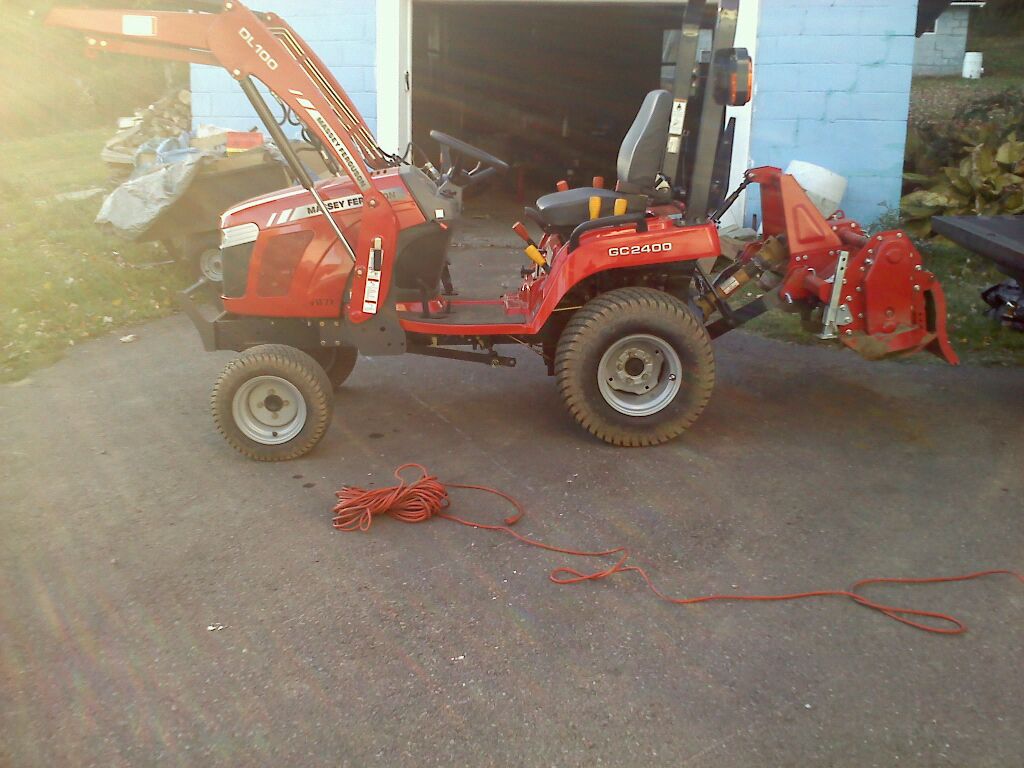

With these BX's with limited CAT 1, there seems to be a few reasons why it would bind. One is not following the instructions to cut the PTO shaft shorter to correct length. Or like my rototiller, when its up all the way, the u joints would clatter due to extreme angle making it sounds like its binding. I solved that with a quick hitch as it moves the pto shaft further away from rear of tractor lessening the angle so it doesnt clatter anymore.
If the pto shaft is of correct length, and OP doesnt want a quick hitch, the only 2 options I see is to replace the lift arms to a longer one or drill new holes so its closer to rear of tractor, but it will seriously limit the lift clearance. Being a snowblower it might be all he needs.

My tiller does the same thing. I've learned to watch how far I lift it when the tiller is running.
Here's a picture of the angle that causes problems:
Shortening the top link will stop the binding/clattering, but when the implement is lowered it's not at the correct working angle.

none of this will work because he doesn't have "position control" that moves the 3pt to match lever position. He has a "quarter inching valve" which works like the loader valve, you pull the lever back and the 3pt goes up. but when you release the lever it springs back to neutral.
about the only way I can think to limit up travel is to connect chains from the tractor frame side of the lower links to the snowblower side of the top link or some variation of this.
The chains idea gets my vote. Cheap, elegant, applies only to the attachment that needs it.

Is there any danger of damage to the tractor by doing this? Will it just go into relief and open the bypass valve? Will the lever return to neutral then? I'd just be scared that it would keep the bypass open full time causing more wear on the pump and the relief valve itself.
