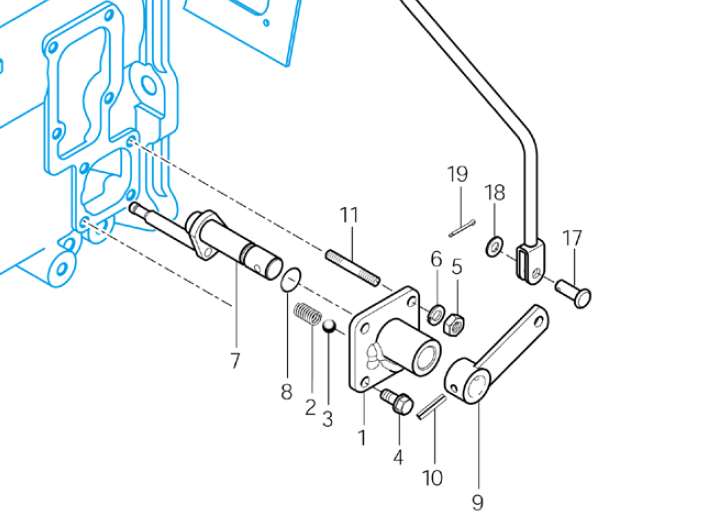

I would not try and pull the shaft out of the housing until I fully understood how the shaft attaches to the lever or eccentric inside. The shaft shown in the parts schematic appears to have a grove in the housing end which could have a snap ring securing it. Look at the schematic for the parts inside the housing to see what is shown there. A service manual is a must in this situation IMHO!
If you do get the housing off, how are you going to capture the spring and detent ball? Best case they could just fall out on the floor, worst case they could fly into the housing. Now you're going fishing in the gear case for loose parts!

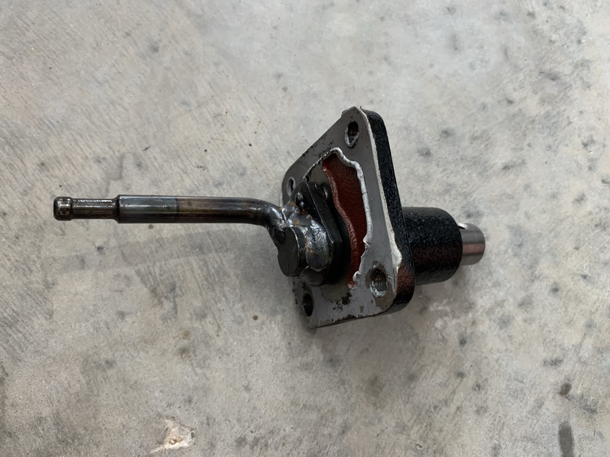

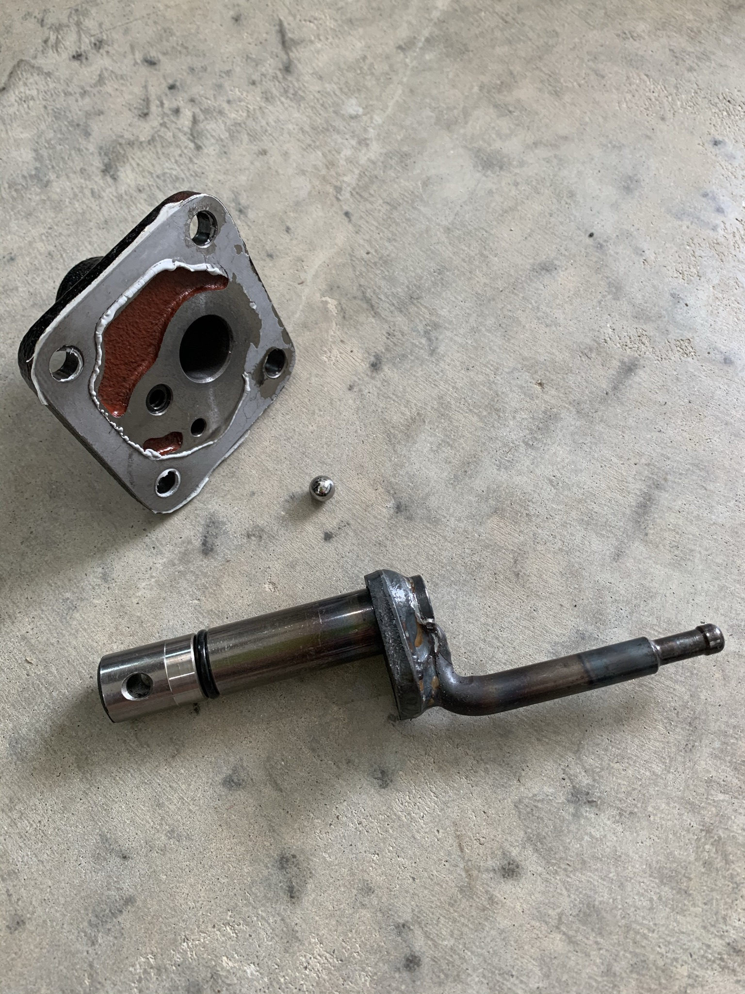

Success. I went with a square razor blade and slowly tapped it into the bottom edge. After a few good taps, and one broken blade, it finally gave way. The shaft and housing come out as one piece, as shown in the pics below. Last pic shows the o-ring I'm replacing.
Thx for all the suggestions everyone!

It looks like the parts drawing has the ball and spring in the wrong order. I had wondered how that would work.

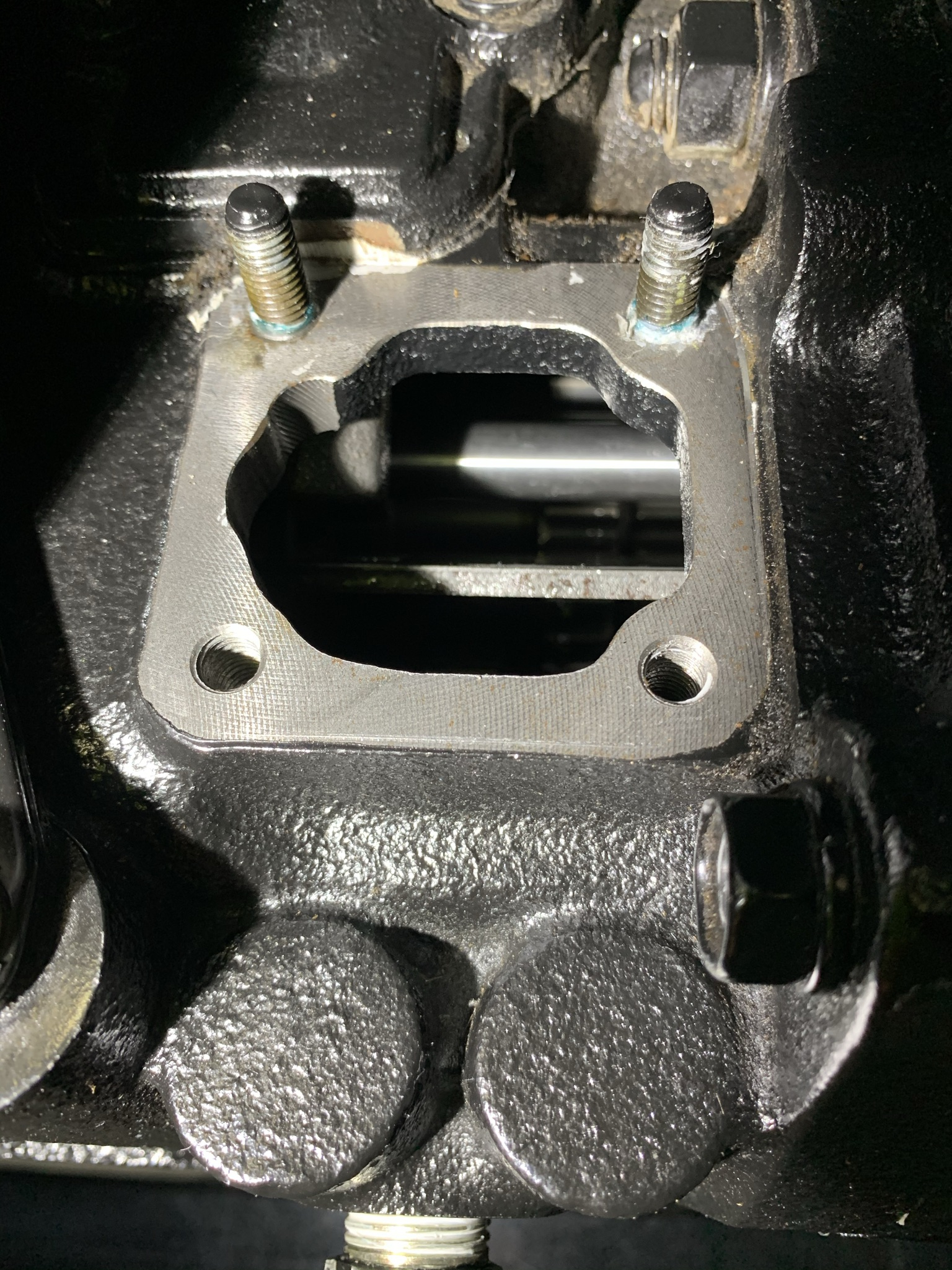

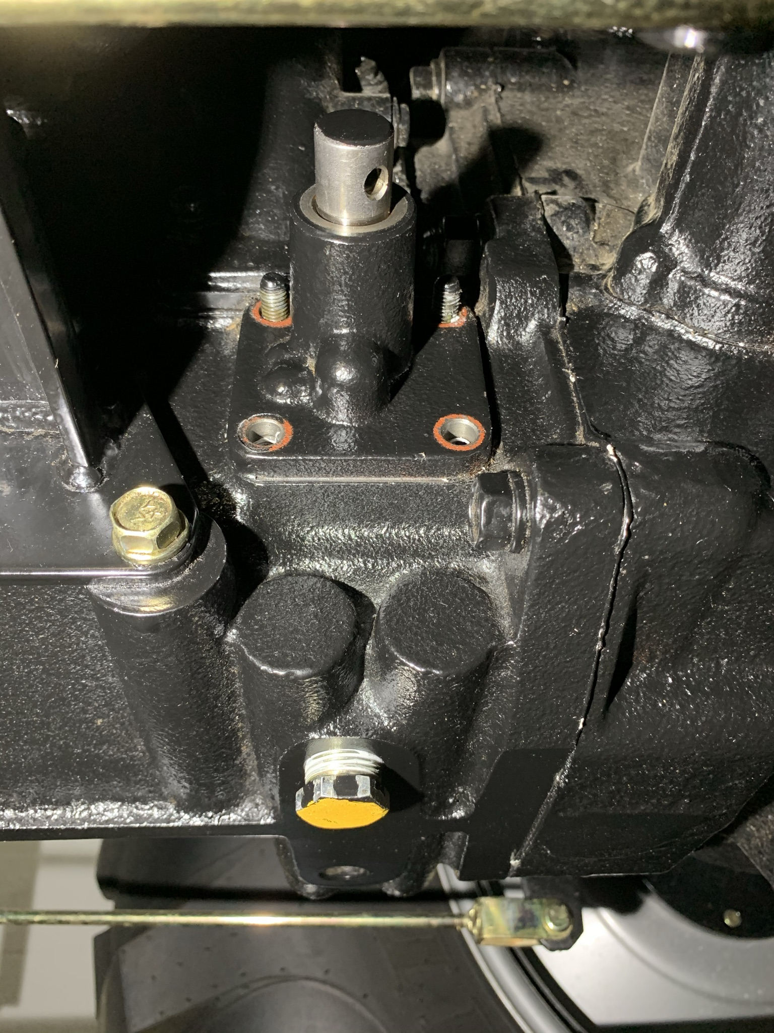

I need to take the housing off this shaft because the o-ring that keeps the shaft from leaking isn't doing its job.
Gasket maker appears to be firmly holding the housing to the transmission. I've tried some whacks with a rubber mallet with no success. Maybe try a dead blow to kind of shock the housing loose?
Trouble is, with the shaft and two upper studs, the housing is pretty well captured with limited degrees of movement so I'm not sure that additional hammer blows will do any good.
