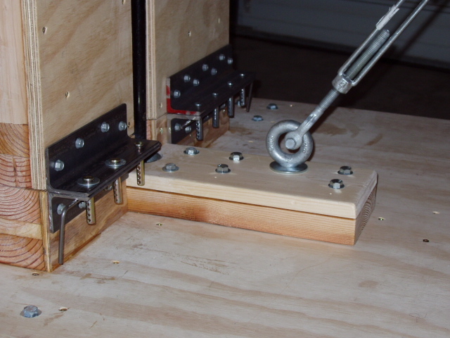

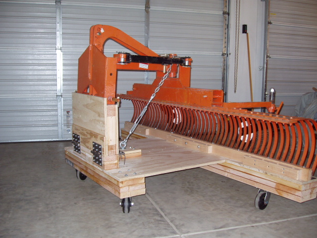

What might be intimidating to you is that unlike most other attachments, the two lower 3-pt pins are set so high on the York rake. Measure your tractor's lower arm height in the full up position and then measure the York's lower pin height to check for attachment compatability and adjust if necessary. You don't want the tractor's lower arms to be in the full up position for leeway purposes when attaching. My 8' York rake has a built in 3/4" solid stowing rod at the neck so that should be all you need or perhaps a block of wood under the foot if you stow it in dirt. When I bought it used, the rod was handed to me in such a bent condition I had to heat it and beat it for the better part of an hour so do remember to retract it before starting out! The first photo shows a portion of the black 3/4" vertical stowing rod in the down position with the foot secured in a bored hole on the dolly.
I have most of my attachments on dollies and stored inside on a concrete floor. Being able to roll and position the attachment to the tractor is far easier than jumping on and off the tractor until the implement is finally attached.

Once you finally get your rake onto your tractor, go out and get a 4-wheel moving dolly. When you take the rake off, put the dolly under it first - then you can move the rake onto your tractor, instead of the other way around.
My rake has gauge wheels, so I can roll it around using them, but my blade and snowblower go onto dollys. I don't know how anybody can hook up an implement that is heavy like a snowblower w/o being able to roll it around - unless I just got plain lucky, it would take me hours to get the tractor in just the right position...

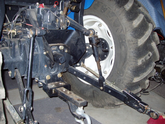

I also need to bring up that my New Holland TC-40 has a factory optional extendable lower 3-pt arms which really helps to take the guesswork out of attaching an implement.
