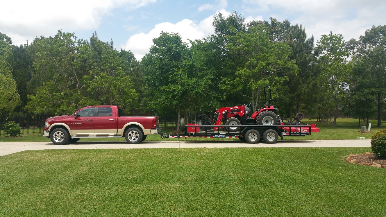

As to pucker factor on tow ratings, I push it every time I load up all the gear tractor/loader/grapple/bucket/boxblade and misc tools and lubricants. Definitely feel the load, but an "Equalizer" brand WDH and rear bags make it track like a train, and my only real worry is making sure I have plenty of emergency stopping space as the half ton lacks a little bit in that department with 8,250lbs behind it. Half ton Rams ride like cars around town which is 95% of the use, but they are a bit limited on tow ratings.

That rig is just too perfect!
Beautiful!
Don't get it dirty!
The Equal-i-zer hitch is the absolute best!
I have the 14,000 lb. model
I have air bags also (love em)
Pulling 12,000 lbs. with a K2500 Suburban 7.3L 4x4
