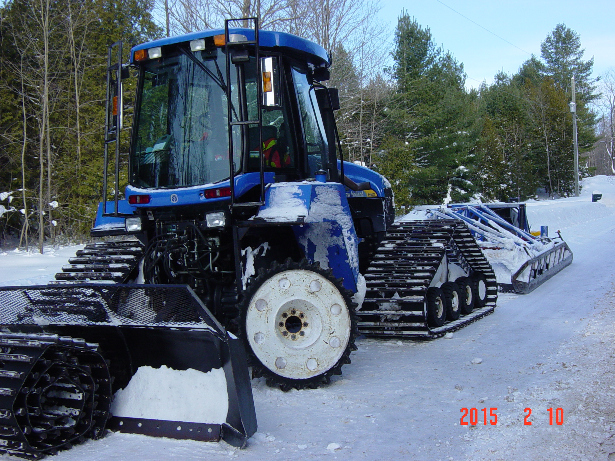

That drive arrangement wouldn't be long for this world working in rough conditions. I came across a large NH snowmobile trail groomer with the same arrangement but larger. It sat in the middle of the road with a wheel broken off.
The track system is extremely robust. I wouldn't say it can't be broken... but I can say, with utmost confidence, that mechanical failure would definitely be the result of extreme abuse.
Their track system removes all of the non rotational load from the drive hub. In other words, the only stress applied to the drive hub itself, is the torque applied from the independent integrated drive (engine power/braking). All other dynamic loads (bump/steer/off-axis torque/etc.) and machine weight are supported by the lower non-driven guide rollers. Also, the internal components (bearings/etc.) are of superior quality to any snowmobile or hub-mount track system. As a matter of fact, the primary load-bearing guide rollers have beefier components than some small tracked skid steers.
