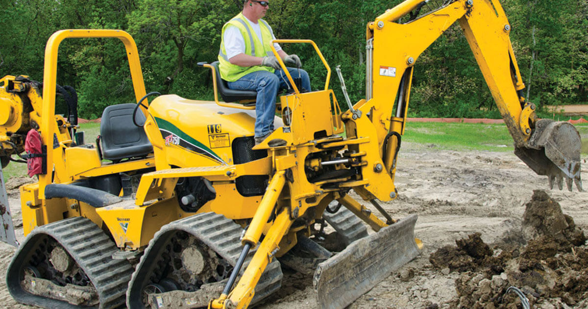

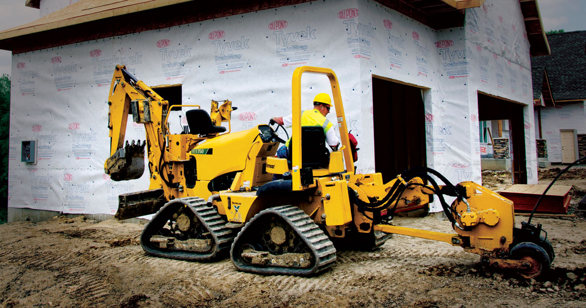

Even if your ground is pure beach sand you would not be able to get a subsoiler to go 36" deep.For pespective, to plow in a line 36" deep you would need a Vermeer RTX750, its a 6000lb 75hp trencher / plow.
Most drillers I know will dig a line with with a mini excavator or a backhoe. Generally whatever the depth of the underground discharge is the depth the line is going to the house. You do not want to have to deal with frozen well lines. They suck!

I have some other work a trencher would be fast for, so it sounds like I'll just be renting one of those in the near future. That will also let me go 48", which sounds a LOT safer to me than 24...

Bottom line is, your little tractor don't have the arse anyway. Go rent a trencher and be happy. 1/2 day job at most.
   / how deep can I run a subsoiler (for running pipe) with ck2610 #17
Either use your backhoe or rent a trencher. The subsoiler has no chance of working.
