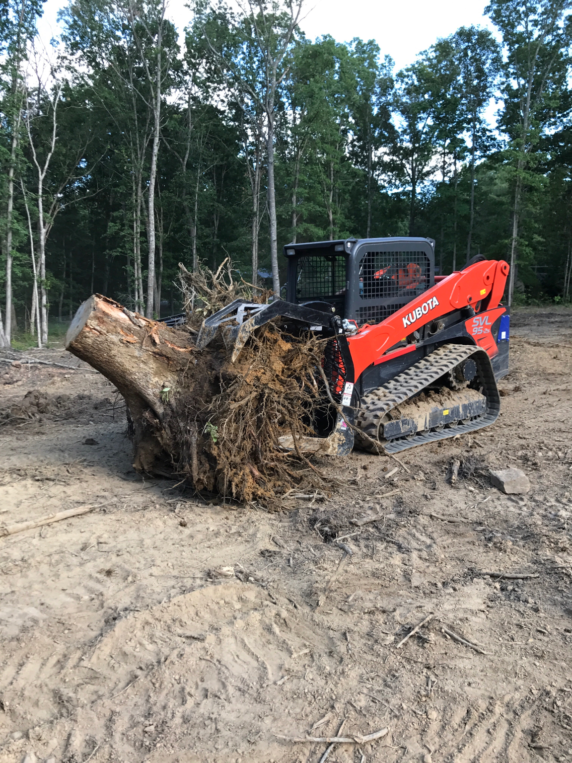

Not knowing the tree varieties, you might consider renting a CTL with tree puller. If it can pull them you'll make a lot less dirt mess and all that's left are small roots that will mostly die.
Regardless of tool used to take them out of the ground, what are you going to do with the mess?? You haven't mentioned whether you have a tractor or not?
What is a CTL and yes I do have a tractor - NH 3930
   / How difficult to operate a mini excavator #15

Yep. And that machine with a tree puller will make a mini-ex look stupid in regards to removing trees 6" diameter and less. If they are near each other it will remove at least 6 for every one the mini can dig up. And make less mess in the process. :)
