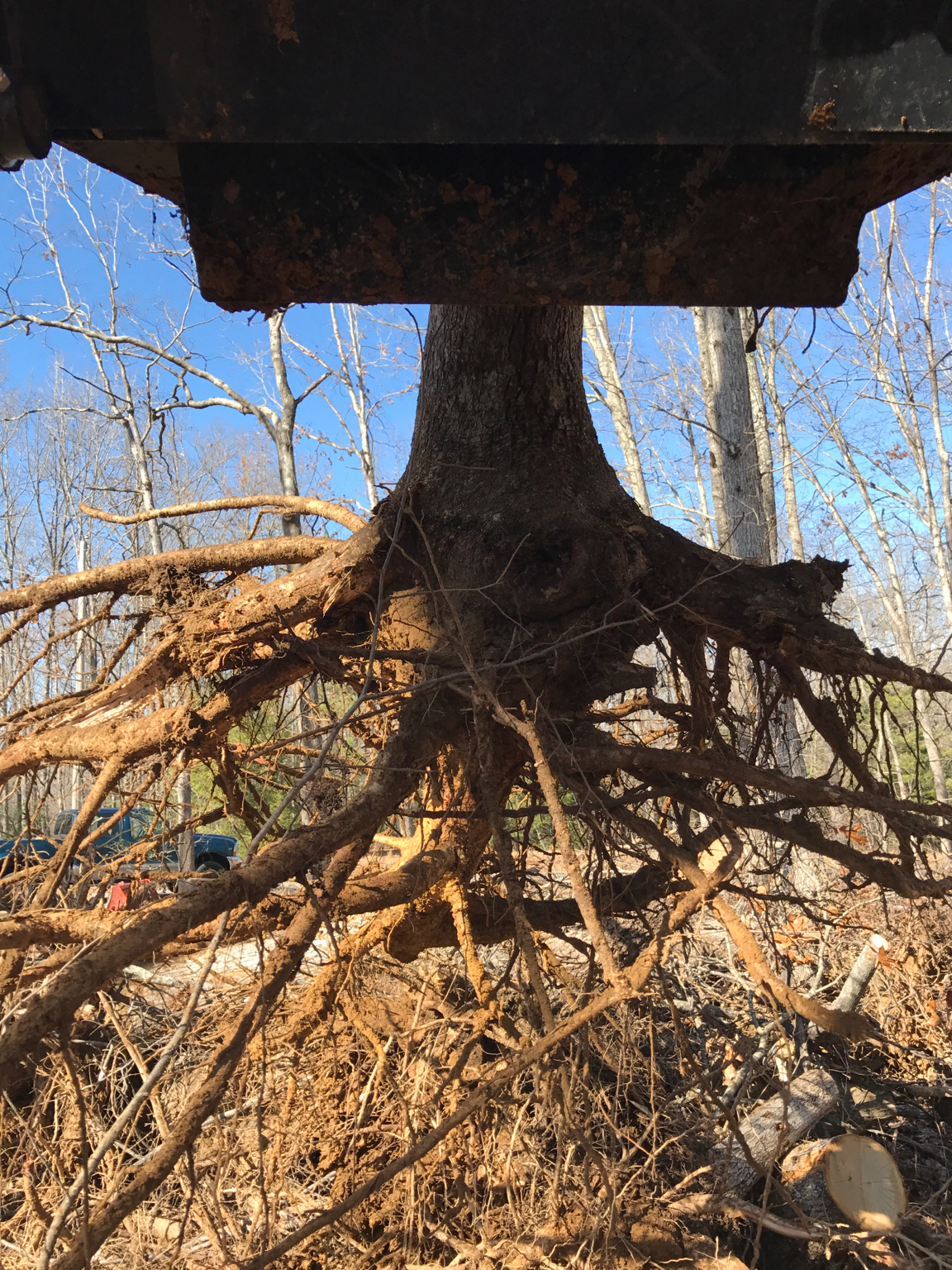

Yep. And that machine with a tree puller will make a mini-ex look stupid in regards to removing trees 6" diameter and less. If they are near each other it will remove at least 6 for every one the mini can dig up. And make less mess in the process. :)
It sure will. That machine is a beast. At least compared to our tractors. Although if I was trying to clear 3 acres I'd buy a full sized backhoe and sell it when the project was done. Unless you're retired I think you'd have a hard time clearing 3 acres in a month especially being an inexperienced operator. IMG_9390.JPGIMG_9353.JPG
