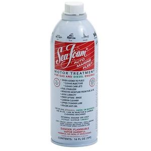

/ How do I correct engine surging? #6
Available at Walmart, auto parts stores, etc.
Steve
<img src="http://www.tractorbynet.com/forums/attachment.php?attachmentid=471428"/> Available at Walmart, auto parts stores, etc. Steve
Thank you! This is my first time using tractor by net and I have to say. You guys rock.

Seafoam is not snake oil, that is unless snake oil is good for cleaning carbs and making intake valves clean as a whistle. I have used it for years, every time I have a engine that has set too long and doesn't want to run right, it has worked. Snake Oil, LOL!

I agree there is nothing "snake oil" about sea foam. It works! That being said your idle circuit is plugged in the carb. The surging is from the engine not being able to run on the idle circuit.When the revs slow down the governor opens up the throttle and the engine pulls gas out of the main gas circuit. The engine speeds up too much and the governor slows it down and since the idle circuit is plugged the governor opens up the throttle again. And the cycle just keeps repeating.
If you are lucky enough to own an older mower with an adjustable idle jet screw you can often get away with just gently turning the screw in while counting the turns in and the turning the screw back out the same amount. Do not confuse the idle jet screw with screw that adjusts the idle speed. The idle speed screw is closer to the top of the carburetor and adjust either with or against a part that moves. The idle jet screw if it exists will be lower and turn into the carburetor body.
If you have a newer engine with a set idle screw then you need to take the carb apart and clean it. I or someone else can walk you through that but lets try the simple stuff first.
I'm just going to add that spraying Sea Foam down the carb with the engine running might do the trick too. Yamaha also sells a Combustion Chamber Cleaner that will make dull carb parts look like new again. It's also designed to spray into a running engine. I've never used it in that way but you soak ugly looking carb parts in it and they come out looking like new.
