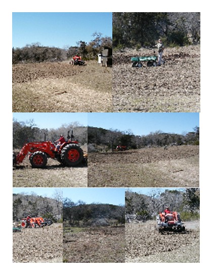

Well Whiskey, You'll be happy to know that indeed it works better to just seed the fields have everyone clear and then straighten the gangs out on the disk and run it light and fast. We got almost 2 acres done plowed, seeded and covered. When I went back and looked at the fields after we finished you could still see a seed once in a while but pretty much everything has a light cover of moist soil over it. The reason we wanted to get it in this weekend so bad is the weather folks are forecasting showers for mid week and I wanted to take advantage of the posibility of rain if we get it it'll be an awesome planting. After spending 2 days from sunup to sundown on this I can honestly say I've had enough tractor for a day or so. I feel like I've been road hard and put up wet. The discing went great after I started using the lift the disk and make the turn method and then do an X thru the middle to finish it out. Although once I staightened the gangs to cover the seed I just went straight and kept my overlap to a minimum so I didn't cover the seed to deep. Thanks to everyones ideas my honey came out and helped seed and took some pictures so hopefully I can post them tommorrow once I'm at work where I can get some rest. /forums/images/graemlins/grin.gif

It took me all day lots of questions and a new program but heres the pictures of one of the food plots we seeded on Sunday.

Nice pics....a little small. What kind of soil was it? Looks like it may have been damp clay when you started working it.

Argee, Its was untilled Texas top soil and the pictures were my first attempt with Microsoft Digital Image Suite.

I would be very surprised to see much of what you planted to grow in that.

cowboydoc, I'm going to go with the my glass is half full frame of mind until april. I know from the pictures that it doesn't look like much but the disk did a good job without adding any weight and after working the land numerous passes to break it up it loosened up nice and I was pulling down to the disk axle most the time. We are just starting our spring here and the rains are intermittent but I'm able to irrigate the field closest to the house so it'll probably do the best. I'll post some pictures of the fields once they start growing and I'll hope to surprise you. I was able to fertilize with granular type fertilizer so I hope this will improve my chances as well.
