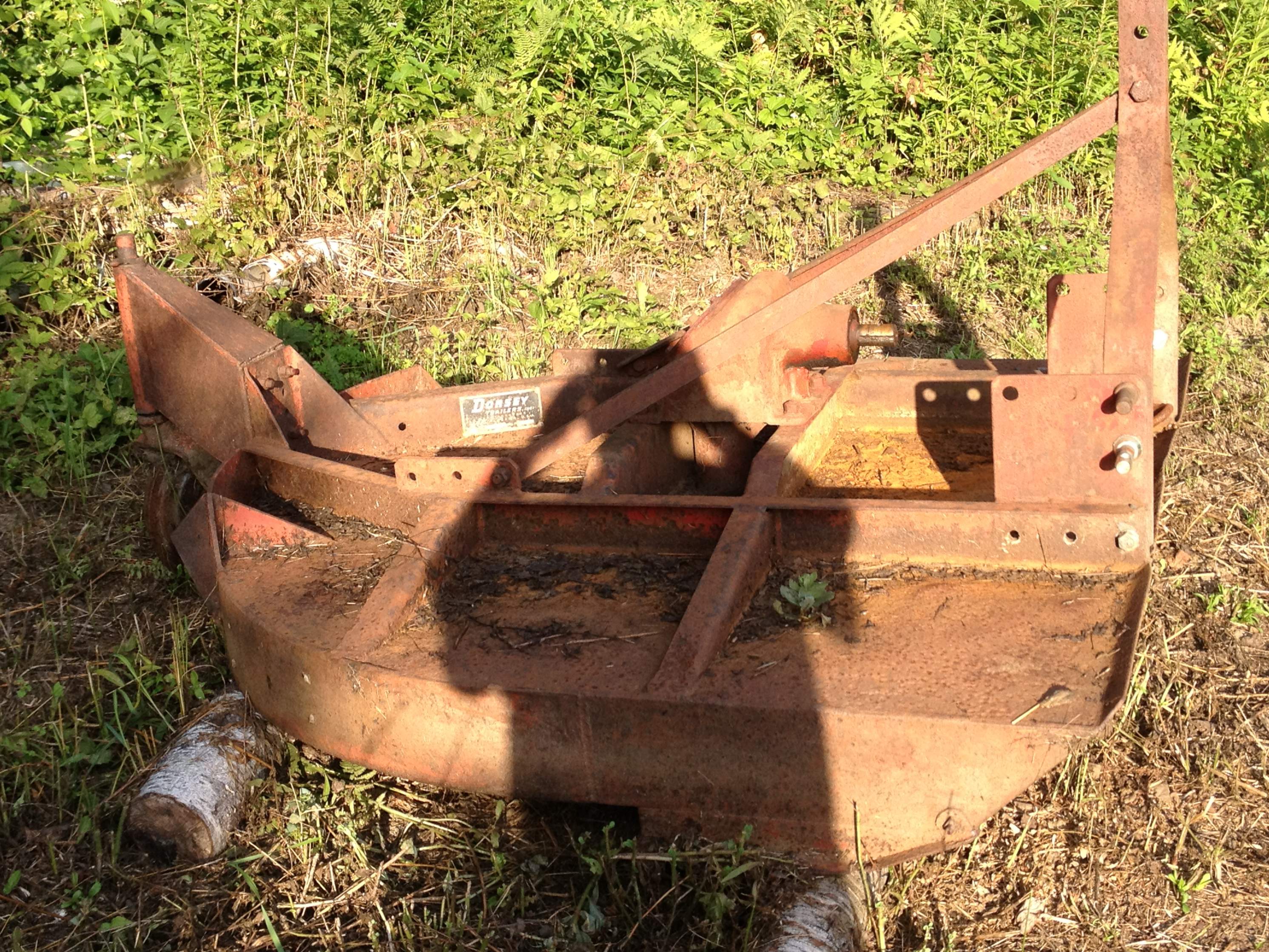

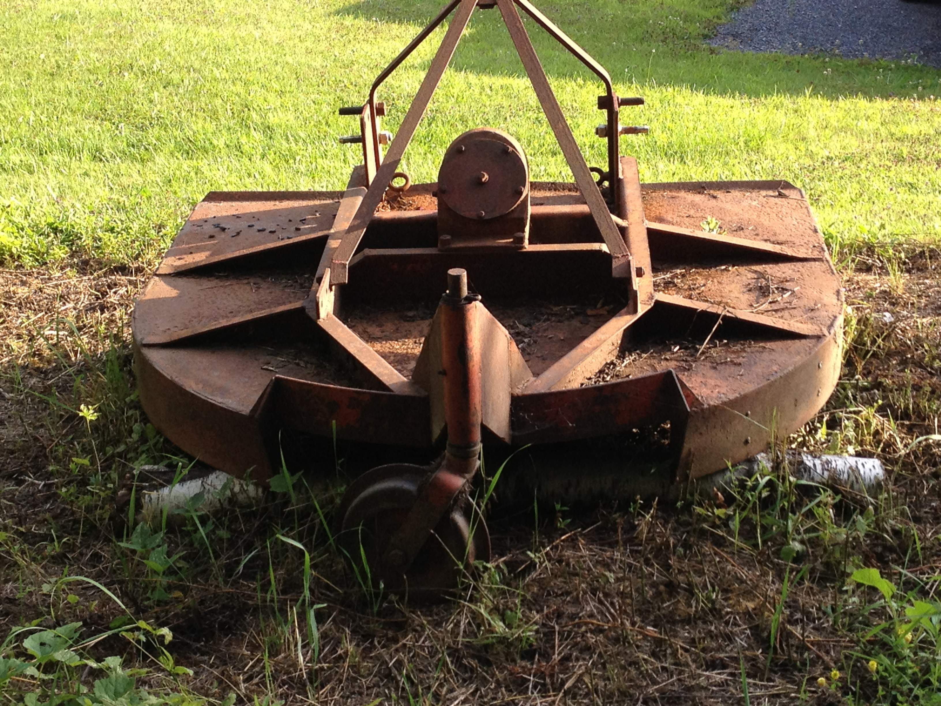

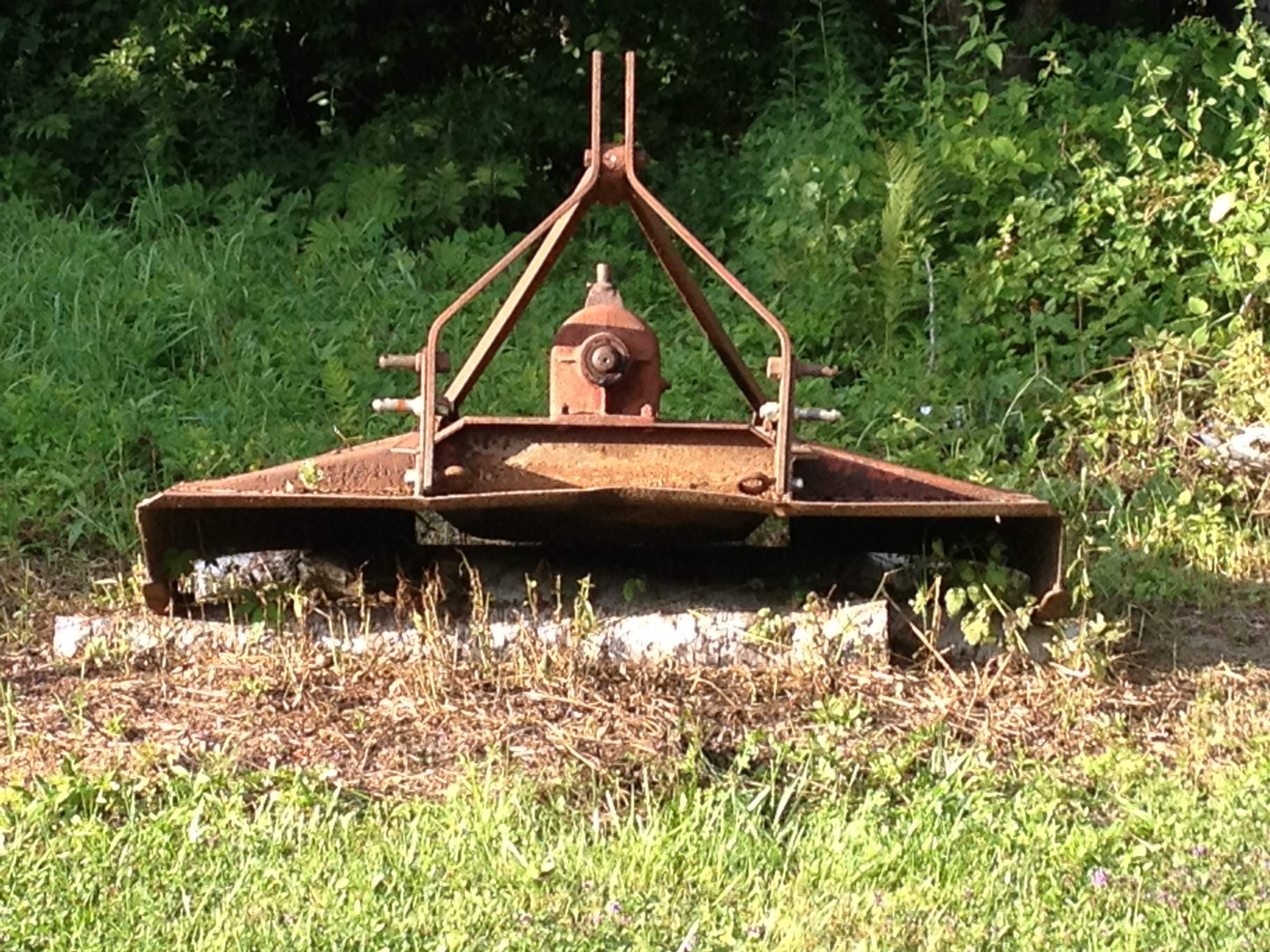

Did your old cutter have a stump jump or just a blade bar? Normally a cutter with a large round blade carrier will not cut as clean as one with just a bar. Also lots of old cutters used shorter blades vs. newer cutters 2ft. long blades.
The old brush hog had a big round fly wheel type stump jumper. The new brush hog has a plate type.

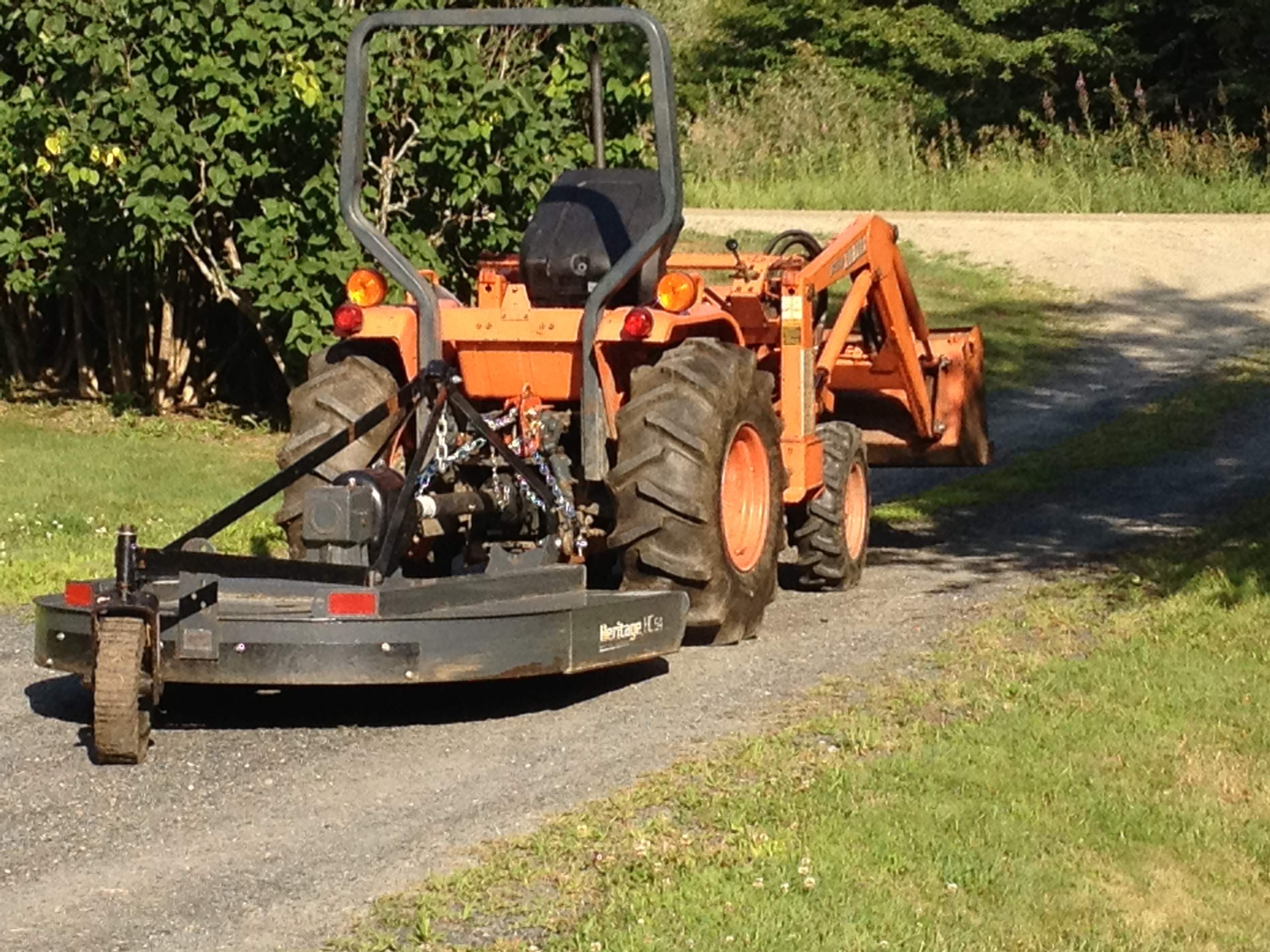

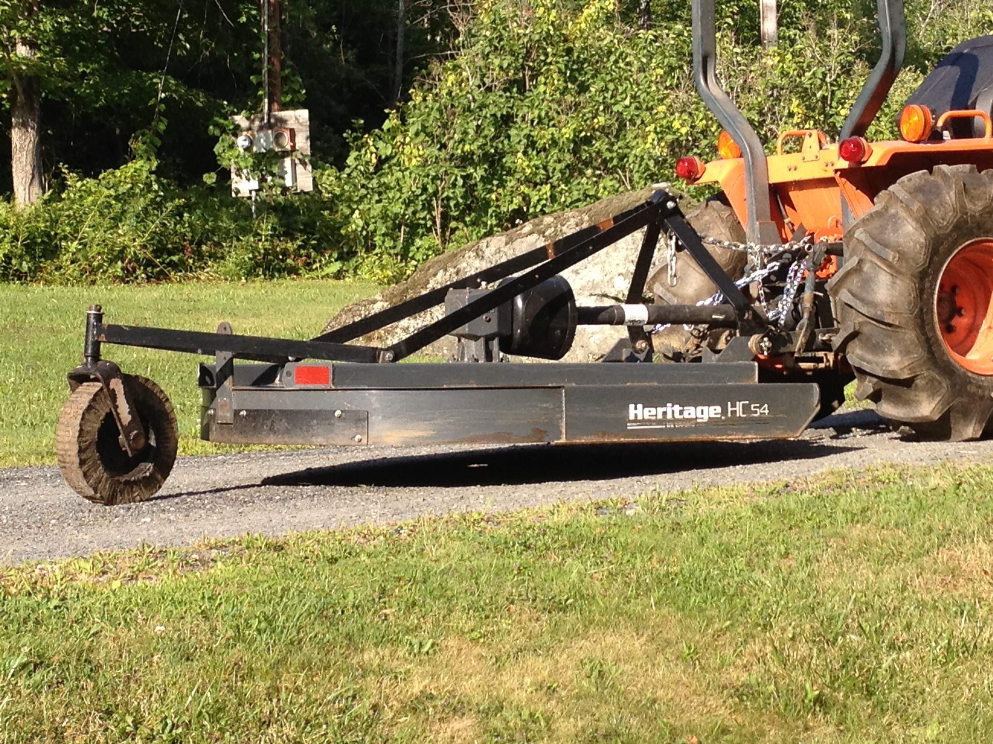

It was open in the front and rear. See attached pictures.
   / How do I get clean cut with Brush Hog? #20
It's hard to judge anything from those two picture you're posting, because the tail wheel is turned around backwards. If your cutter is anything like mine, the rear drops several inches when the wheel turns around front-wards. If you're going to adjust the height, flip the wheel around front-wards before you do it. In the pics, it looks like the front of the mower is riding a few inches lower than the rear, but I bet you once the tail-wheel flips around, the back is going to be level with the front, or maybe a smidge lower. I'm not sure that's what you're going for.
