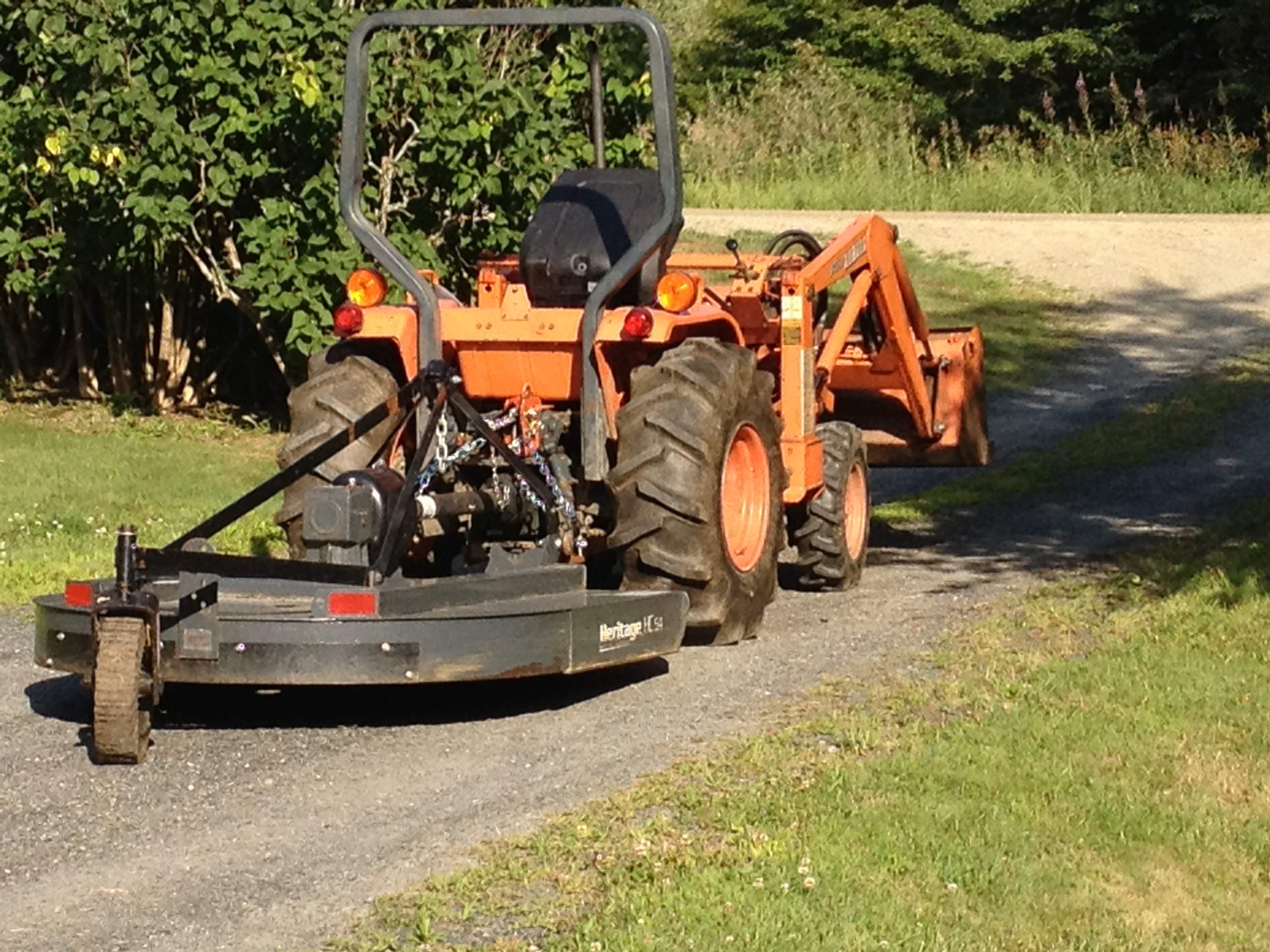

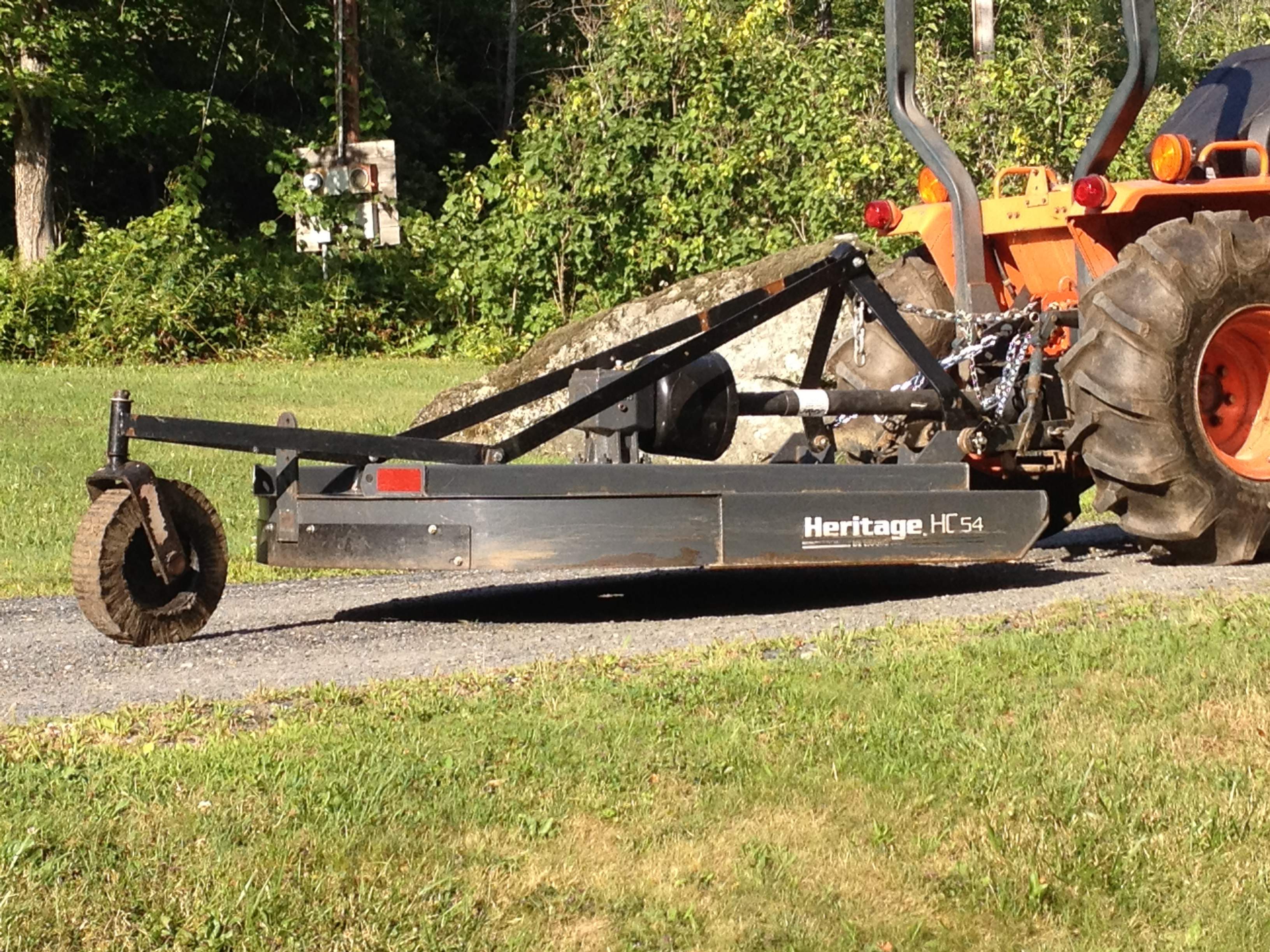

In your pictures you have the cutter way too high. As said already you need to adjust it with the tailwheel pointed in the right direction to begin with. I run my cutter with the front edge rails just barely off the ground so it doesn't dig in too bad on a sharp turn and have the rear of the cutter slightly higher by maybe 2 inches or so than the front. I keep my blades sharpened well too, some guys don't want their cutter blades very sharp but I do and it works for me, I cut more grass with it than rough stuff anymore. My cutter also has a rear discharge opening with no guard or chains. Mine cuts well even at less than full 540 rpms, I usually run mine around 490 - 500 rpms because my engine does very well right there without screaming along ....

Just for grins, try raising the whole deck up or down and see if it makes a difference. I've got a feeling you may be cutting too high. You may have to lower the tail wheel. Having the front of the deck 3"s lower than the rear won't hurt either.

I raised the rear today one bolt hole and will try it tomorrow. I now have a bigger difference between the front and the back. Looks high to me. I already lowered the rear a lot from what came from the dealer. There was only 1 hole lower to go in the rearbefroe I raised it today. I would love to hear from someone running a 54" Heritiagge as to their settings.

From your photos, it looks like the front blade tip will be 6" of the ground which is way too high. Lower the front to just before the skids drag the ground which will be about 3" cut which is about minimum set for a bushhog. Tailwheel doesn't need to be higher than the front unless you have a clogging problem. Raising rear of BH higher allows it to shed the cuttings better when cutting tall weeds and grass but doesn't need to be more than 2" higher in any mowing situation and if in grass less than 12" high, it could work well when front and rear are level as it then allows more blade cutting action to occur both front and rear so the cuttings are cut finer.
When cutting grass which is the hardest to cut, you need full throttle at least to the tach PTO setting for better cut. Weeds are much easier to cut and if you have the power, you can reduce throttle a bit but not more than 200-300 RPM below 540 PTO speed mark on your tach.
I don't think there is anything wrong with your bush hog other than blades may need sharpening to a fine edge. You need a fine edge on BH (just like a lawn mower blade)to cut the grass clean. If cutting saplings, you don't want a shear cut from a very sharp blade so the blade can have a blunt edge so it shatters the sapling so it doesn't leave a punji stake sticking up
OVERVIEW: Check your blades and sharpen if needed, drop the front till the skids are almost touching, drop the rear to not more than an inch higher than rear or level if the clippings still clear from under the deck OK, keep the RPM at or above the 540 PTO marked position on your tachometer and keep your speed to not more than a fast walk (4-5 MPH)
