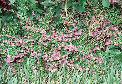

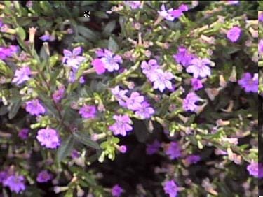

jdgreg
I know we're in different regions but mayby it's this stuff,grows wild
like crazy in my pasture and it wasn't there 2yrs ago?
Just a Thought!

Thanks for all the feedback. :D I talked to the extension office this am, and he pretty much agreed that spraying this time of the year wouldnt do much good cause the weeds are starting to shutdown anyway. Go ahead and mow, and then spray in the spring.
I've pos id'd the weeds as spotted napweed. The extension ofc person recommended ForeFront (also recommended Grazon, but it's controlled) as well as Redeem, neither are controlled. The ForeFront is supposed to be similar in makeup as Grazon but doesnt have the chemical that makes Grazon controlled.
So my plan now is to mow close, and spray in the spring with Redeem (I already picked that up), then spray again early summer (or when the weeds start popping up) with ForeFront.
