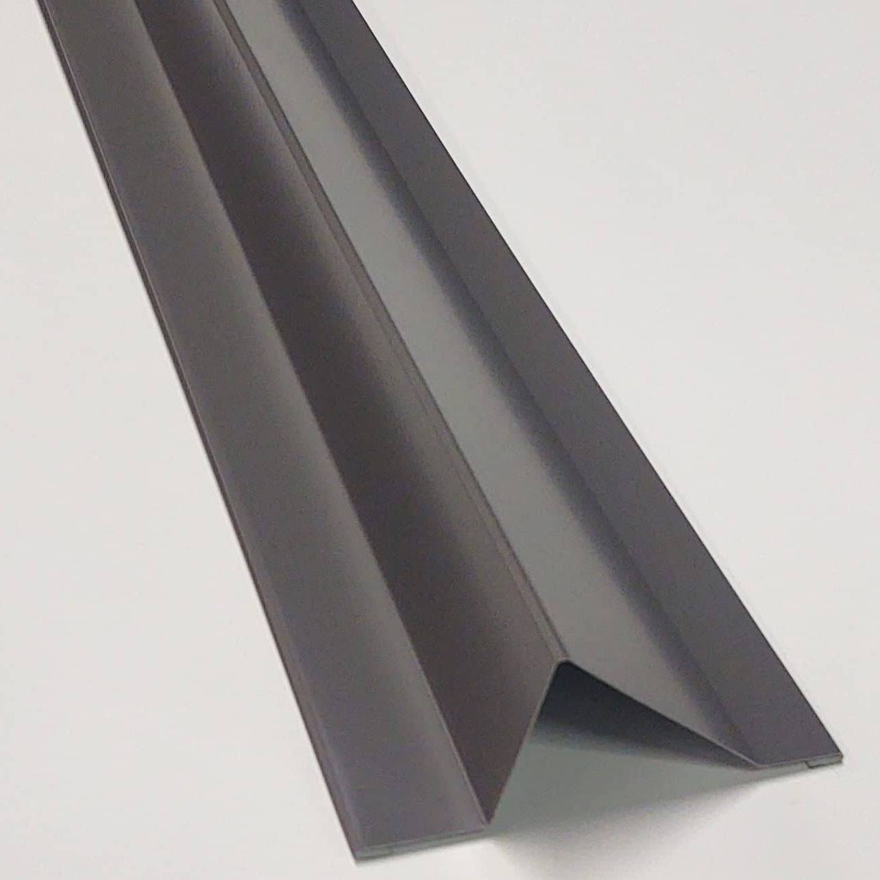

Commercial metal buildings often have those dams installed -I always assumed there was a liability issue with the snow shedding injuring someone.
What about the kind of louvered dispersal things look like miniblinds? Not sure how they would take snow but they are supposed to keep the runoff from falling straight down and eroding your concrete
   / How do I protect rain gutters from ice damage?
#24
Fair enough, but that's also what the gutters do. Except when they get torn apart by ice and snow, which I am trying to prevent. šŸ˜€
