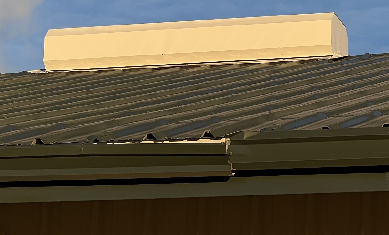

Here is a picture of the gutter, damage, and profile of the metal roof.
The eave extends about 3 feet past the metal building, and I believe this is a contributing factor. So right now I am leaning toward heat tape along the top of the roof above the eave, and inside the gutter as well.
It's a shame the gutters couldn't be lowered 6 inches and then adequate heat reasonably applied to keep them from filling with ice.
I will look to see if that is possible. But if ice is breaking free and sliding down, it seems it would still catch the gutter?

It extends about 3 feet past the exterior wall, 4 in 12 pitch. The building sales person talked me into that configuration to make it more fit in with a "high end residential rural area" and I agree. I regret that decision to this day, for this issue and more.
I'm talking about the metal roofing itself. It should extend past your eaves, over the gutters 1-3 inches. If it's closer to 3 inches, you may be able to lower the gutters enough for the snow and ice to go over top of them. If you lay a straight edge on the roof, over the gutters, you want to outside edge of the gutters to be lower the straight edge, ideally 1-1.5 in. lower. Doing this, combined with the metal roofing being out about an inch in from the outer edge of the gutter allows the sliding snow to shoot out over the gutter rather than getting hung up and ripping it off. Is this building insulated? Heated? In almost all cases, the more overhang you have, the better. It helps to better protect the whole building, all the way down to the foundation.
The ice doesn't just go off the edge of the roof and immediately drop straight down. It sort of curves as it slides off the edge of the roof. The idea is to get the gutter on the inside of that curve, like a surfer inside a big wave.
It is a 60x60 metal building, 4:12 roof pitch with about 3 ft overhang at the eaves, 6" insulation on interior walls and ceiling, and heated .... sort of. It is not heated to comfort standards but has a Reznor 250k btu propane heater that prevents the interior from going below the mid-30's to prevent internal freezing. 40F temp on the inside is not uncommon at all, often warmer during the day.
In my climate, it is frequently below freezing at night, and frequently above freezing in the day. During the day there is significant UV exposure leading to rapid snow melt. So lots of freeze/thaw cycles.

I have seen even ladder style snow stops on commercial metal buildings rip right off. I wouldnt try to stop the snow. I would try to lower the gutter enough that it wont get hit by sliding snow/ice.
