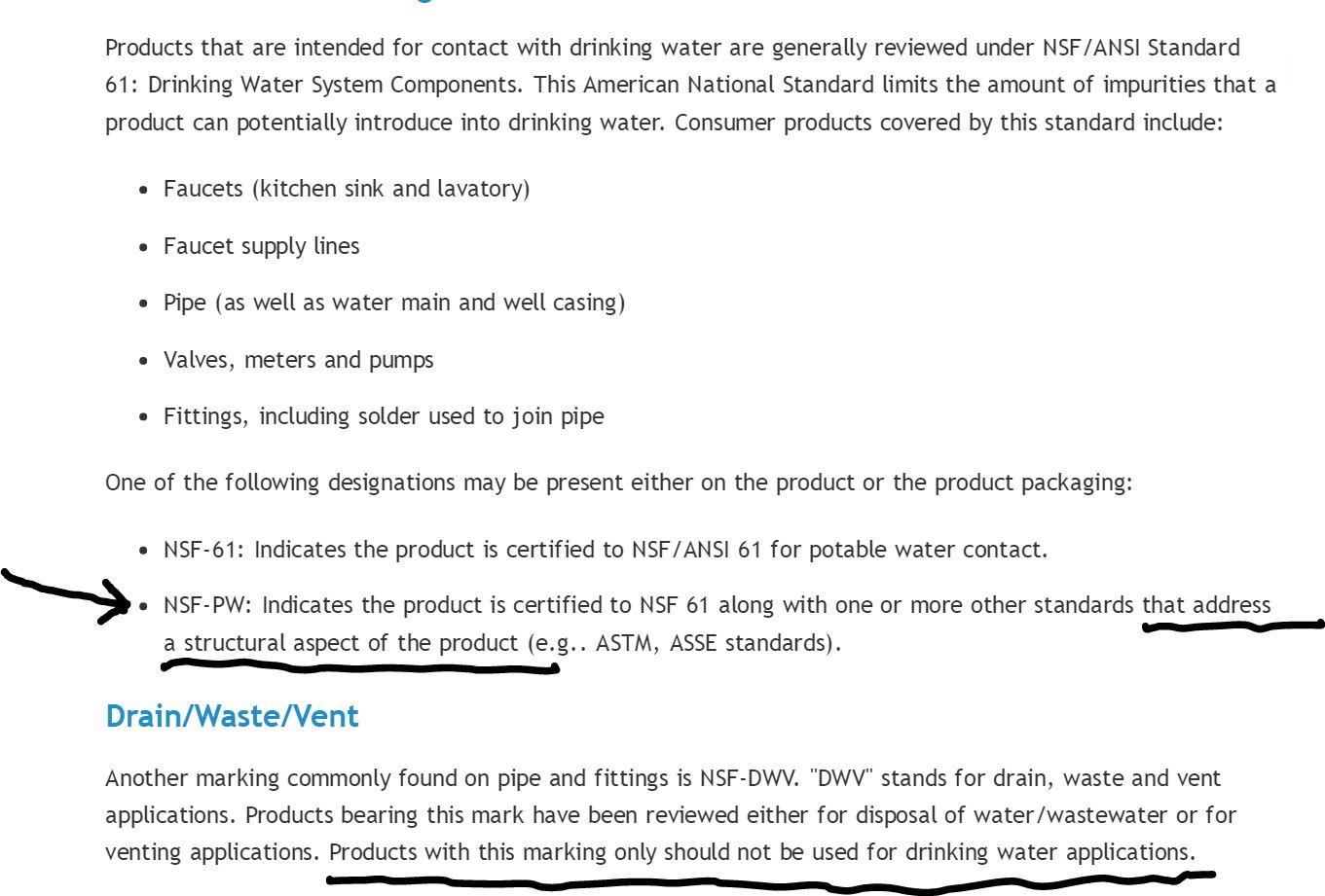

The pipe is also marked nsf-pw doesn't that mean that it is also rated for potable drinking water???
Here is an explanation: Understanding Plumbing Product Markings - NSF International
   / How do I read this meter? #23

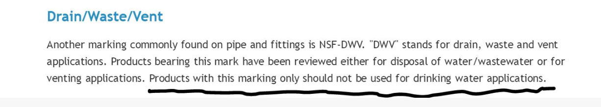

I saw the same thing, and the markings on the pipe are certainly confusing.
In one place it says NSF-PW which clearly means suitable for potable water, but it also says DWV which should not be used for pw applications.
I would ask the local building inspector. The contractor is not going to want to replace that line unless the inspector tell him he has to.
OTOH, I would not pay for anything until the water line is fixed properly.
Another thing to think about is what have temperatures been lately, and is the pipe buried deep enough. PVC pipe must be derated for temperature and the derating is very substantial.PVC Pipe | Schedule 4� & 8� Temperature Derating
If the pipe is near the surface, and in the sun, reaching 120 to 140 F is entirely possible with no water flow.

I'm confused. The pipe says well casing. How can it not be rated for drinking water?
   / How do I read this meter? #25
The pipe is rated for both PW and DWV. NST-DWV cannot be used for PW unless there are other designation such as those shown. Copper pipe is similar, it is often rated PW and DWV.

No confusion, it's a multi-rating pipe ... good for both potable water contact and dwv service. As far as the meter goes, the 156 are "test digits" used only to verify the accuracy of the meter, since you're most likely billed to the nearest 100 gallons.
