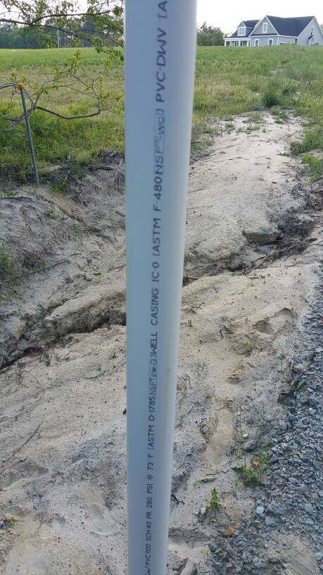

Eddie, this is the pipe that they used. They did use purple primer and clear cement. We did install a 1.5 inch water meter, which may account for the high pressure.
Do you see on the pipe where it has the initials DWV on it? That means the pipe is to be used for Drain Waste and Venting. I'm no expert on this, but it is my understanding that this is not allowed for a water supply line. It's a different type of PVC. I wound not have used it for a water supply!!!!!
Again, go to your local water department and talk to them. I believe you have the wrong type of pipe in the ground.
When I googled it, I found out that it is not a solid PVC pipe. It has a PVC layer on the outside and the inside, with a foam inner layer. Again, this is the wrong pipe to supply water to your house and it needs to be replaced with the proper pipe. Did a licensed plumber do this or some kid the Contractor hired?

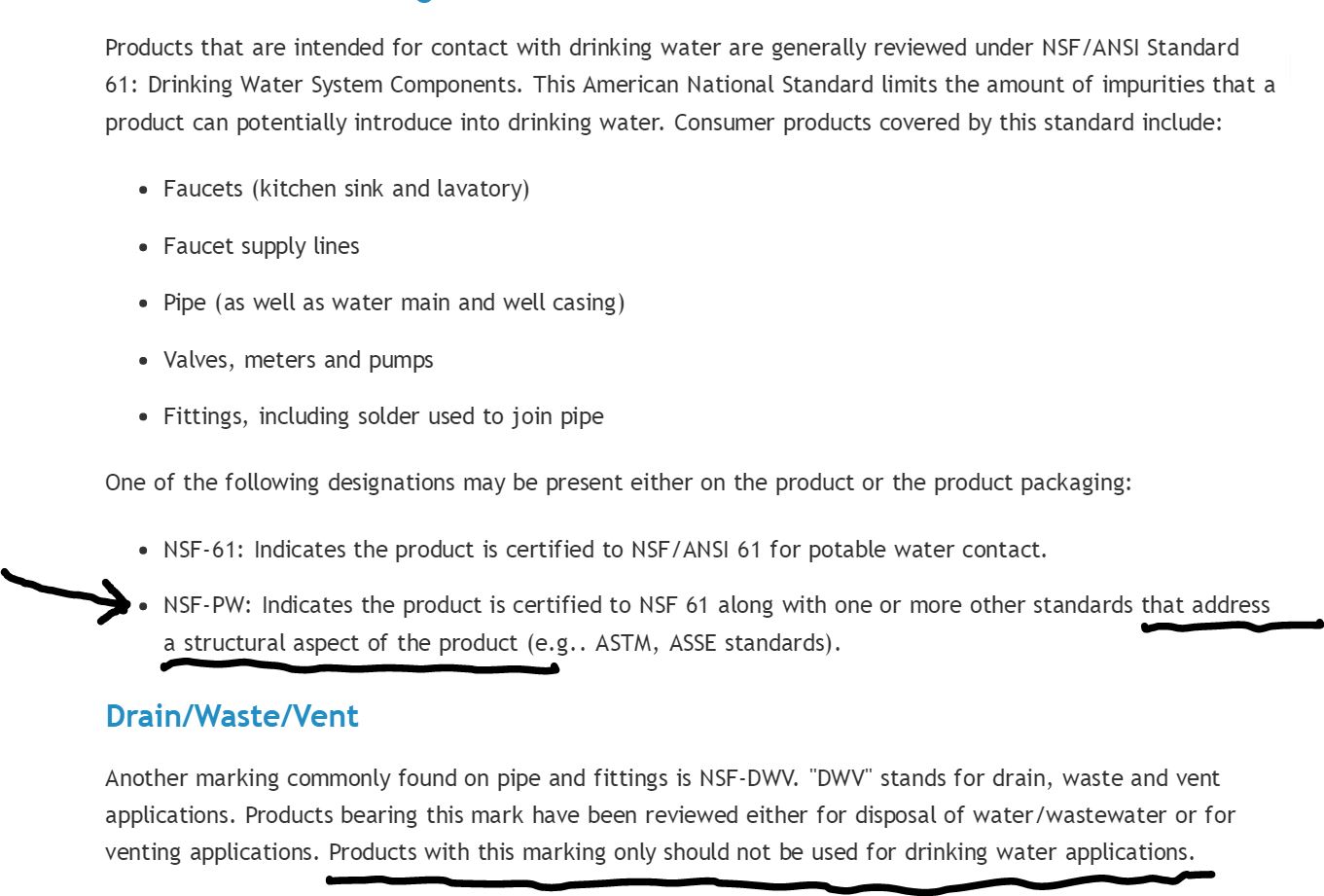

The pipe is also marked nsf-pw doesn't that mean that it is also rated for potable drinking water???
   / How do I read this meter? #20
I don't know those letters. When I buy water line, it doesn't not say DWV on it. That is in another stack. I use DWV for drains and venting because it's cheaper.
