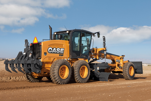

I'd hire this out. You can do a bit of it at a time for cost considerations. Several years ago a neighbor bought some land a few miles away as he wanted a hay field. It was only about 15 acres but kind of hilly and pimply as you describe. He hired a large road grader with rippers in the back and a scraper blade mounted to the front. This thing was smoothing out land in 12' swaths and did it much faster than a dozer.
Mention it just for the info as this seems to parallel the concerns my neighbor had.
