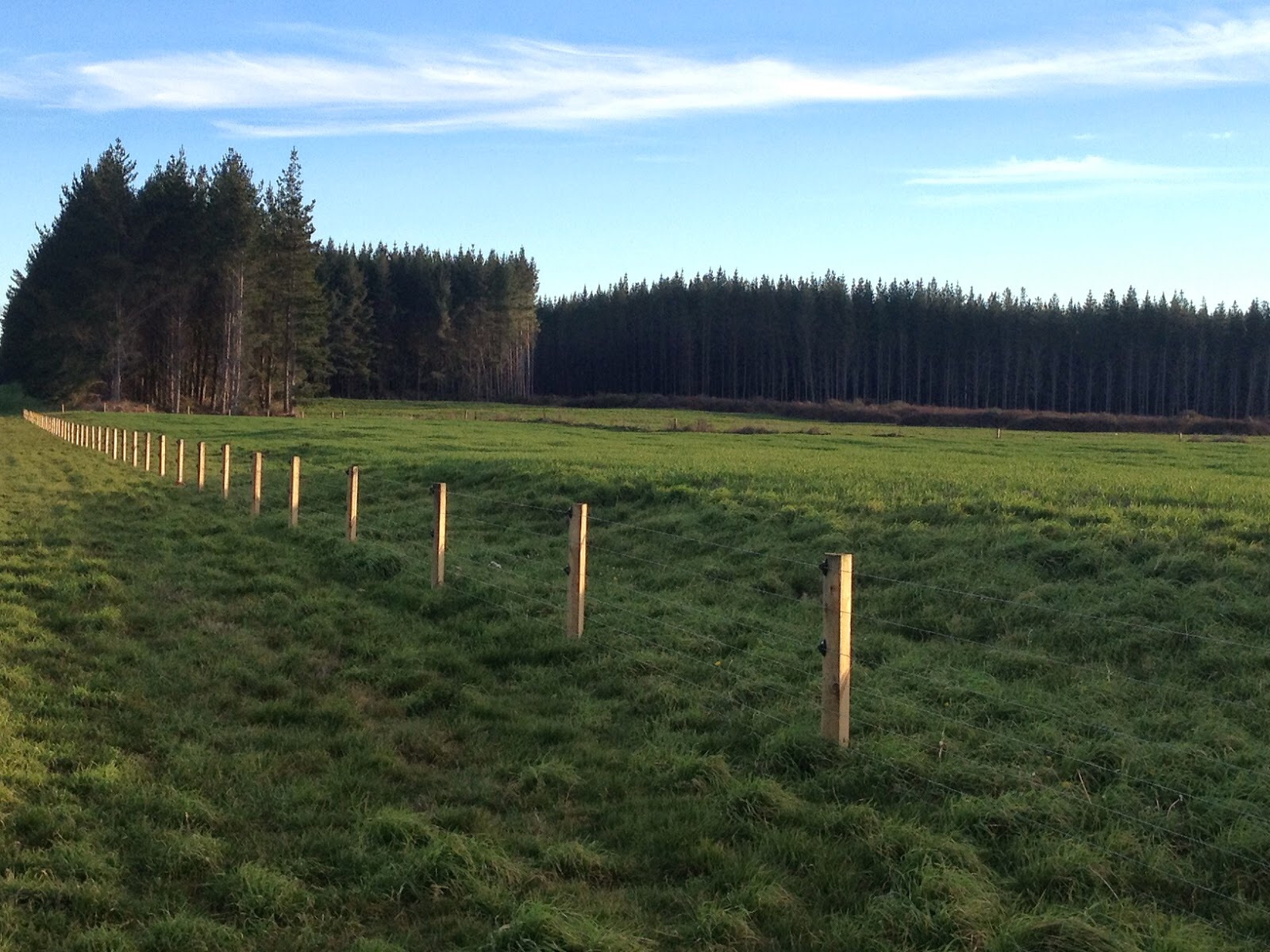

I wouldn't really call the imperfections bumps, they're more like swells in the ground. They aren't really pronounced swells, and they look pretty natural for the area, but it's a pain when making hay. Or just driving on it in general.

I'm out of town for the week so this picture I found on the Internet is about what it looks like. See the bumps in the background.

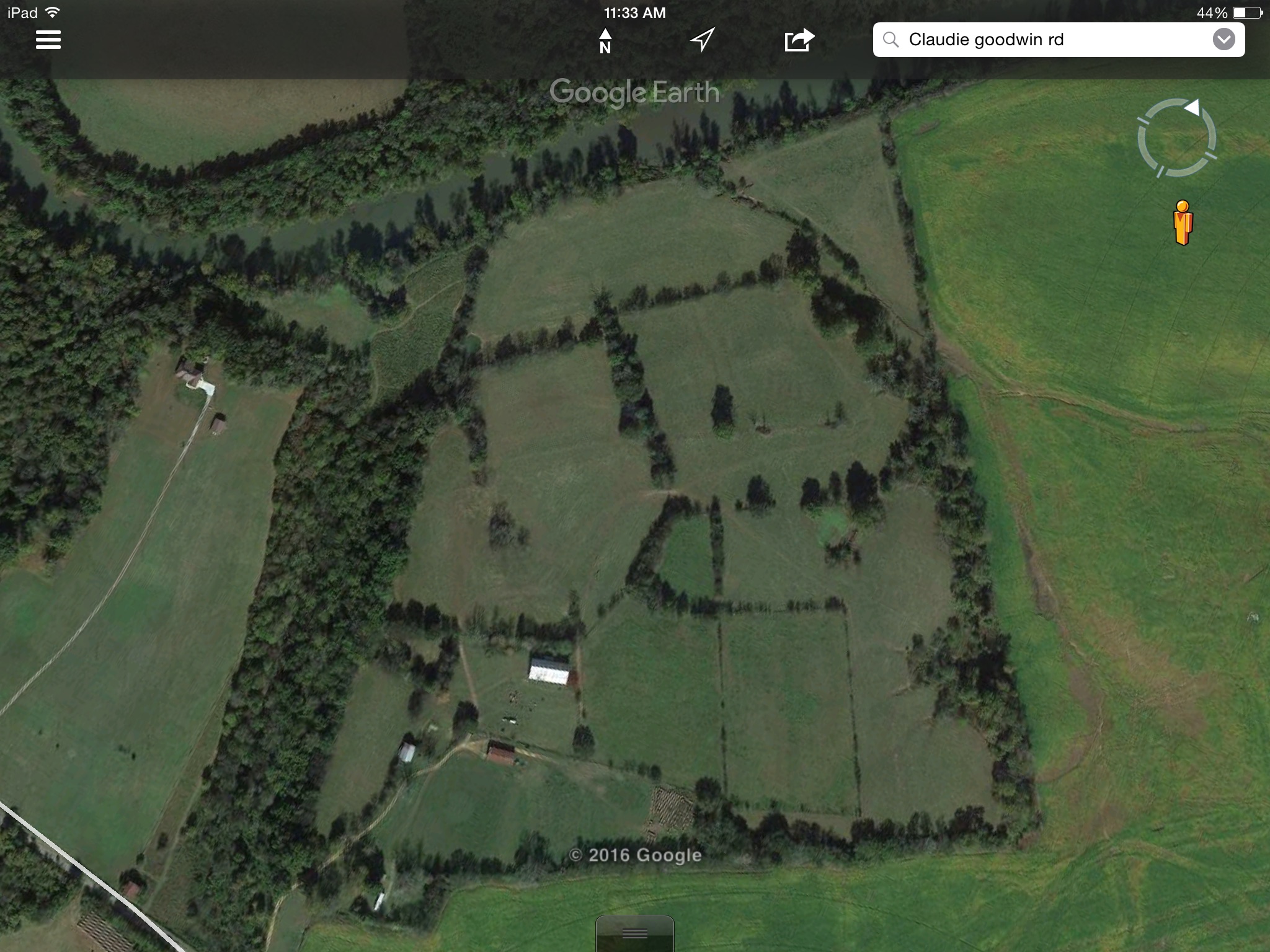

This is a Google Earth image of my field, and as you can see, there's a little ditch that follows a waterway in the top-right corner of the field and drains into the river. I would like to fix that. And don't worry, Im getting rid of the trees.
Our tractor is a 70 hp, but I wasn't planning on using that anyway. There are some local farmers with much larger tractors to get the job done.
Are there any companies that specialize in this stuff? If not, can I get a excavation company to just bulldoze (or something like that) the whole thing? I'm not too concerned about price. As long as it isn't like an insane amount of money.

The best,though not the cheapest, is to hire a construction outfit to come in with a belly scraper. That is what they use to redistribute the terain before the building process begins. Probably wouldn't take long to flatten it out a little more. Not sure what that would end up doing to the topsoil though.
