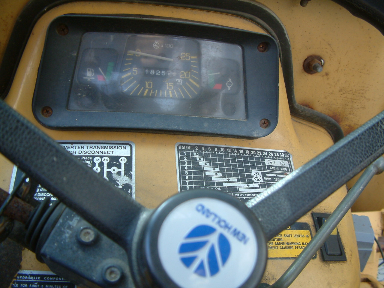

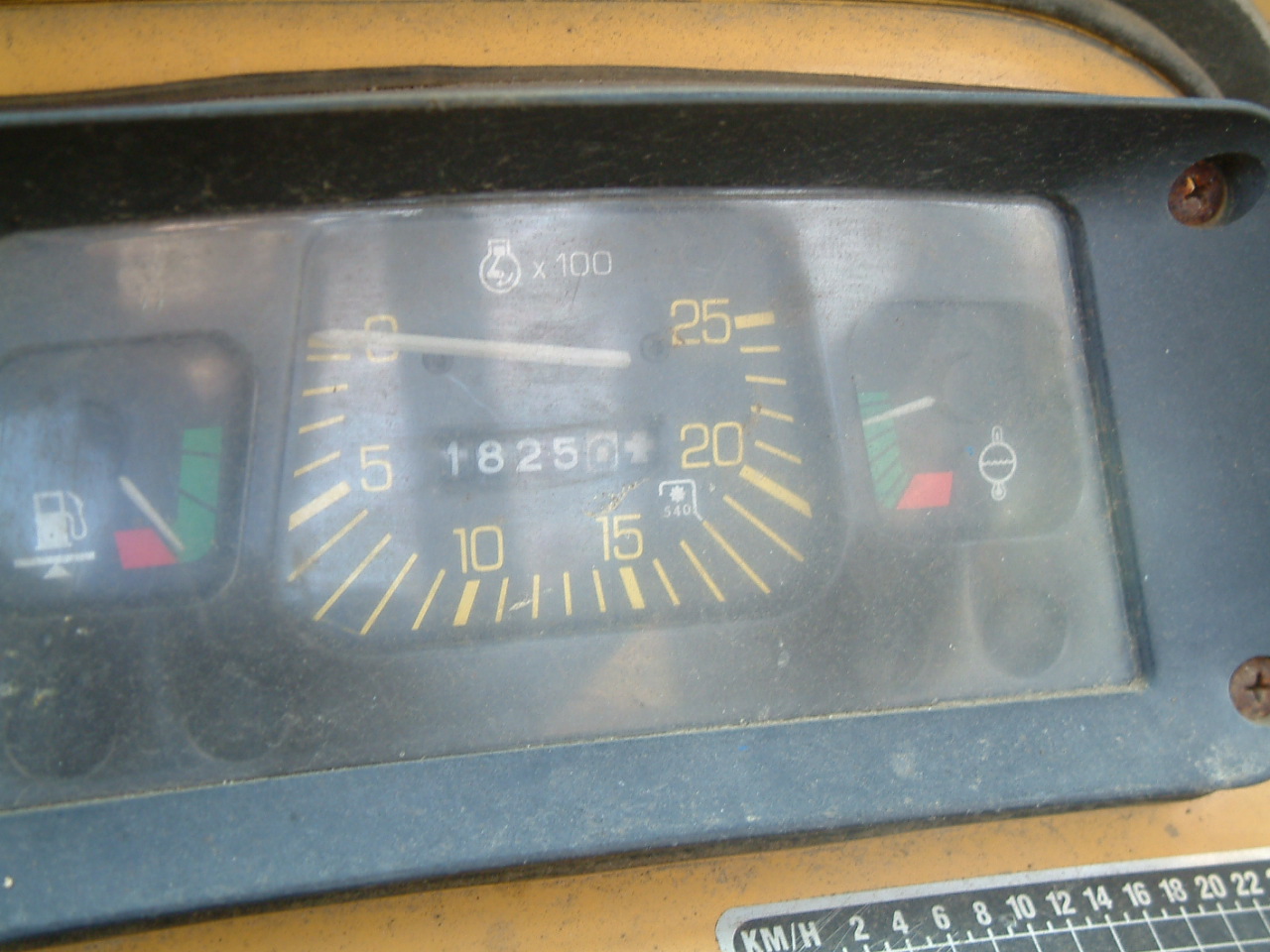

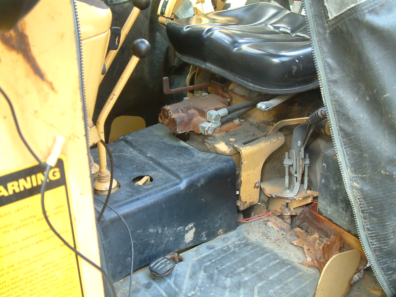

Here are some of the pics that I took a little while ago. I will get some better pics, but this may get us started. Thank you very much.

Based on your first and second pix, I'm going to say that those are the shift levers for the trasmission. The shorter one should be high/low range and 1-4/5-8 on the taller one.

Thank you. Any idea what the foot pedal on the left side is for?
   / How do I start a Ford New Holland 545d? #9
I'm going to say axle lock. For locking left and right axles together during limited traction situations. This is just an educated guess though.

Lever on left of the steering column is the F-N-R lever.
Foot pedals on the right are the turning brakes.
Lever to the right of the steering wheel is the loader joystick control, it should keep itself in a detented neutral position, or float.
The longer (LH) shift lever is the speed shifter; 1,2,3, &4 th gear.
The shorter (RH) shifter is the range shifter low is forward, neutral is center, high is back. The NSS is conected to this shifter and must be in neutral to enable the cranking circuit.
The foot pedal on the left is the torque converter 'dump switch', loosely translated to a "clutch pedal".
The foot pedal on the right rear is a differential lock.
White smoke does indicate fuel getting to the cylinders.
