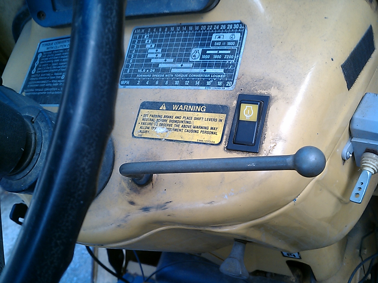

   / How do I start a Ford New Holland 545d?
#15
Also, what does this switch do? And is it safe to spray ether in the intake?

i believe that is the glow plug or preheater grid by the crazy international symbols that it seems are nearly impossible to figure out! is the tractor a loader with 3pt or loader backhoe, just curious doesnt realy change the starting procedure

not if you use the glowplugs. Look at the engine and see if there are 4 wires attached to the head, one for each cylinder, just like the fuel lines for the injectors, one for each cylinder coming from the pump.
at least that's what I've always been told, glowplugs = no starting fluid. use one or the other.

The thermostart unit (an intake manifold heater, not glowplugs) is controlled by the key switch. You can unplug the wire to the thermostart unit (front inside surface of the intake manifold) if you wish to give it a sniff of ether.

That switch by the throttle, it won't stay in the flipped position. If I rock the switch, it just rocks back, it won't lock. Do you think that that is for glow plugs? I wasn't even sure if it has glow plugs. My truck does and I know not to touch ether. But, I have heard that that can work well with diesels without the glow plugs. I will check the wires going to each cylinder, but does anyone know if it is a glow plug motor?
But, it sounds like it uses a grid heater turned on by the key.
