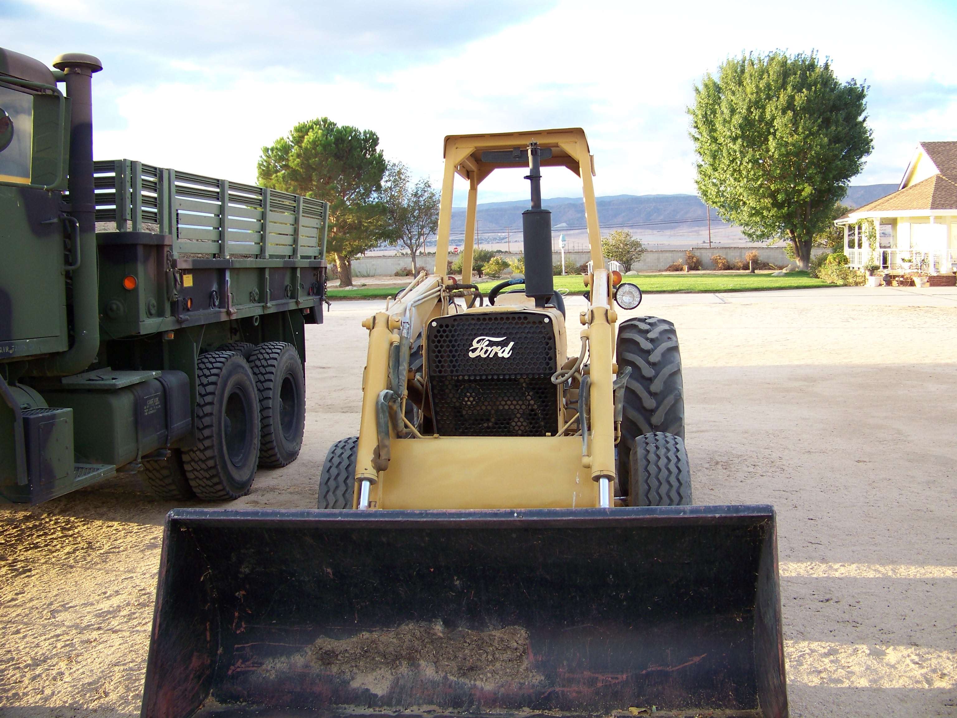

Not to be out done by RRRoger...lol lol I heard an old farmers trick was to put some diesel in a spray bottle..remove the air filter and set the bottle to "mist" and give a diesel mist when trying to
start a tractor where the fuel system has be "compromised?" instead of bleeding. I bleed my injectors and when I was about ready to use the bottle i told my assistant (wife) let me try to start it one more time
CRAP I was looking forward to trying the spray bottle gig
   / How do I start a Ford New Holland 545d? #38
I LOVE your truck !!!!!
