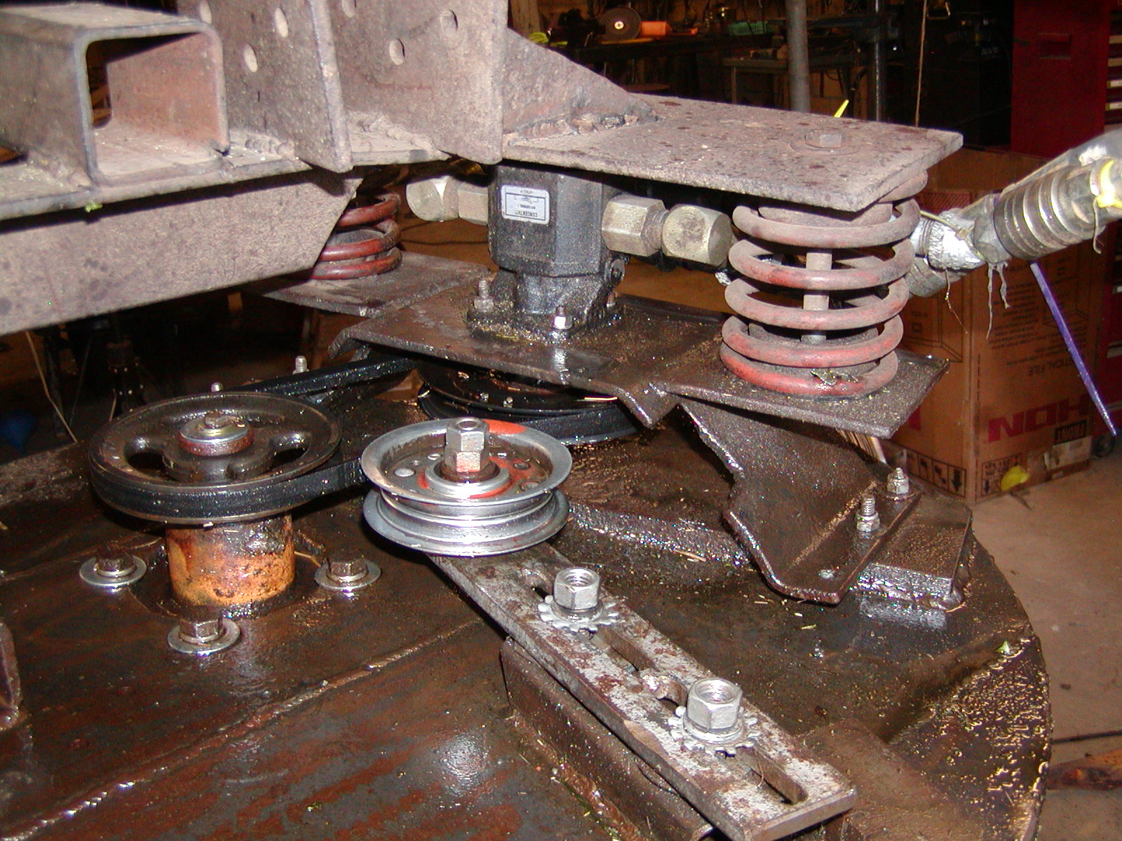

Another picture with belt guards removed.

There is no case drain on that motor.
A hyd spike could be a great deal higher than the relief setting, and much faster than the relief can operate.

OK, can I increase my chances by slowing tractor rpm's down to get less gpm & try setting relief at 1000 psi?
I think our tractor has a 9 gpm pump, but we normally run the engine while using this about 1300 rpm. If we ran at 1000/1100 rpm, I think we might get 3.5 to 4 gpm output.

Inlet pressure spikes will rarely blow shaft seals on gear motors. Inlet spikes will crack the gear housings or blow the seals between the gear housing and end plates.
Return line pressure WILL blow the low pressure shaft seal you have in that motor. I suspect it is rated for 10 - 20 PSI max running with possibly 40 -50 PSI momentary spikes in the tank line. Most of these small gear gear motors have bi-rotational checks built in which vents the shaft seal to the low pressure side. If the low pressure (tank or return) pressure gets to high for a given period of time the seal blows.
Excessive plumbing, quick disconnects, etc. all add to this pressure in the return line.
Does this motor have plain bearings with an outboard roller bearing for side load? If yes it was designed for side load use.
If it just has plain bearings or needle bearings it has limited side load capabilities.
Side loading could cause the seal to leak but unless the loading causes excessive internal leakage it should not cause the seal to blow out.

The Grainger catalog says it has outboard bearing, but we do not find what kind of bearing.
I don't think the seal has ever shown signs of leaking until it blows completely out.
What are my options to lower return line pressure, other than larger hoses & fittings.
What size would be recommended for 5 or 6 gpm flow?
We are using 3/8 hose, but it is running from the rear remote disconnects. We also are going through 3 sets of disconnects.

   / How do I stop blowing oil seals? #19
I think JJ and Oldnslow identified the problem: excess pressure in the return circuit. 6 gpm through 3/8" hose has a pressure loss of 2psi/ft; your hose seems to be at least 20 ft long, so that is 40 psi pressure at the motor exhaust. If your quick disconnects are 3/8" also, they are causing pressure drops of 15-20 psi each; three disconnects equals 45-60 psi. That's 85-100 psi pressure at the motor exhaust; then add the mitered elbows, remote valve, FEL valve if the remote is served by power beyond from it, and other fittings, each of which adds 1-2-3 or more psi of pressure. You did not say whether your hydraulic system has a return filter, but if it does that could easily add another 15-20 psi.
I suspect the exhaust pressure at the motor is very close to the manufacturer's limit if not over it.
The only thing that does not fit is your statement that he seals only blow out when the motor stalls. I understand that the momentum of the fluid in the inlet line will cause a pressure spike at the motor inlet, but I am not certain how that pressure spike also seems to appear in the motor case. With the reversing check valves the motor case is connected to the exhaust line through a check valve, so any sudden leakeage past the ends of the gears into the motor case should be handled through the exhaust check valve. Perhaps the motor case is normally at nor slightly over seal design pressure and even a sligght spurt of fluid past the gears into the motor case causes enough additional pressure to blow the seal.
I think your best solution, if you want to keep the 6 gpm rate of flow through the motor, will be a 1/2" return line as short as you can make it, with 1/2" or one size up quick disconnects (and perhaps fewer than 3 disconnects), and a minimum of elbows (which should also be sweep elbows rather than mitered ones).
