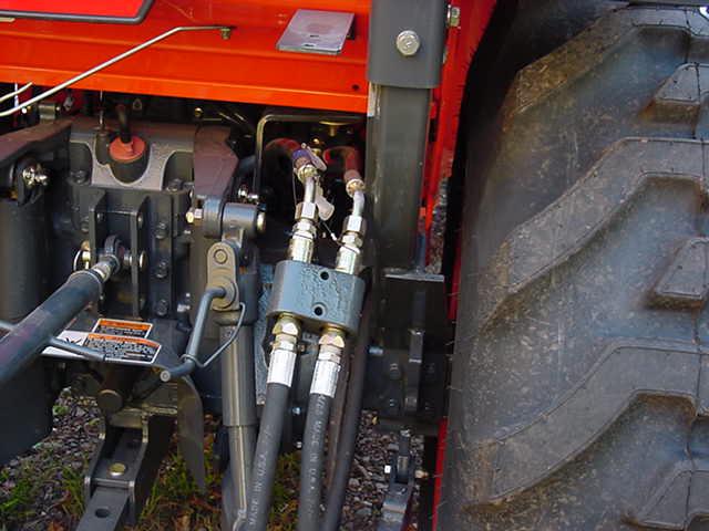

If you have pioneer style couplers on your rear hydraulics, which is pretty much the standard...they are designed to disconnect with a sharp pull..this is a safety feature to prevent accidentally breaking a line if you were to drive away from an implement without unhooking them...
The major cause of hard disconnects I have found is the "Break Away Collar" that holds the female part on the rear remote to the tractor itself.
Look closely at the rear disconnect...you should be able to grab the hydraulic line behind the collar and push it towards the implement...it should move about 1/8 - 1/4 inch...if not look for burrs on the break away collar or misalignment of the slip ring in the break away collar, preventing the disconnect passing by the break away collar.
See attached...note description on the "Double Break Away"
GareyD

I smiled to myself when I read your post, because I went through the same situation. I should have asked for help on this Board, but didn't. Talked to several local equipment operators, but no help. Finally took the connector(?) holder off the tractor - still couldn't figure it out, so took a picture and drove 60 miles to the Dealers. I think he was trying to keep a straight face when he took me out to the yard and just pulled the hoses out as desribed earlier on the board. I admit to being hydraulically challenged among many other things - but it's all fun and learning. Posted picture that I took to the Dealer. penokee /forums/images/graemlins/smile.gif /forums/images/graemlins/smile.gif /forums/images/graemlins/smile.gif
   / How do I unplug hydraulic lines from remote? #20
I've got to get a digital camera.
This may be /forums/images/graemlins/confused.gif /forums/images/graemlins/confused.gif what you are describing but the female end of the Kubota rear remote is fully encased by the remote housing. The collar on the female end if you will, is fully inside the remote casting from what I just saw. Only the male components are exterior of the valve housing. Got me off my keyster to go have a tug. Mine lines are cold and released very easily. I'm not sure if the double break away being described, and what I suspect both Steve and I have, is the same as is being referenced????
