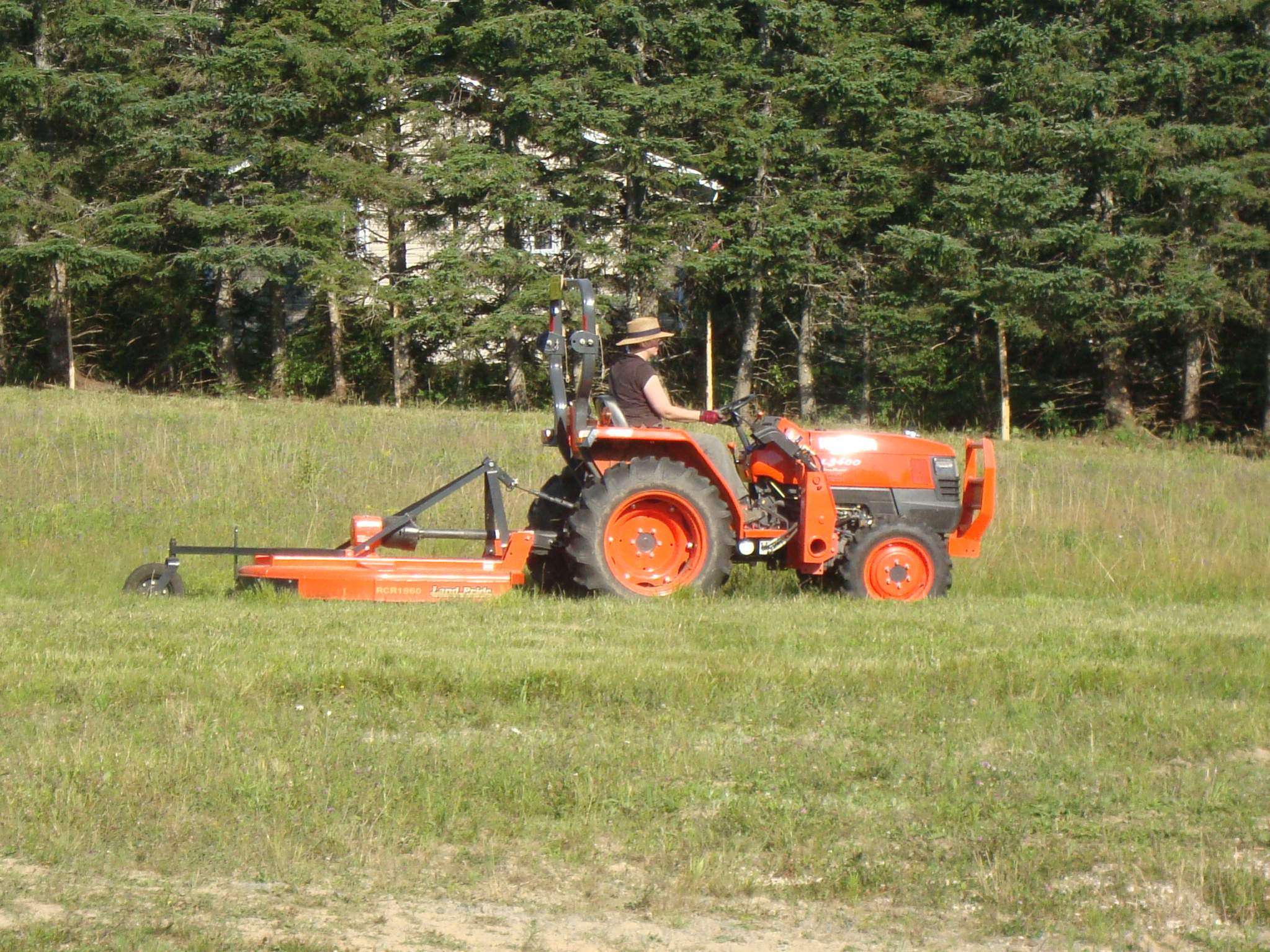

The guys are right in their setup advice.
You use the tail wheel height adjustment to set the height of the mower (8 inches from the ground, for example). Next you set the front of the mower slightly lower (maybe 7 inches above the ground) than the back, which reduces blade wear and the amount of power needed to run the mower. The front height is set by the height of the lower lift arms. Each time you lower the mower to cut, you're going to set the draft position control to the same spot.
The top link is used solely to lift the tail wheel. The more slack in it, the better the mower will follow the ground contour, but the less lift you will get when you raise the 3 point hitch. The top link connection to the mower should be flexible.
Land Pride has a good setup section in their manuals, and they're available online. Howse might be as well.
Sean
Sean
This explantion is spot on. Another item to insure smooth even cutting is leveling the mower from left to right. This can be done by adjusting one of your 3 point lift arms. With the tractor on a smooth flat service, make sure the gap between the ground and the mower is the same on both sides (Left and Right).

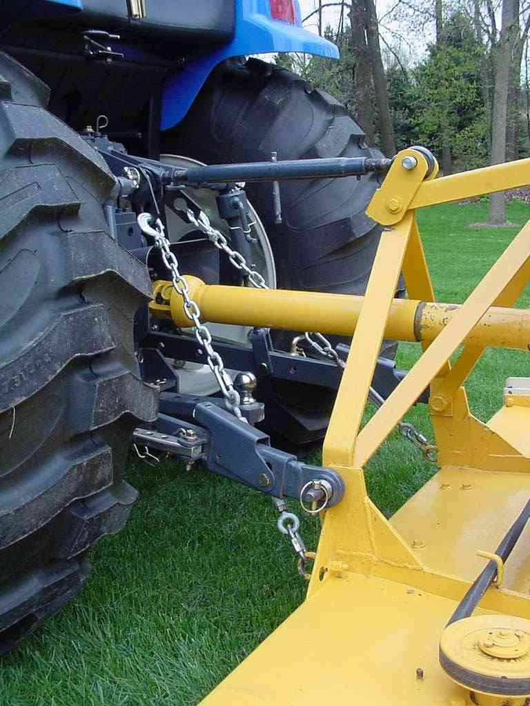

Use "check chains" instead. You'll get a much smoother ride for the deck and be much less apt to dig the front in or scalp. Kind of like having front wheels that are HUGE. See attached photo with a setup on a RFM, but rotary cutter is the same. No need to ever look back again or bother to control the height with the 3-pt lever.
That would work if the ground is fairly smooth.
Wouldn't work on rutty fields or areas with abrupt rises and depressions.
