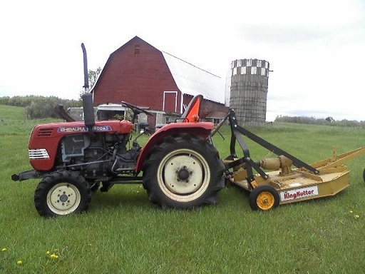

My first rotary cutter was powered by a 15hp Shibaura. It had a super short wheelbase, and really dug into the ground on uneven terrain. I put guide wheels from a baler on it and it sure made my life easier. They don't need to swivel.
That's a nice job!
