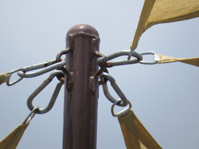

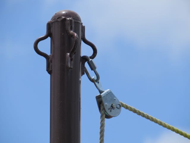

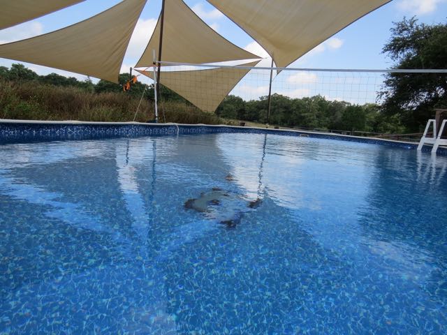

My swimming pool water gets too hot so I put up "sails" two years ago. This is the 3rd year same sails from Outsunny - about $25 each. Triangles 18' on each side. They work great. I do take them down in the Winter, but they have survived 50mph winds and many, many 100˚ days.

That's what I was thinking about and it's good to hear that they work. I'll do a little investigative work and run it by the wife. Looks like a winner.

I bought the triangles from 2 different places they are not exactly 18' (17'6"-18'6") so be sure to get them, measure them, and then put the poles or attachment further out to stretch the material. Pulleys or bungie cords work good.

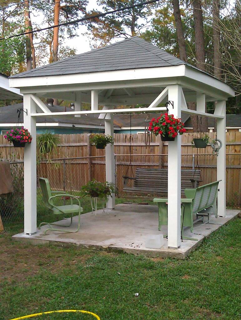

Pergolas are nice and they look nice and add value. They aren't rain proof but they provide more shade than you would imagine at different times of the day and give you places to put plants, string lights and mist systems if you get some serious heat.
Four posts and then cross beams and rafters. One weekend and you can have a nice setup.
I built this a few years ago for my old lady and she loves it. More involved than a pergola but I don't have any pic's of that right now. Added a hand built swing and misting system with lights and it's an oasis from the sun.
