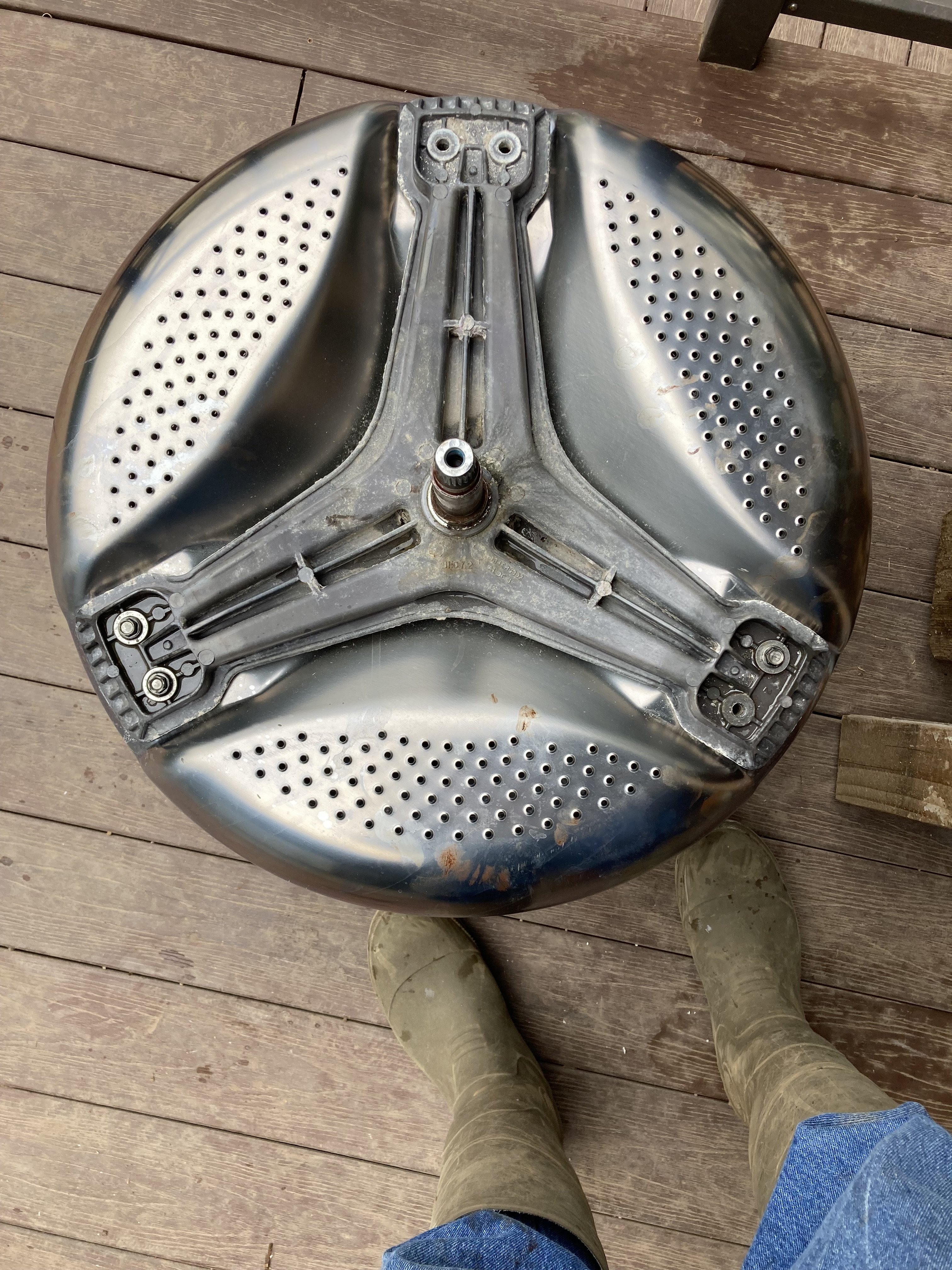

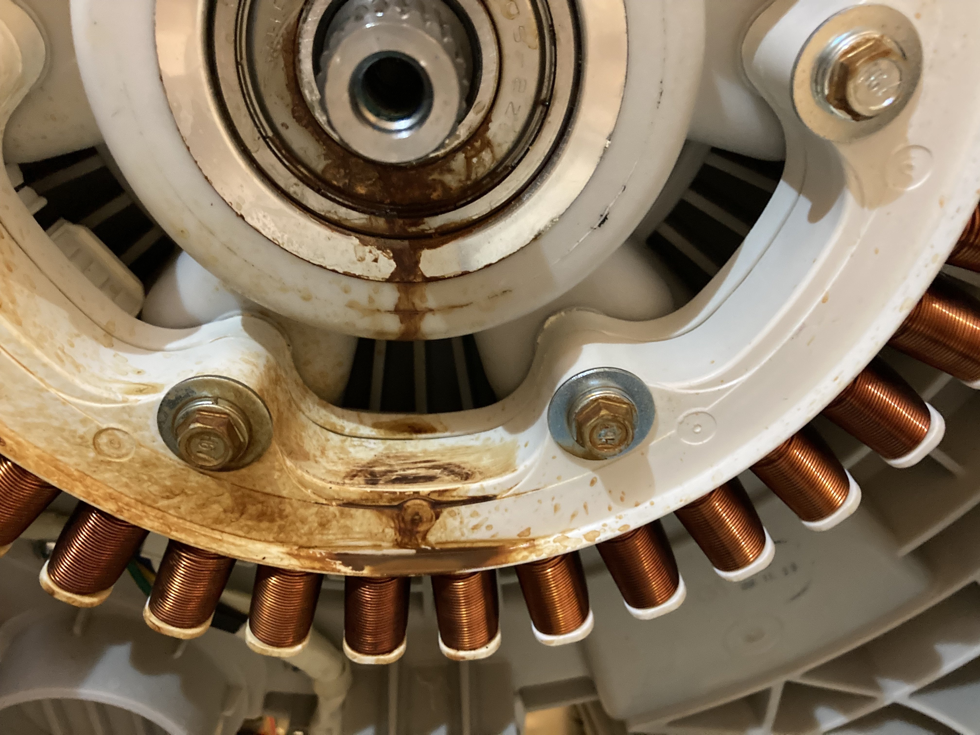

The front load design means that there is a rear seal to a bearing to the direct drive motor. In principle, one could do a preventative maintenance and pull the washer apart after 5-7 years to replace the seal before it leaks into the bearing, washing the grease out and causing corrosion, but is an almost complete disassembly of the unit. Unfortunately for me, when I did get it disassembled several of the fasteners that held the drum to the axle had corroded to the point that they died when I tried to unscrew them. The LG dealer was very good about taking all the parts that I had ordered back, so I was just out time and shipping.
I did see that in more modern versions LG had changed the fasteners to something more corrosion resistant. We will see.
View of the leaking seal;
But the items that did the repair in were the nuts/fasteners holding these three bolts in. You have to pull the arm assembly to replace the worn axle.
File this one under "Live and learn".
Parts to do the entire repair were about $220. I could have bought an entire drum assembly, after I got to this stage, but opted to punt and get a new washer. We are on LG washer #2, and happy with it as well.
