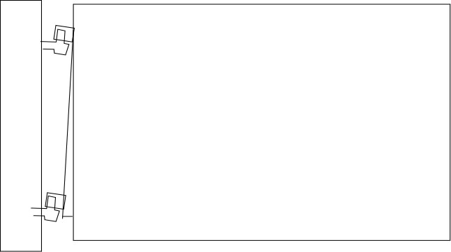

The bottom hinge pieces are the key Neil. I've looked online for the chainlink version and haven't seen one. Double doggone darn!
Here's the premise. If the bottom hinge is inboard of the swing side the gate will rise because it's going up as it swings out.
Fencemen have taken advantage of this principle for years. It's the best self closing mechanism available. Gravity doesn't wear out. So the most common usage is for gates around swimming pools. It's also nice to use when the gate has to open in a direction and grade is an impediment.
Doors in commercial buildings will use this principle as do refrigerator manufacturers.
But in your bump gate you need to open up and out both directions. This is only possible if the top hinge takes the weight. AND the bottom hinge is a fork and slot configuration.
Think of a hand rake for turning soil in a garden or flowerbed. The one that's at every hardware store for the old maids to use. It usually has three tines.
Let's remove the middle tine, cut off the handle. You now have a minature example of the gate side of the hinge.
Let's take a piece of plate and weld or bolt it to the post. We cut in two arc'd slots that match the tines on your fork er uh gate hinge.
When the gate is opened the inboard side of tine--gate pin will pick up the weight of the gate and the outboard pin will swing out of it's slot. And of course vice versa when the gate is opened the other direction.
The offset is critical. If it's too far out of line it will be hard to open and come swinging home with a vengence. If it's not offset enough the gate won't close.

From the picture at Bump Gate there are 2 separate chains holding the gate up. The chain on the opened side would be slack and the chain on the entry side would be pulling the gate closed.
I would definitely recommend using pipe. Wood will warp over time because of the weight of the gate.
There is also a note about welding a couple of pieces of pipe at the bottom of the upright to keep it from turning in the dirt. I would think that 4 pieces 90 degrees apart would be better. The pieces that are parallel to the gate would help to keep the post from sagging toward the gate and the pieces perpindicular to the gate would keep it from leaning from side to side.
The biggest factor against using a lightweight panel style gate is that the wind might keep it from closing or could even possibly let it blow open in a heavy gust. The panels catch a lot of wind. A pipe gate doesn't catch as much wind and is heavy enough that the wind will not move it.
If you wanted to use a panel gate you could use a "rising butt hinge" made like the hinge shown on the drawing. You put a butterfly latch on each side with a roller or eye bolt on top of the fence post, set posts on the drivers side of entry and exit of the gate, put a roller on top of that post, and run some sash chain from the latch through the rollers and down to a weight on the end of the chain so you could reach out and pull it to release the latch as you pushed on the gate.

The Aussie gate loooks like a pretty clever design with these key features:
/forums/images/graemlins/wink.gifGravity operated self closing. A simple solution only touched on so far is to have the hinge axis leaning slightly toward the gate when closed. That allows the use of plain hinges.
/forums/images/graemlins/wink.gifA spring loaded bump latch mechanism that doesn't unlatch until the spring has enough energy to open the gate, taking most of the guesswork out of driving speed.
/forums/images/graemlins/wink.gifHold-open latches that release after a set time. Maybe they use a spring with heavy damping in one direction like you find on a cheap door closer. The energy of the swinging gate closes the latch and compresses the spring. The adjustable damper then slowly allows the spring to open the latch. The latch might be a kind of pivoting c-shaped hook like you see on car doors.
