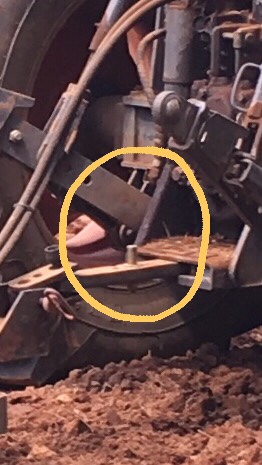

I have a similar set up with my M9540. I put a bolt (grade 8 with a bushing over it) through one of the holes in my drawbar and run the chain behind it. If the drawbar isn’t in the tractor a chain should fit where the draw bar goes.

Explain running the chain behind the bolt in the drawbar. I can't visualize what you mean.
   / How do you chain down your 50 HP tractor for transport? #27
There are two 11/16” holes in my drawbar about half way to the tractor. I took a 5/8” Grade 8 bolt around 5” long and put a lift arm bushing over it. I think the bushing is a Cat 0-1 bushing. Stick it in one of the holes and tightened it up. You can put a washer on top of the bushing and it makes a little channel for the chain to sit in.
Chain is pulling down and backwards so it can’t come off unless the chain gets loose. I haul it with pull type equipment attached so a clevis wouldn’t work for me.

#28
Thank you. I often have an implement as well so understand the problem.
It’s not a great picture but here is the setup.
