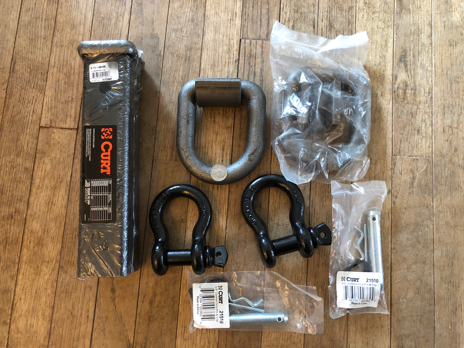

So I got some goodies in today and spoiler alert, I may have gone a bit too large on the D Rings lol
Those are the unbreakable shackles also, I was concerned they were gonna be too large but they are not, they will work great.
Idk about the D rings, I will either send those back or use them as a tow point or something. Sending stuff back is such a hassle lol.

What a surprise, China lol
Most the Curt stuff is stamped USA
If you keep them you will find a use for them.

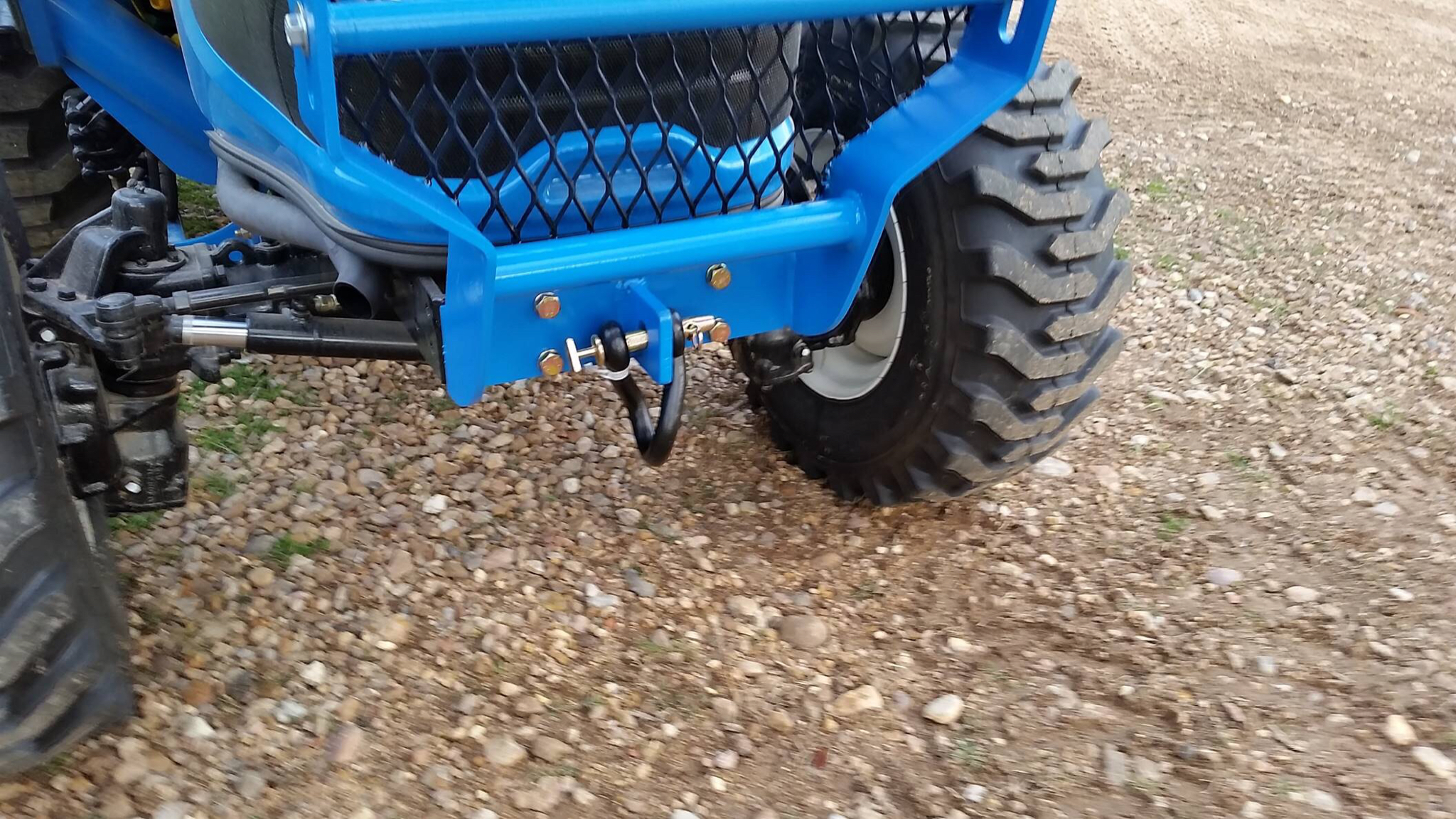

   / How do you chain down your 50 HP tractor for transport? #97
I still might try and use one on the front of the tractor, idk about the other. I like the idea of 2 D-Rings on the front vs two, but the ones I have are rated for like 45k lol, only prob would be is if what they are welded to fails.
I thought about using the other on the front of my truck as a anchor point since it’s 2wd but even then the bumper would be in way of the frame. So idk.

   / How do you chain down your 50 HP tractor for transport? #100
D-rings make excellent paper weights but, not much else IMHO.
