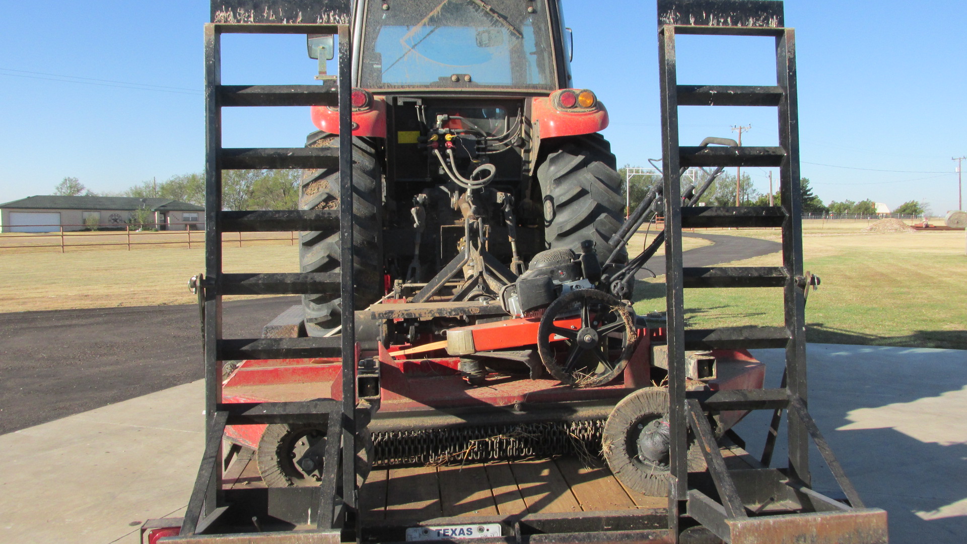

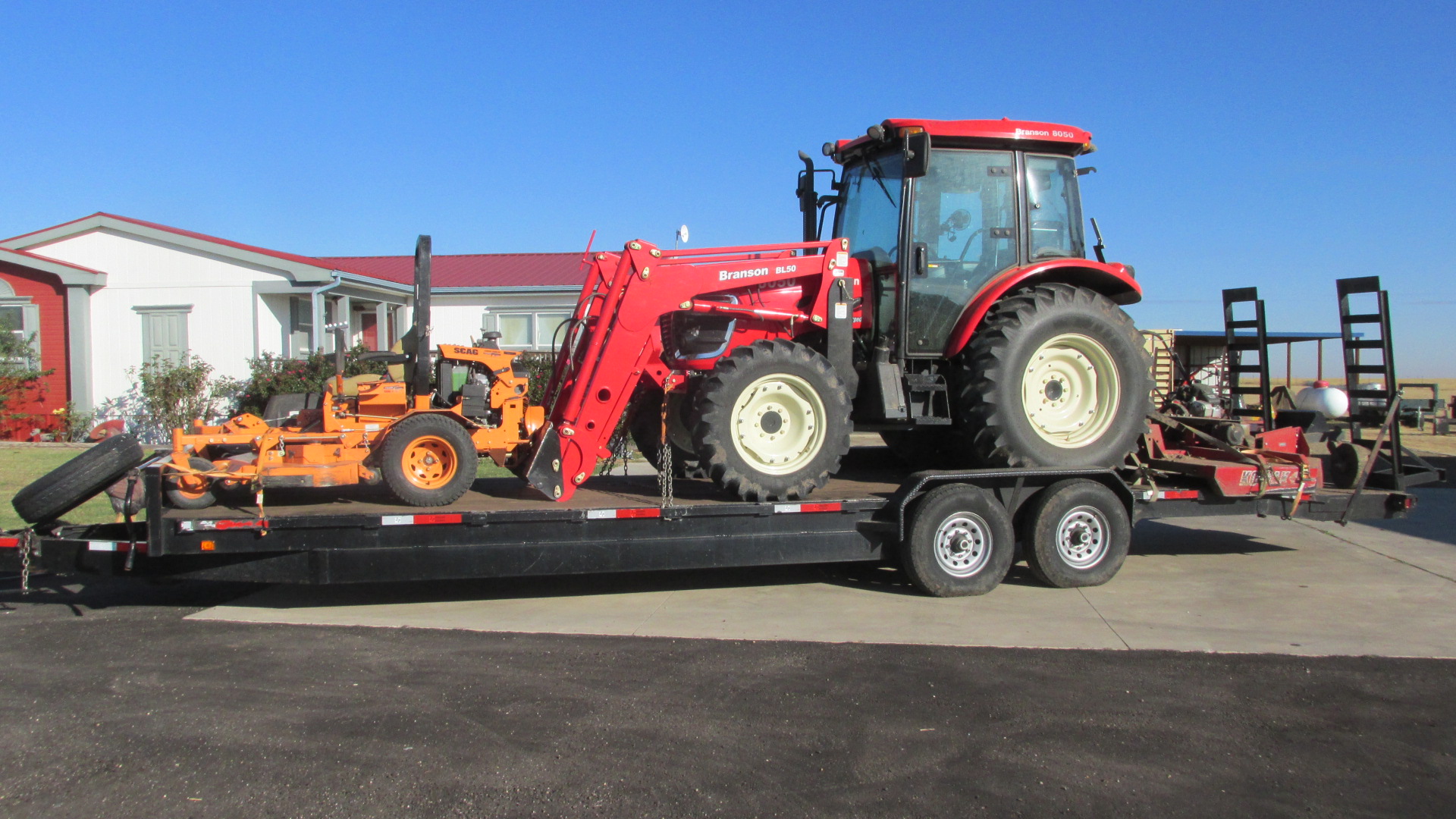

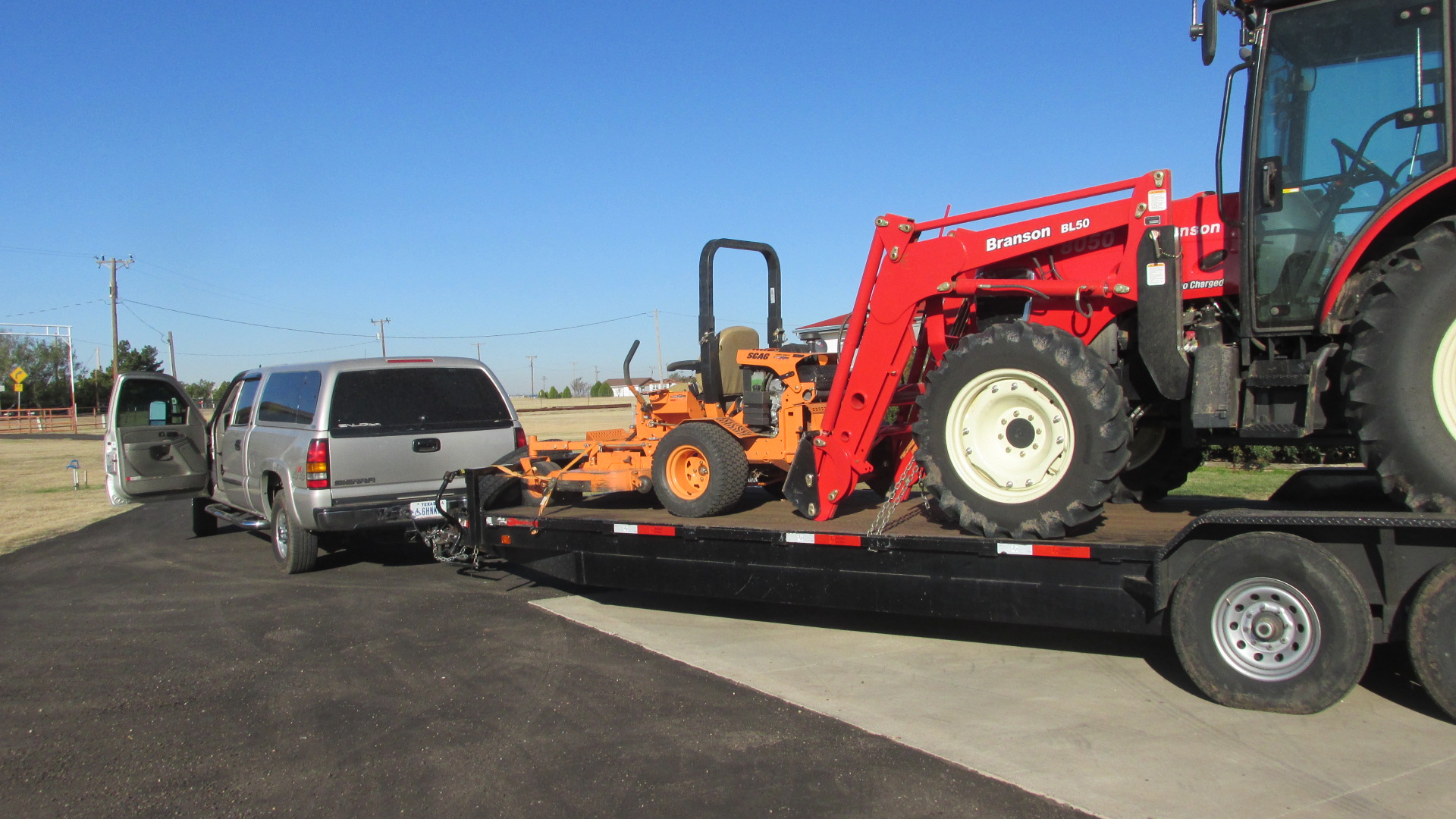

Getting ready for a day of mowing.
   / How do you chain down YOUR tractor? #59
That looks like a awfull PUSH / HAND operated device on the back of that nice tractor with CAB. Do you just tie it to the side of the tractors mower and drag it down the fenced line ?
