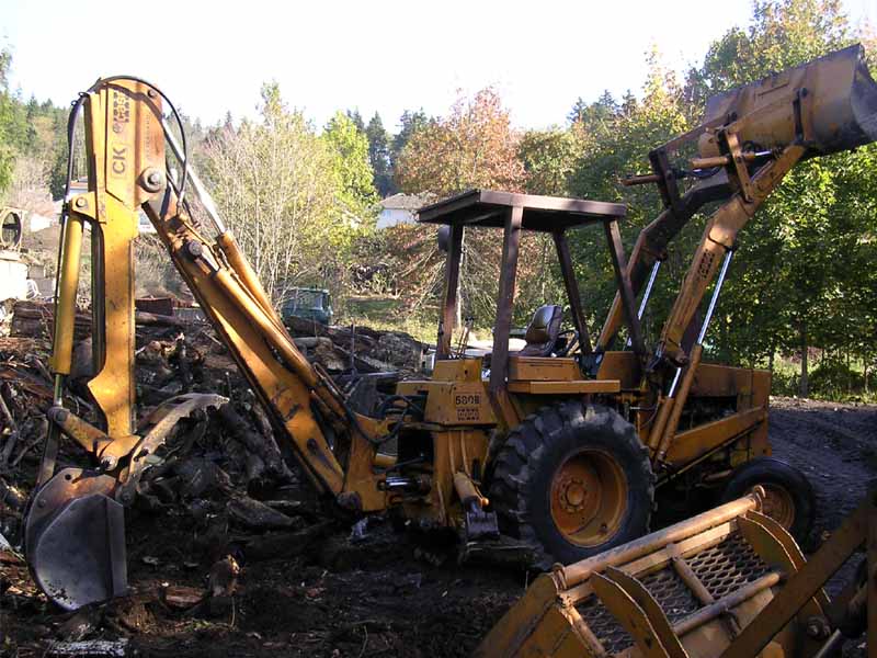

   / How do you excavate/remove tree stumps?? #26
Here's what we use. /forums/images/graemlins/grin.gif
Blake
WA
