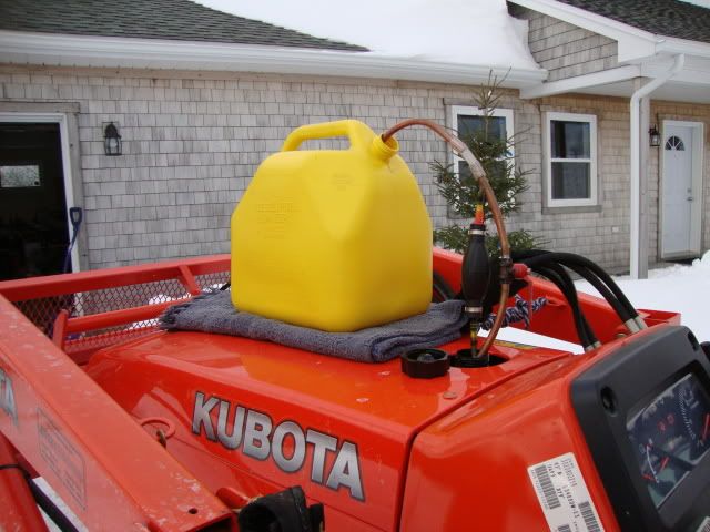

ChillyAfter nearly slipping off a snowy tire with an open fuel jug a couple of times said:
http://i168.photobucket.com/albums/u179/paws807/tractor/DSC00224.jpg[/IMG]
You slip the long end into the fuel jug, stick the short end in the tank. Close the valve, squeeze the primer bulb 3 or 4 times until it fills with fuel, then open the valve and wait about 5 minutes for the can to empty. If the tank won't hold the full can, simply close the ball valve to stop the siphon action.
The hardest part is lifting the 5 gallon can up to the hood, and I can manage that with no problems. It was the balancing act holding it waiting for it to empty that was tricky.
I've probably transferred 300 gallons of fuel with this so far, and it works like a charm.
Sean
I would like to get away from lifting the tank and placing it on the hood. A gallon a minute is too slow for me, I bet you can do the same with a much larger hose and cut your time in half.
I like the idea of the boat transfer pump but lifting the wet pump hoses cables out of the tank I think will make a mess over time.
