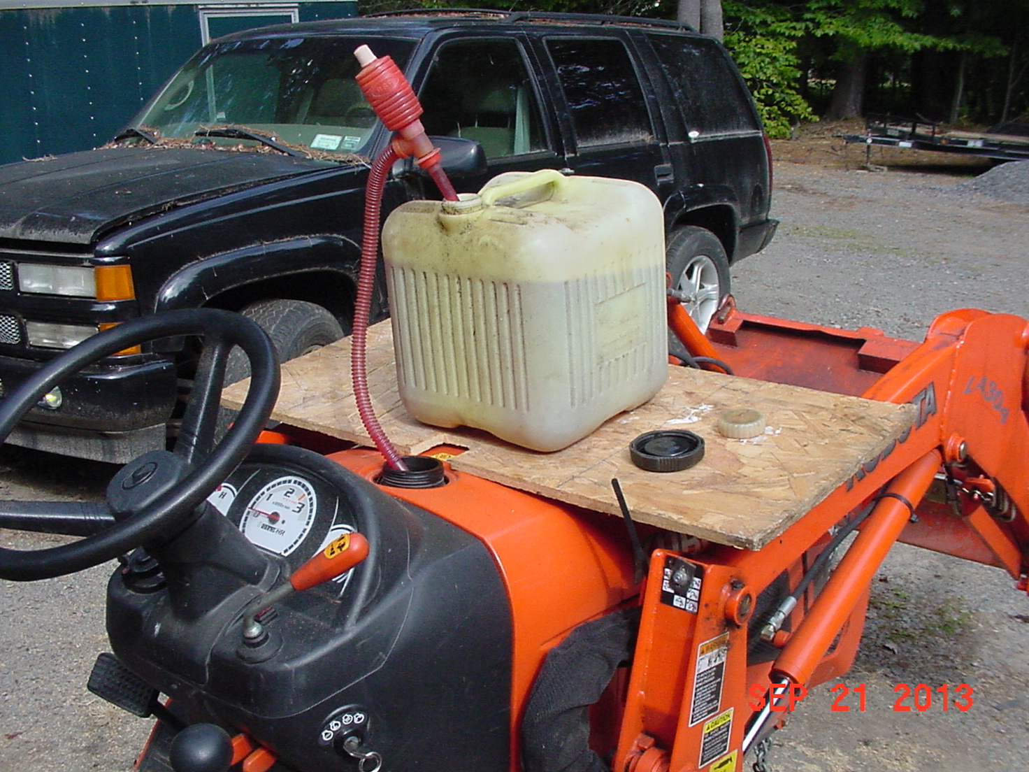

For the B I have been using a five gallon jug and a squeeze siphon. I put a piece of scrap wood between the boom arms position the jug and siphon directly into the tank. Clean and no spilled fuel you just have to keep an eye out not to overfill if the tank is not near empty. For the BX I fill two gallon jugs and use them much easier to lift and the tank is smaller anyway. Made a fuel run today here is the B getting a fill up. When the fuel gauge gets around empty it takes the whole five gallons.

I've used that same method only the gas eats the plastic up after a while.
   / How do you fuel your tractor (logistics, not finding the cap to the tank)? #106
Why didn't I think of that?? I've always just used a 5 gallon can, and it's heavy for me (a lot heavier then it would have been 40 years ago when I was 32). Thanks.

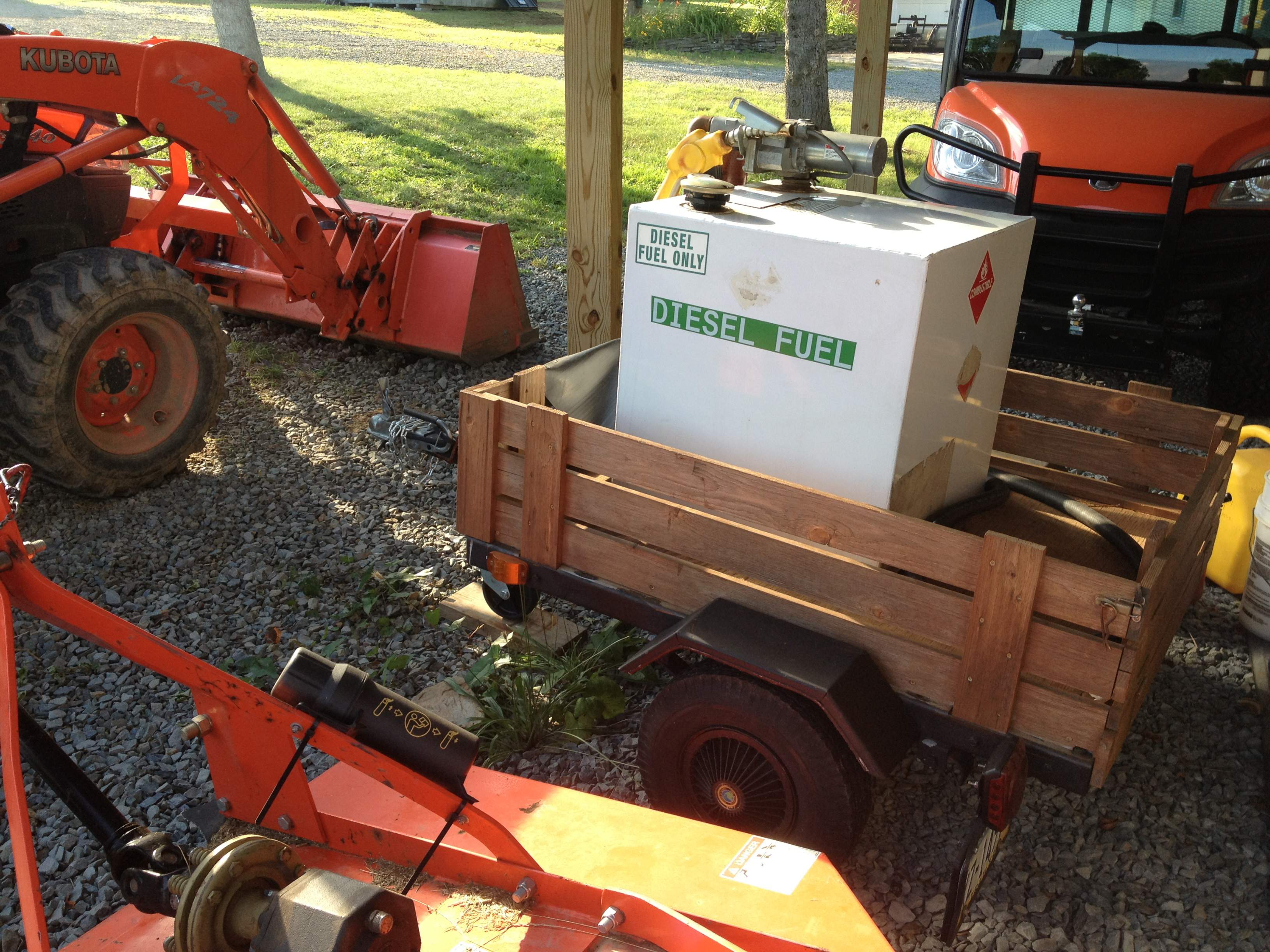

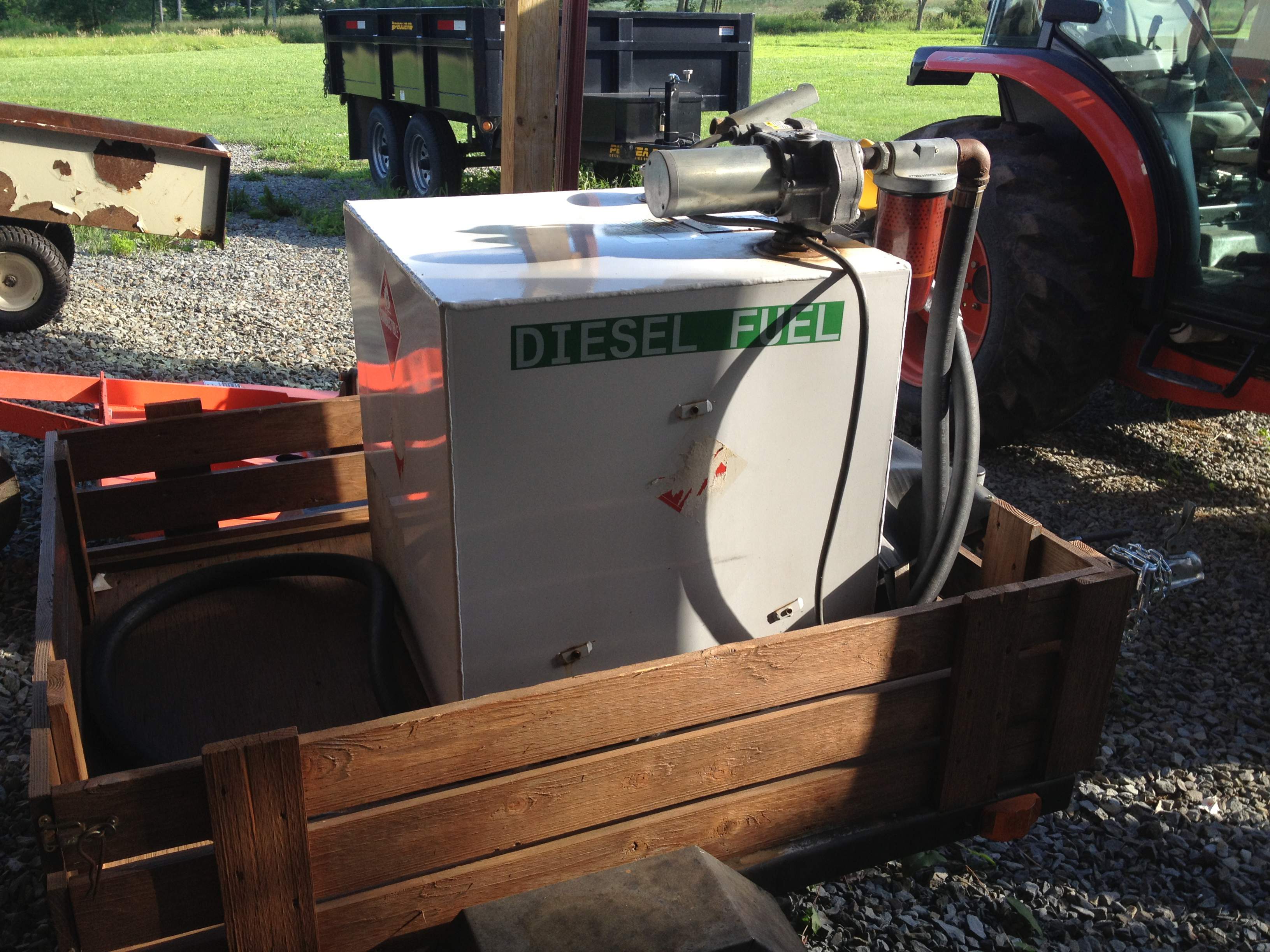

Something I built on a HF small trailer frame. Battery rides in front of the 50 gallon tank to power the pump. Easy to drag to the gas station to refill with off road diesel. Usually 2 or three times a year. Easy to tow. Moved easily with the RTV1100
