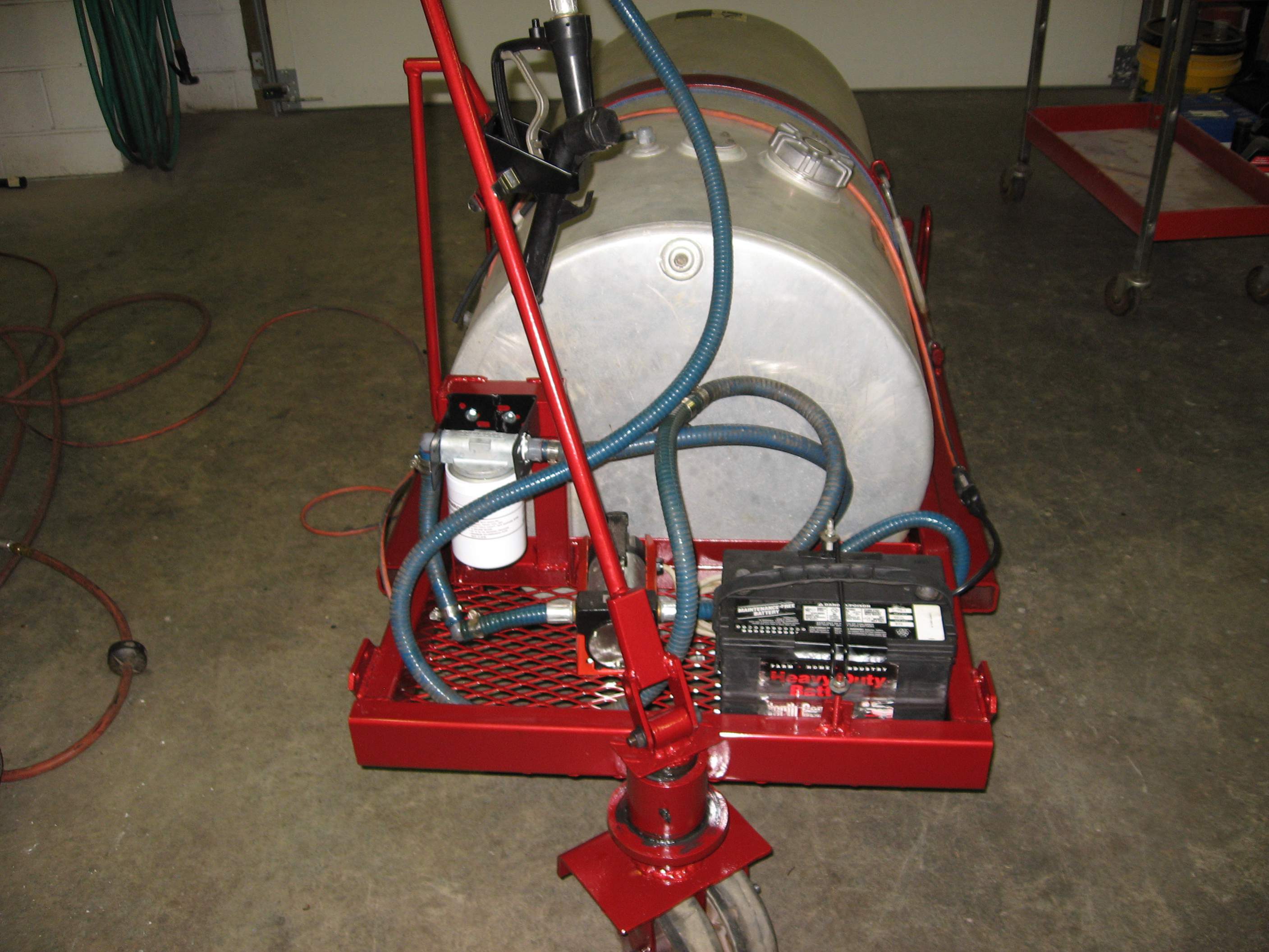

With This

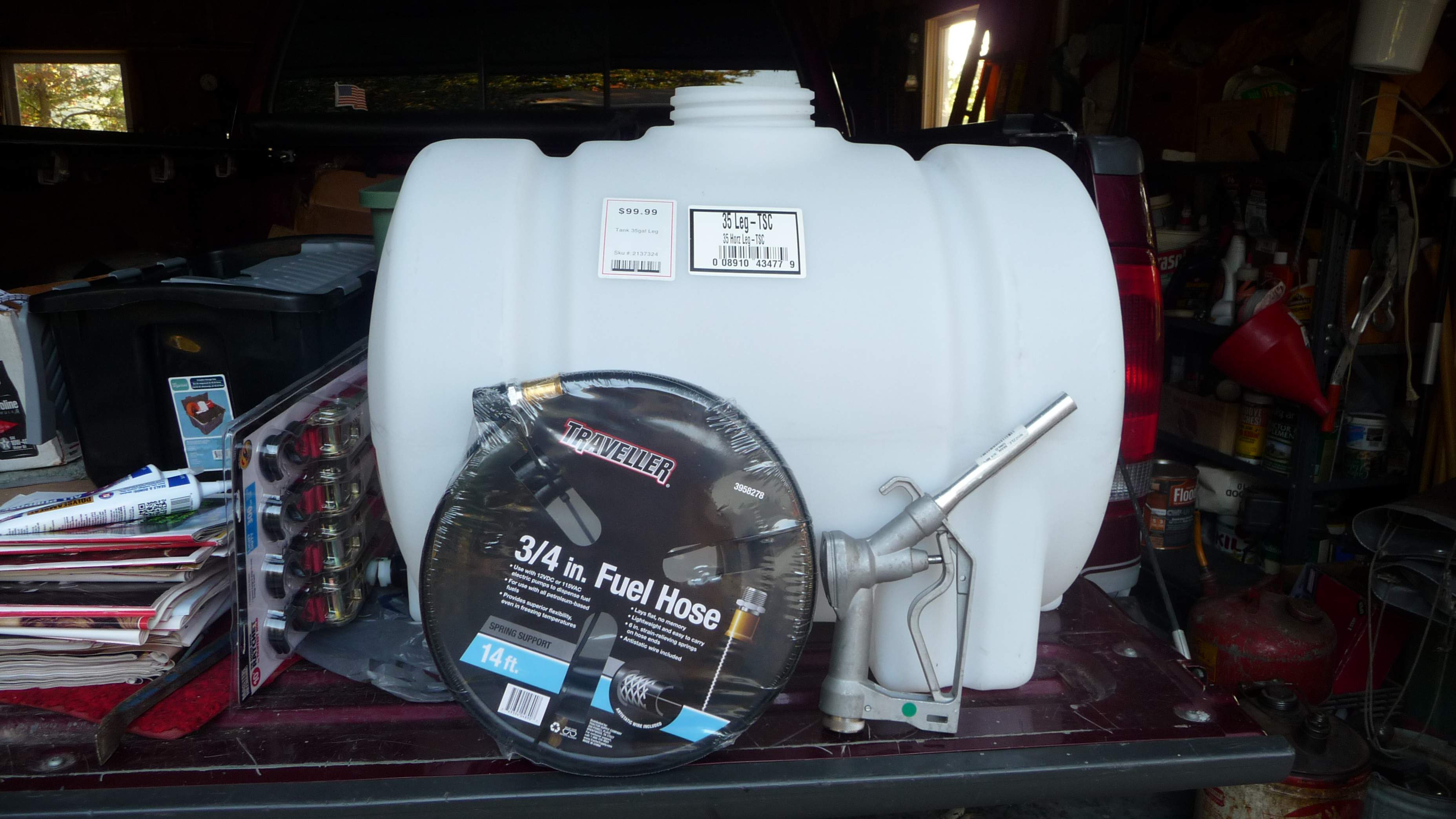

Well, there are only 24 pages to this exciting topic so why not more !? P1200661.jpg This is what I did. TractorSupply (and others) sell a 35 gallon sized white polystyrene tank normally intended for insecticides. Works just fine for diesel fuel. The outlet fits standard 3/4" pipe threaded gasoline hose hardware. The neat thing is you can cart this around in an old station wagon or pickup truck or what have you. Fill it with the equivalent of 6 or 7 cans of fuel. I have 2 modes of operation: One is gravity feed which means just park the tractor and the tank carrier in positions that facilitate gravity feed. With a 25' hose that is usually not hard to find. Another mode is: drill a hole in the large top filler cap of the tank. Install a bicycle valve there. When you are in some marginal gravity circumstance, just add some air pressure to the tank and feed the fuel under air pressure. BE CAREFUL HOWEVER ! The tank will not stand a lot of psi !!! It is fairly handy that the tank cap has a relief valve with no gasket built in to it. In effect that leaks just right and prevents ever blowing up the tank. :)
