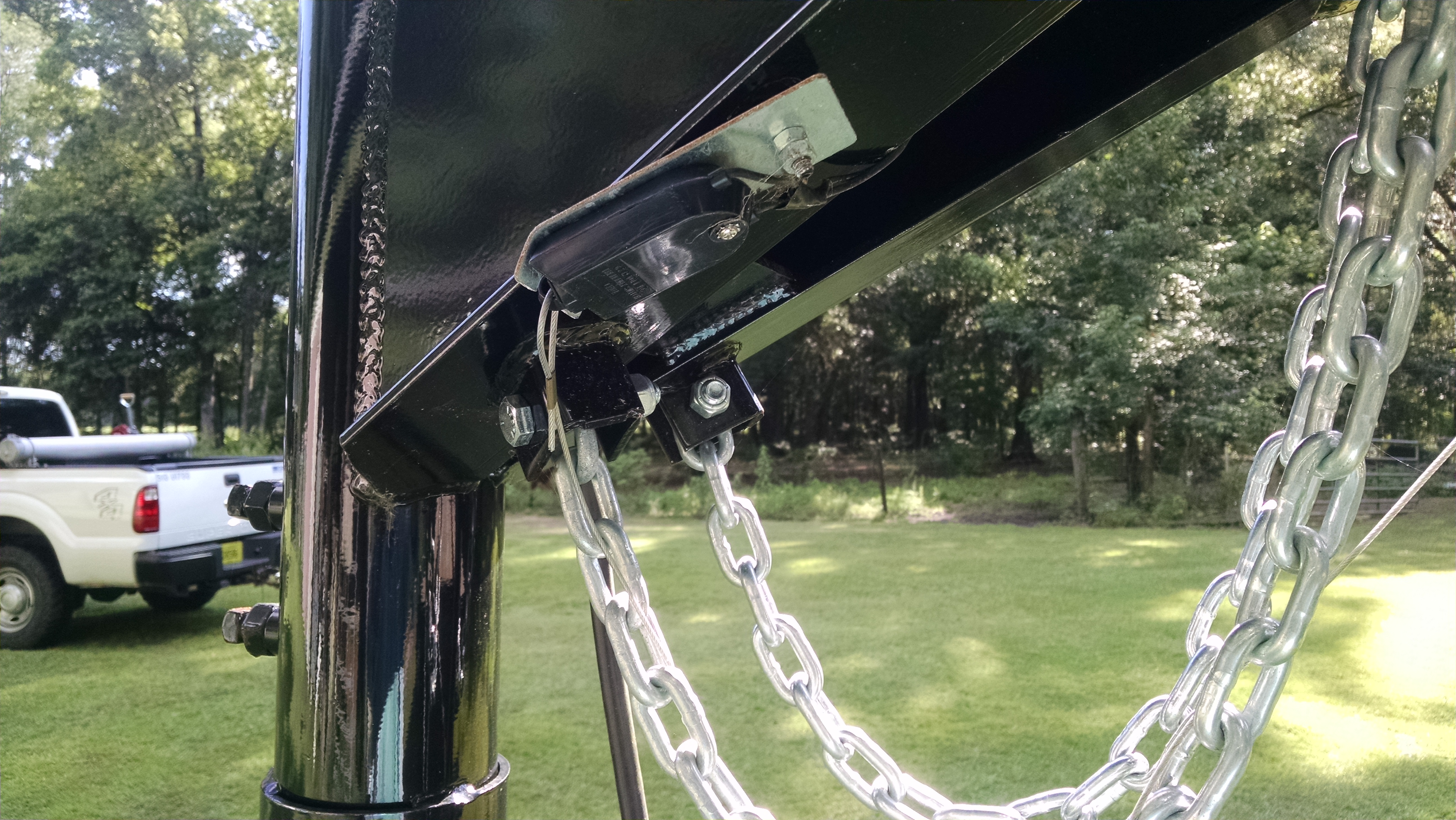

I just looked at the Gooseneck trailer site gooseneck.net and every photo of their trailers shows chains hanging from them. Dollars to doughnuts your trailer has attachment points for safety chains in the neck of trailer near the down tube, just no,chains hooked up.
Well I double checked this afternoon when I got in and there are no/none/zero attachment points for chains on my trailer, I'm sure I could weld some on but it never had any from the factory.
FYI, The verbiage I read pertaining to Texas law says you cannot weld the chain. In your state, YMMV.
10-4 I will probably do something about like what is in this picture, this is my fairly new flatbed deckover trailer and I like how they did these safety chains on it, so when I get ready to put them on my old stock trailer I will probably fix me something similar to what the picture shows.
