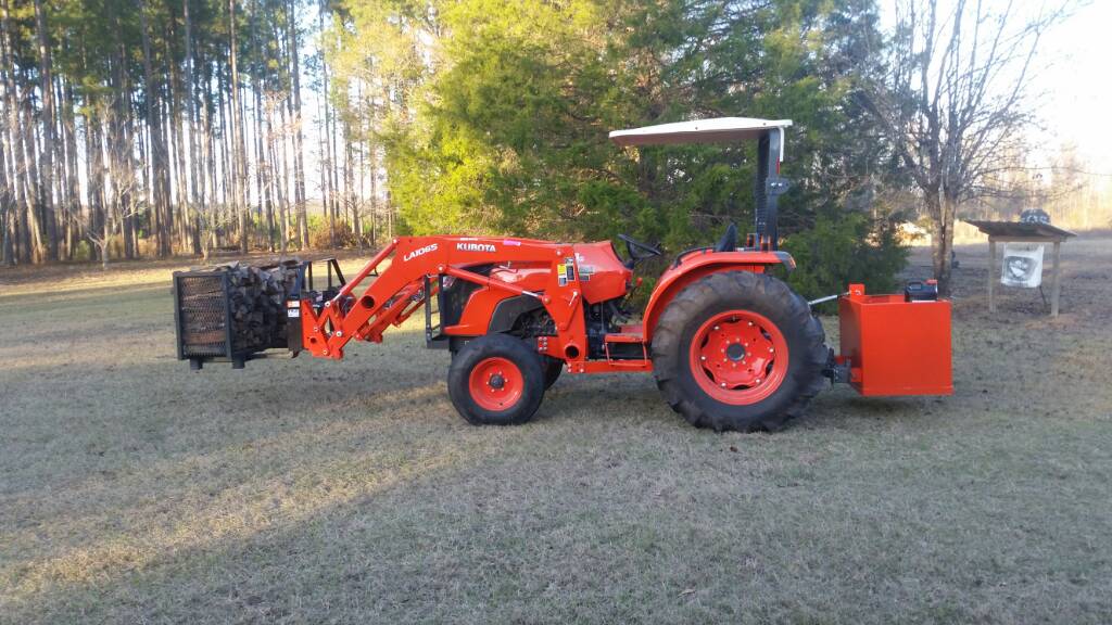

Loader is on I started it at 4:15 and used it with the pallet forks to unload the bucket at 5:45. Was gonna snap a photograph but my phone died. Nice but seems super jumpy gotta play with that some more and get her lubed up.
Have you run the cylinders back and forth to the end of their travel a few times to bleed them? Having a slug of air in the cylinders can cause that and it usually takes 5-8 cycles back and forth to the end of their travel to push it all out.

After you cycle the air out of those cylinders it would be a good idea to check the hydraulic fluid level. They could easily take a couple of quarts to fill up.

No I haven't I will when I get home as soon as I get it greased up.
I picked up 2-1/2 gallons of UTD while I was at the dealer yesterday already planning ahead.

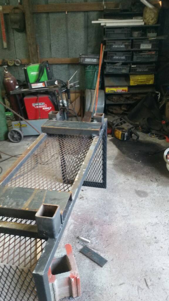

OK so admission of guilt I found out this afternoon why it was so jumpy, somehow we overlooked hooking up one of the tilt cylinders last night and that was causing the issues. Got that straightened out greased everything up real good and topped off the fluid then the first thing I did with my new loader is add fork pockets to the firewood rack we keep on the porch and go get a load of wood.
   / How do you loose a 1500lb loader? #38
Glad it's working out for you!!!! Don't worry about the "Stupid Human" trick. Every one of us have done something similar!!!!! Thanks for posting the pics. :)
