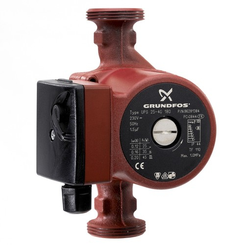

So, I am not the smartest person. I thought my problem was the hot water in the pipes cooled just sitting in the pipe with no use. Then, you turn on the hot water and all the cooled water had to flow thru the pipes until the hot water in the tank gets to the spigot.
The water flow is limited by the faucet.
How does a pump help? Does the pump continuously re-circulate the water so it’s always hot in the pipes?
Sorry if this is a dumb question.
MoKelly
yes, it continually cycles hot water. its a micro 1/15th hp pump (as far as i recall). looks something like this . it requires a 3rd pipe (hot,cold,recirc) to be plumbed to furthest point in system at rough plumbing. mine has a built in timer face, so it starts about 1 hr before i wake up , than shuts down about 10 pm.

As far as circulating water back to the water heater quite often a 1/4 inch line from the furthest
hot water faucet will create a thermal siphon flow loop and circulate water without a pump.

and since my furthest bath is about 60 feet from water heaters, the circulation system lets us have instant hot water at any faucet. Otherwise I’d have to wait minutes for water.

Yes; they are a couple of ways to do it. One is to plumb in a return line from near the far end of your hot water run back to the cold water inlet on the water tank and then the pump (we use a little Grundfos) pushes water around the line continuously. We have our on a timer. The other way is to get a thermal bypass valve or sensor valve(s) in addition to your pump, but not plumb in a return line. The sensor valve is a heat swelling plug between the hot and cold lines. When it is cold, it lets the cold "hot" water bleed through to your cold water line. When warm water gets there, it swells shut. You can put in several throughout your house to have instant warm water at distant faucets. They do wear out, but we have had ours for over a decade.
We love it.
We also replaced the anode rod with an electronic version that doesn't wear out and doesn't need annual cleaning. I highly recommend them if your water isn't super soft and you aren't in the habit of frequently cleaning your water heater anode rods. We bought ours from Powered Anodes - Water Heater Rescue Our water heater lifetime has more than tripled, and still counting...

Plumb the return line with PEX. Easy DIY. Hotels and Motels typically have circulating HW so roomers don't wait.
Some guys use WHs w/pumps for boilers to add baseboard heat for additions. Some will use a thermal siphon. That's done by teeing a HW return into where the drain cock is. (NOT the T&P) It's less effective than a pump, flows continously, and as always we want to wrap our HW lines wherever we can reach them.
btw, Best trick I heard to save waiting with a 'remote' upgrade is to put a 1 1/2 gal or small tankless near the point of use but plumb the input from the main HW line. You get hot right away and when the input from the main source catches up the remote will cycle off and flow through.
