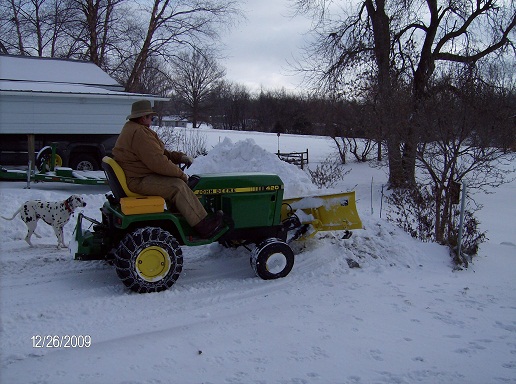

For my garden tractors, I just jack the wheel up & roll the chains around the tire. I use two pair of pliers to pull the latch as tight as possible, that's as tight as needed!
Big tractors & trucks, we laid the chains out & pulled the vehicle onto them. Fortunately, the fire trucks we had to chain down were on a concrete floor! ~~ grnspot110
