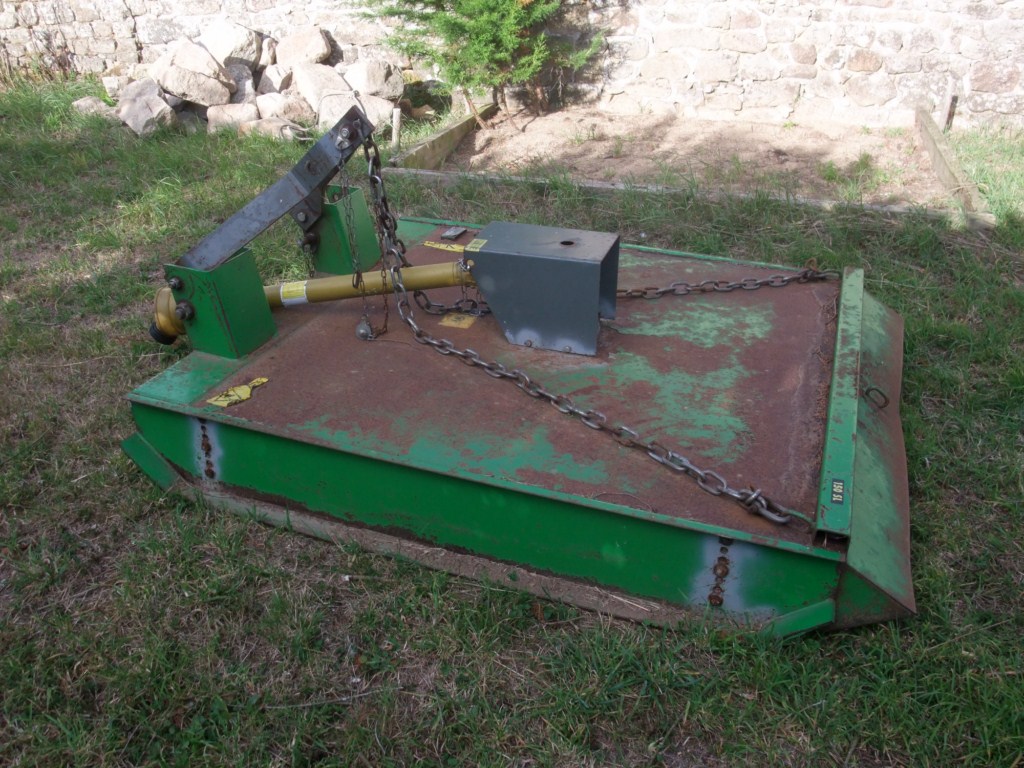

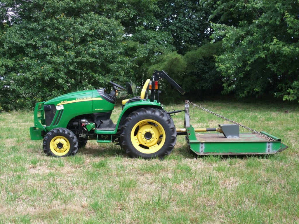

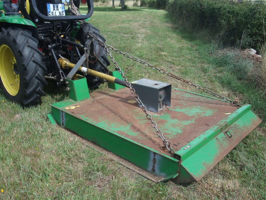

The PTO shaft I use for my brush hog has a black ring like that to free it from the PTO but you need to pull it away from the tractor to disengage it, not push it towards the tractor. The other side has the standard button to press.
