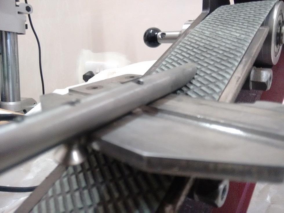

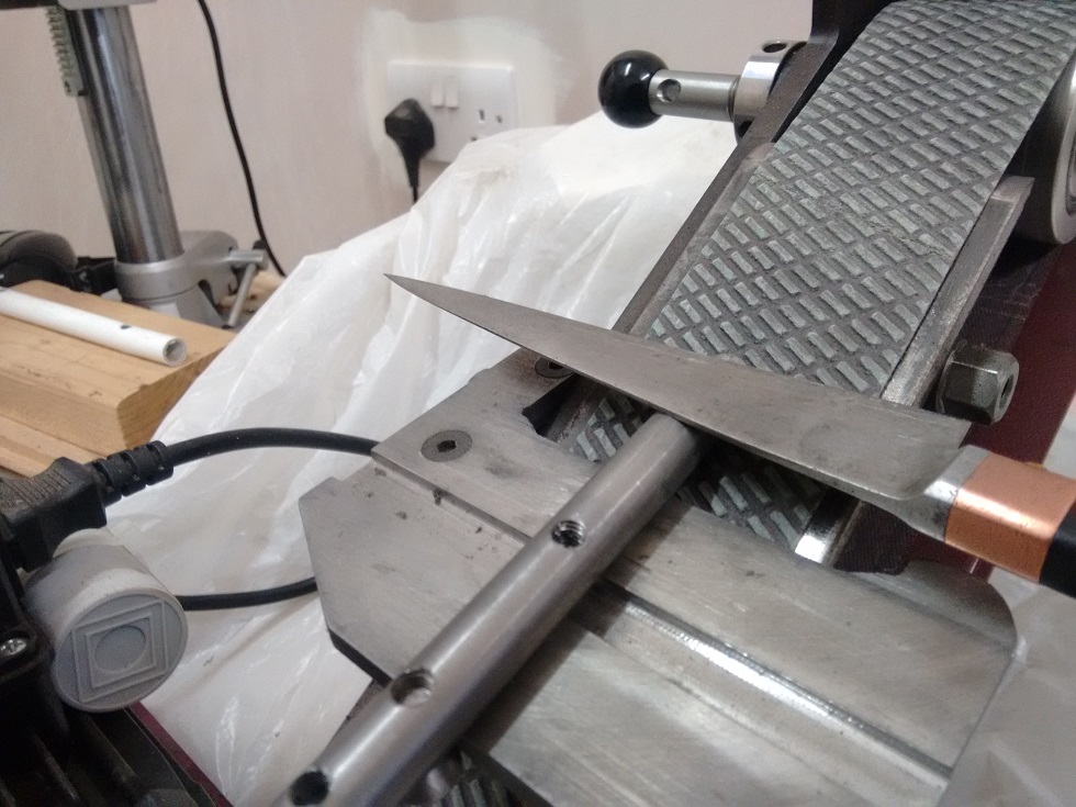

Married for almost 40 years and still haven't found a way to deter my wife from sometimes cutting things on a ceramic plate instead of a chopping board. Instead of a long time with the steel, I now use a small belt sander with 3M Trizac belts to restore an edge.
With this I found I was struggling to keep a perfectly consistent angle and the clamps they sell for the purpose look slow to use. Instead I made a little jig to help me "feel" the correct angle and remove only the minimum amount of metal.
