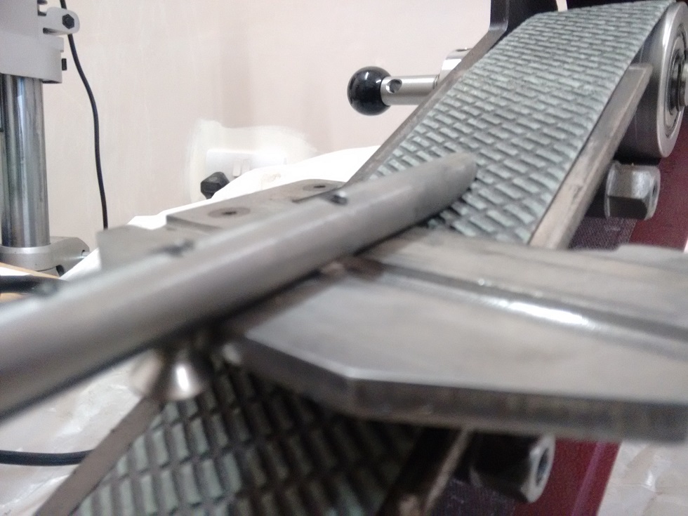

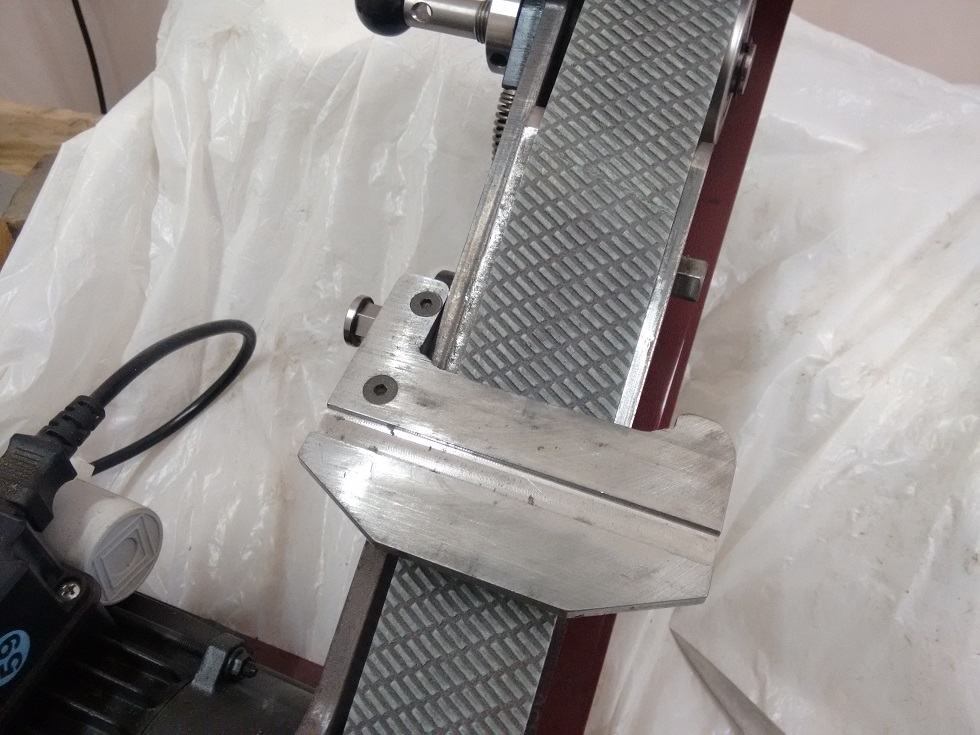

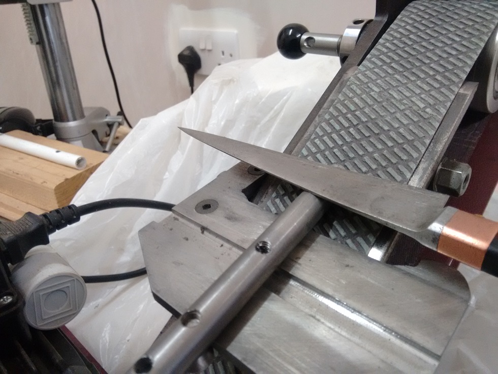

Married for almost 40 years and still haven't found a way to deter my wife from sometimes cutting things on a ceramic plate instead of a chopping board. Instead of a long time with the steel, I now use a small belt sander with 3M Trizac belts to restore an edge.
With this I found I was struggling to keep a perfectly consistent angle and the clamps they sell for the purpose look slow to use. Instead I made a little jig to help me "feel" the correct angle and remove only the minimum amount of metal.

A steel is not meant to "restore" and edge, it is used after the knife has been sharpened to align the edge, it really doesn't remove metal. Procedure is.
Sharpen
Steel
use
Steel again every few uses will usually keep them scary sharp for a months in the average kitchen use.

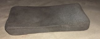

This stone was my Grandfather's and I'm 76 so we can just assume it's about 100 + years old. I've had several in my life but this one is a favorite even though it appears to be worn out from sharpening knives to castrate pigs, calves, butcher chickens to skinning squirrels and raccoons for a century. Coarse side, fine side and in one area the coarse has worn through to the fine side but it's still a good Ole stone.
When the knife angle gets too steep, I have a nice old bench grinder with a fine stone at about 1,725 rpm that corrects the angle quickly.
