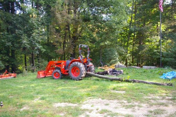

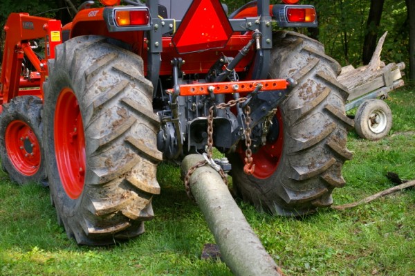

I pulled a few aspens down but I have really steep inclines.

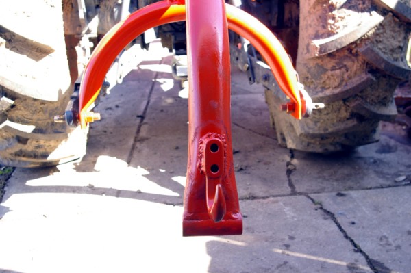

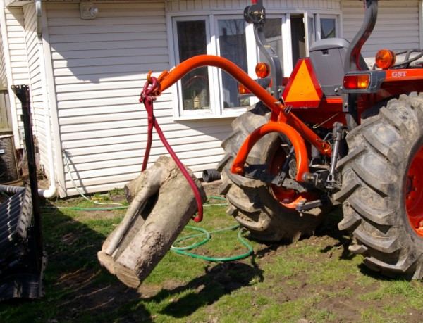

The most important thing is to make sure your tractor has enough heft so the logs don't move the tractor around if you have downhill slopes etc. ATV's are quick and low impact but if coming down a hill with a 800# tree you have to remember the size of those brake pads!!! I use my ATV and a skidding plate I built for the level stuff. The tractor is much better as to get the log quite high off the ground eliminating a lot of dirt on the bark in the skidding process. The chain on the chainsaw definitely stays sharper longer with less dirt... I also welded a hook on my post hole digger and hang some tongs off of it and I usually don't have to get out of the seat to hook onto and release the log. I figure the posthole boom has more strength than the TSC boompole..
