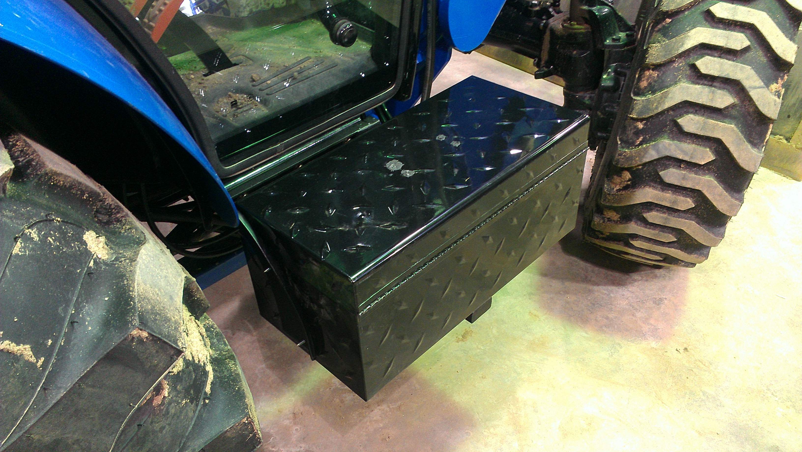

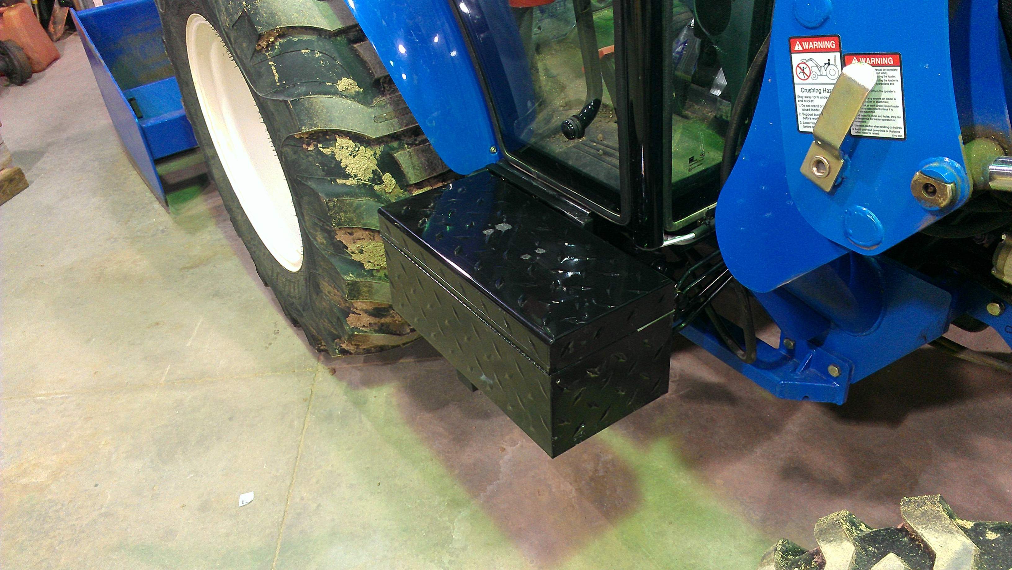

I have found that taking some rubber fuel line hose cutting a slit in it lengthways makes a decent lip on sharp metal. Smallest diameter you can get while maybe difficult to cut with a fresh razor blade box knife, will grip pretty darn well.
   / How do you store you logging/tow chain? #162
Yes, but every time he pulls the chain out the rubber hose will pull off. I'm thinking some sort of "U" channel metal that gets pushed on and tacked in place.
   / How do you store you logging/tow chain? #163
Maybe remove it from the tractor and run the edge through a bead roller.?
Terry
   / How do you store you logging/tow chain? #164
Thoes are all good ideas... fuel line with some tie wire will likely do the trick. Will drill 1/8" holes about 2" apart just below the bottom of the installed split fuel line. Unless I can fine something else... in which case I'll let y'all know.
   / How do you store you logging/tow chain? #165
Finally rigged up a chain tube on my own tractor this evening.
   / How do you store you logging/tow chain? #166
To fix that sharp edge I would suggest door edge moulding from an auto parts store or Walmart. It has adhesive in the channel to hold it on. Cheap and easy. Comes in black or chrome.
   / How do you store you logging/tow chain? #167
Worthb: door edge moulding was the first thing that came to mind... but the name of the company I work for is ThistleDew (this-will-do) Farms... we make do with what's on hand... free/used/recycled materials for most projects is normal. I'll come across something suitable to use before long.
Thanks for the idea though....
   / How do you store you logging/tow chain? #168
What would work good for the sharp edge would be some inside door molding from a mid 70's Datsun pickup (and probably others as well) It is U-shaped with a metal core inside that can be crimped down with pliers. Looks like cockpit combing from a biplane, might be able to scrounge a length up at a scrapyard.
