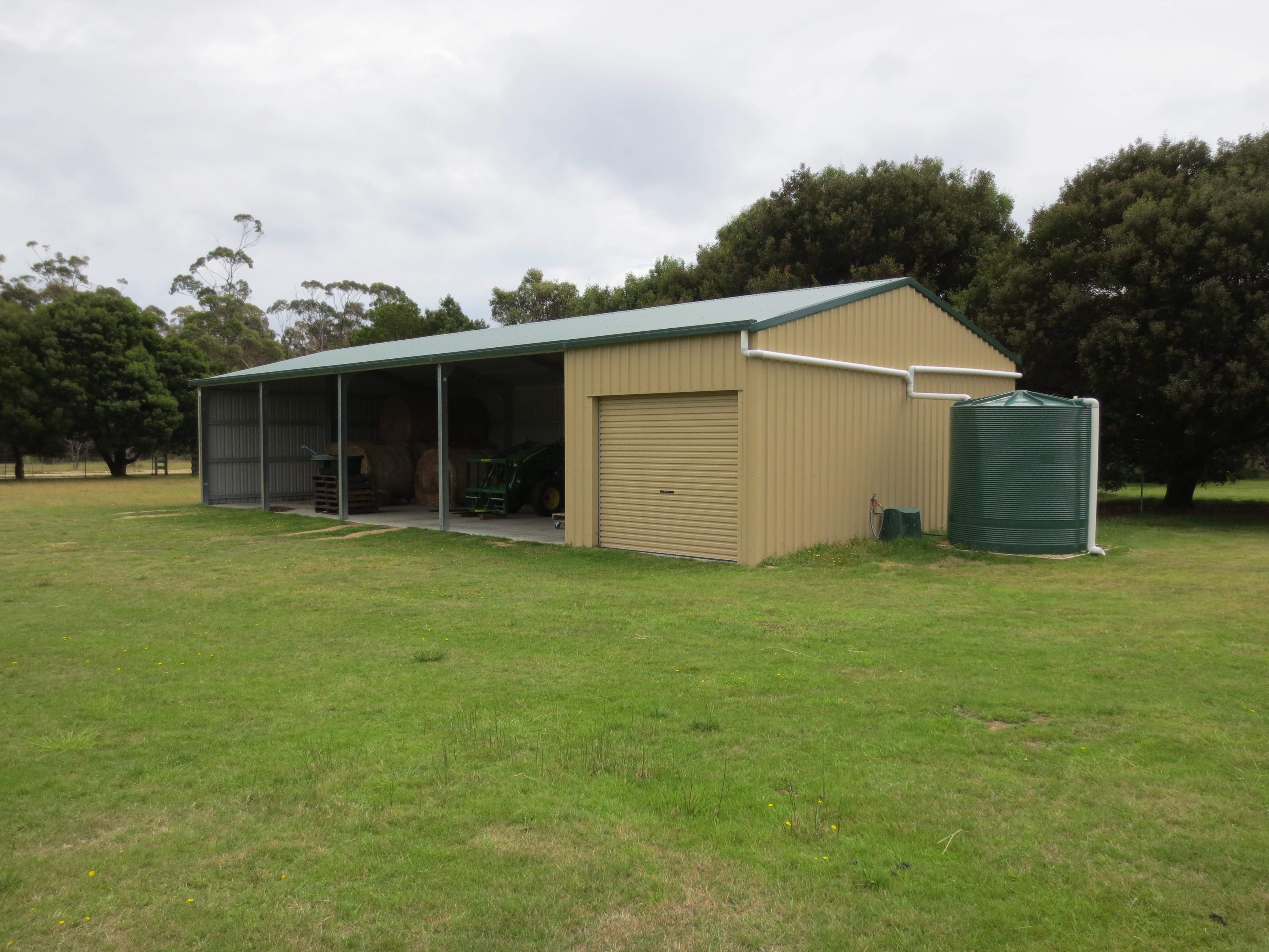

So what you want is a 'driving shed'. Closed in on three sides with a door of sorts on the access side. Farmers build them all the time. Can use them for firewood storage, too.
So that's what it's called. I've had a design in mind for something like this for several months. Just haven't had time (or cash) to actually build it.
Here's a somewhat smaller version I built several years ago. It has bays for four implements plus a small closed room with a toilet that's tightly closed and heated above freezing, so works great for storing seeds, garden chemicals, etc.
That looks great, Terry. The design I'm currently mulling over would be even smaller than that: just enough room on 3 ground level bays for the 3-point-hitch attachments we plan to get (might have to build a fourth, just in case) and two bays on top for the loader bucket and pallet forks. I'm haven't worked out all of the design details yet.

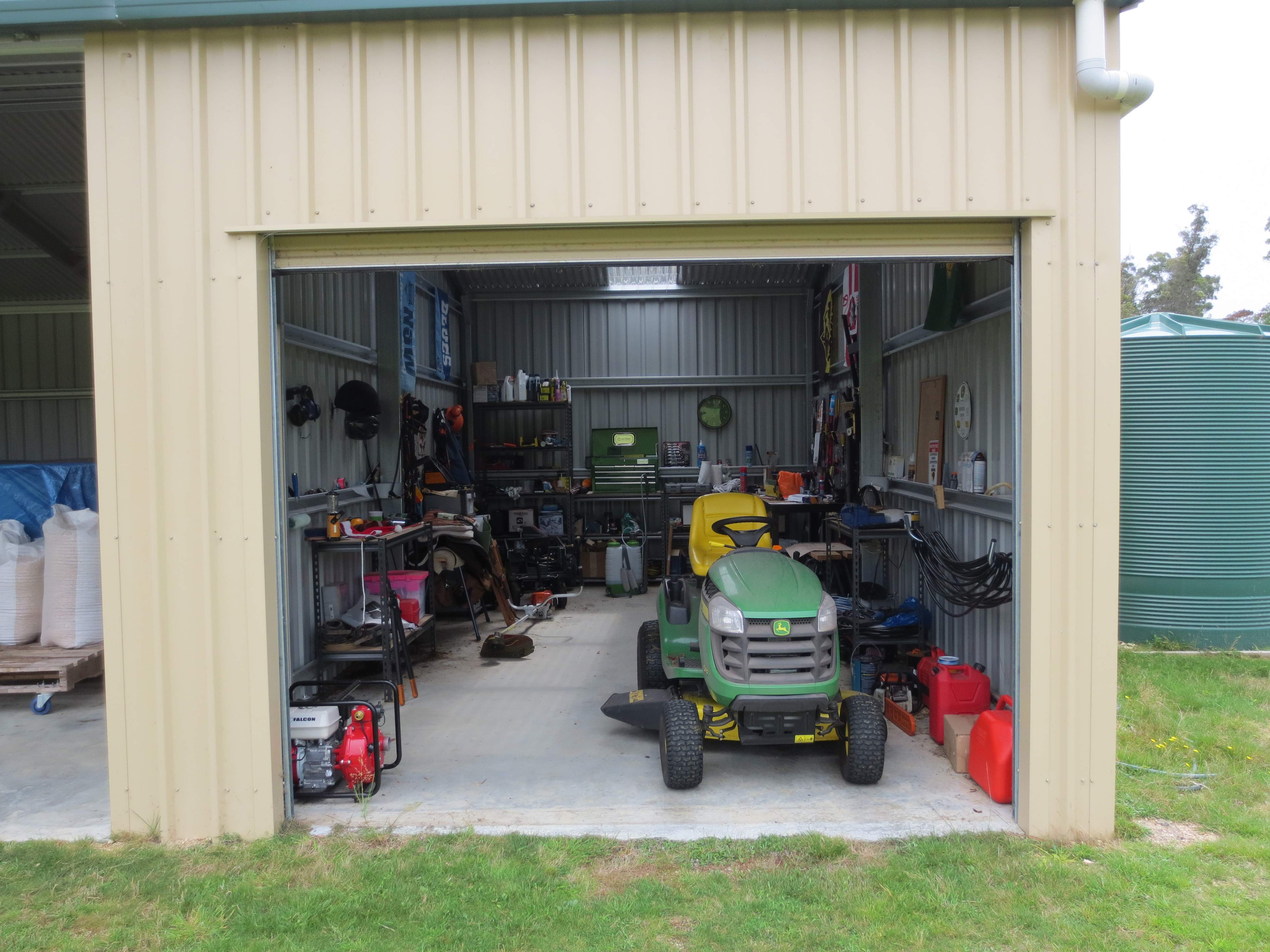

I built this a few years ago. ... The idea I liked with this new building is that it has total access from the front and although there is still always stuff in the way it seems, it is a much better solution then doors from one side or another.
Nice looking building! It sounds like your design is your own spin on the driving shed mentioned earlier in this thread. That seems to be a very popular approach.

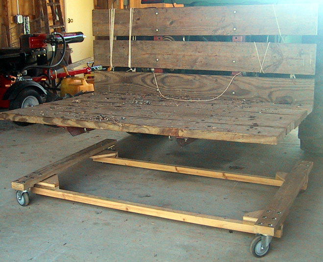

I like your design on the dollies, I have built dollies for mine, but I may steal your design, if I build some more.
Feel free. :)
Some learning from my designs:

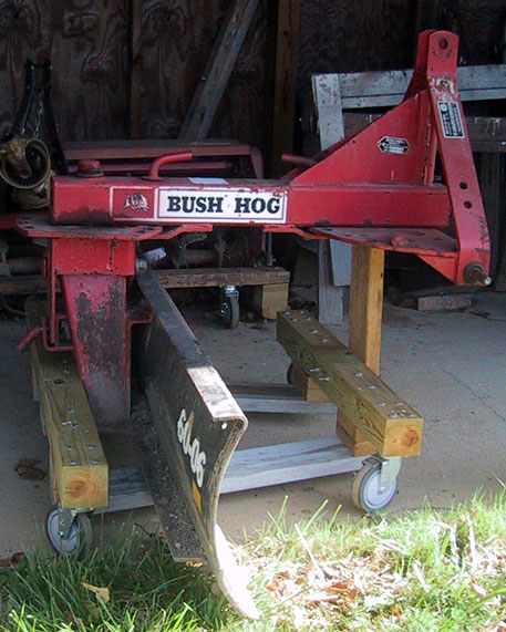

Here's another view of the one for the rear blade:
The upright to hold the blade up is much easier than using the supplied jack. But the blade doesn't lift high enough to clear it when driving off, so I have to scoot it off to the side after I attach the blade. Some way to fold down the upright would be great.
You can see the tiller behind the blade. Since it only gets used once a year, the dollies allow me to "stack" them one behind the other to save space - great. However the dolly for the tiller was under-engineered. The flat 2x4s are very old and very hard, and I figured as close as the casters are to the ends the would be adequate. Wrong. The quickly developed a noticeable upward bow so I've since added another 2x4 on edge to give them more support.
The one for the chipper works well as long as I center the chipper side-to-side when I put it away. If it's off to the side the rails on the bottom of the chipper bind the casters when they swivel. Some sort of guides to get it centered would probably help.
